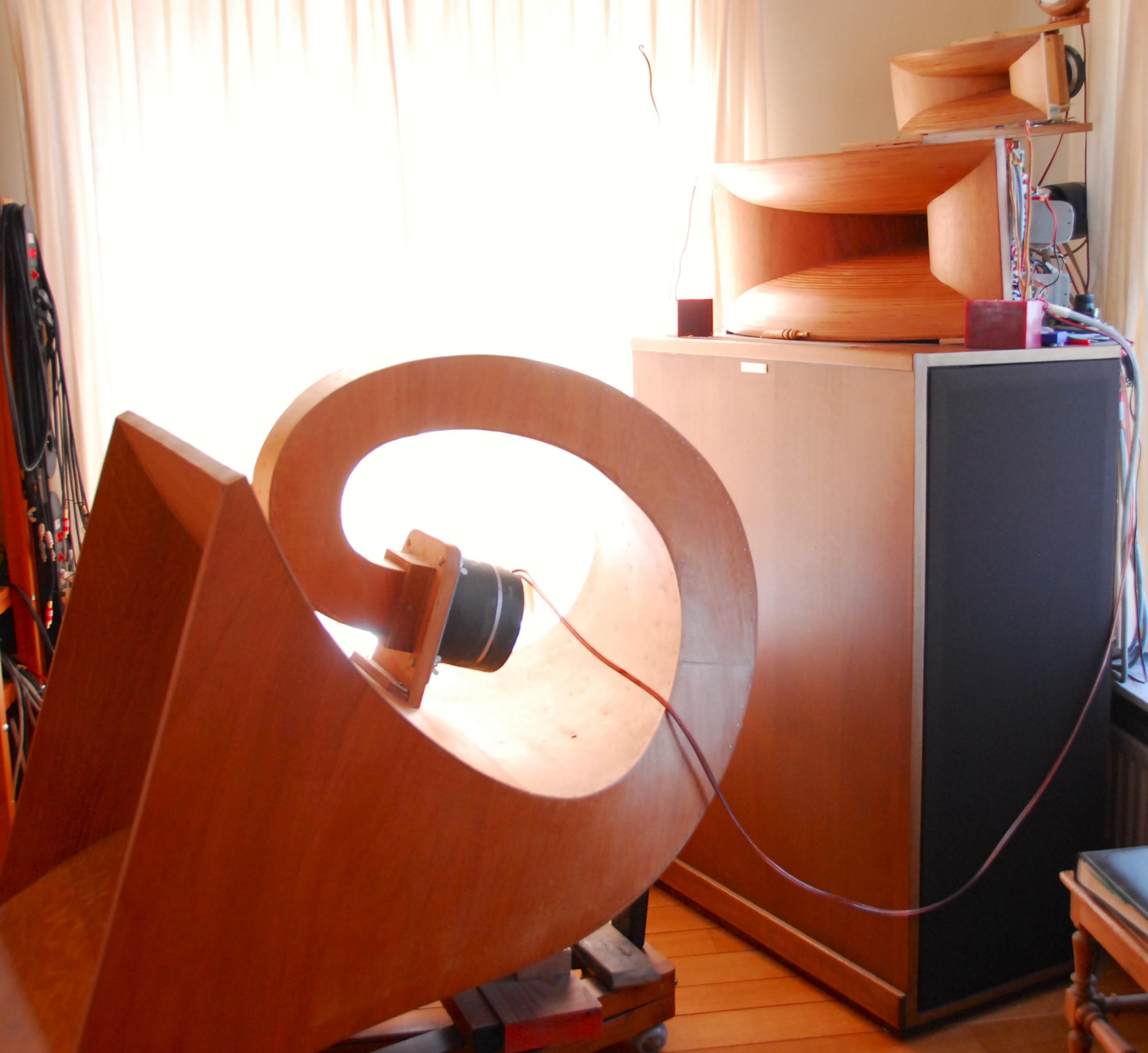

Some other DIM (full) 5-way horn concept:
(Low) EV Patrician IV (driver EVM18"), (low-mid) WE66A (driver JBL2482), (mid) Iwata 2" (driver Vitavox S2/S3), (high) Iwata 1" (driver DE250) , (high) Beyma
Electronics: 5-way Actif analog X-over & 2x5 Amplifier (analog Bjt)
With a WAF=10/10
... It's music ... I like it ...
Karel
