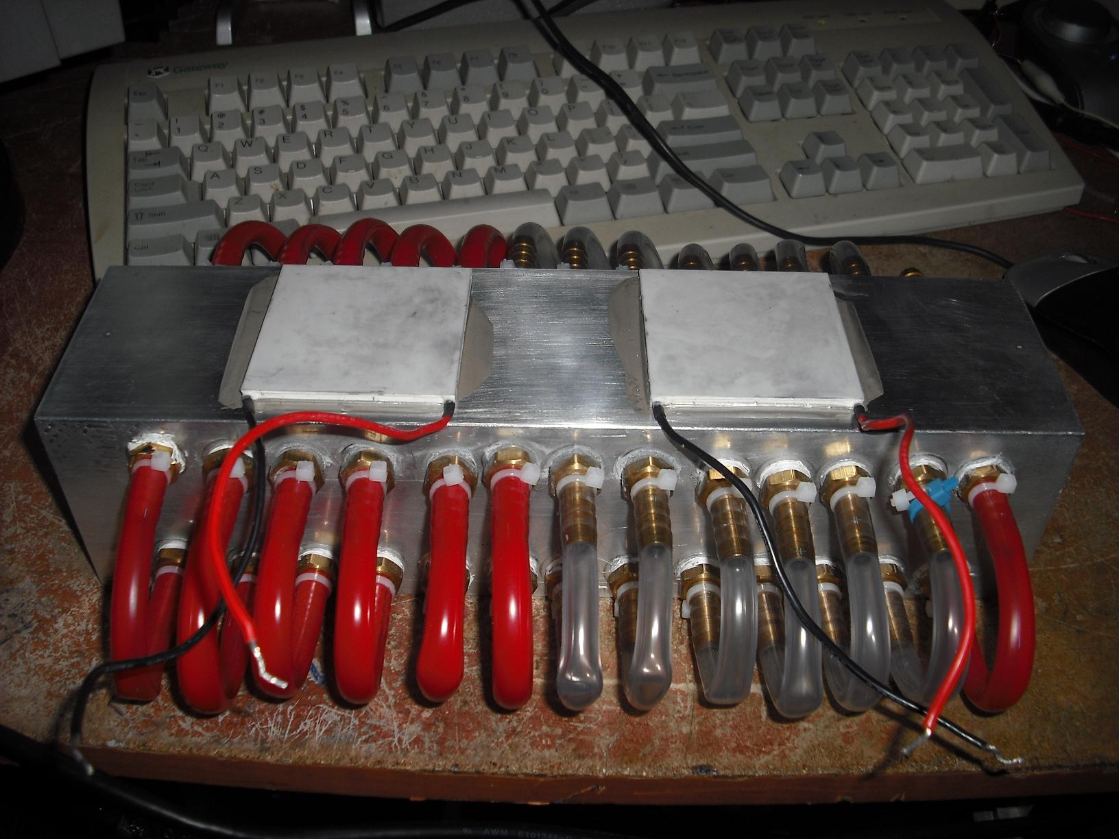

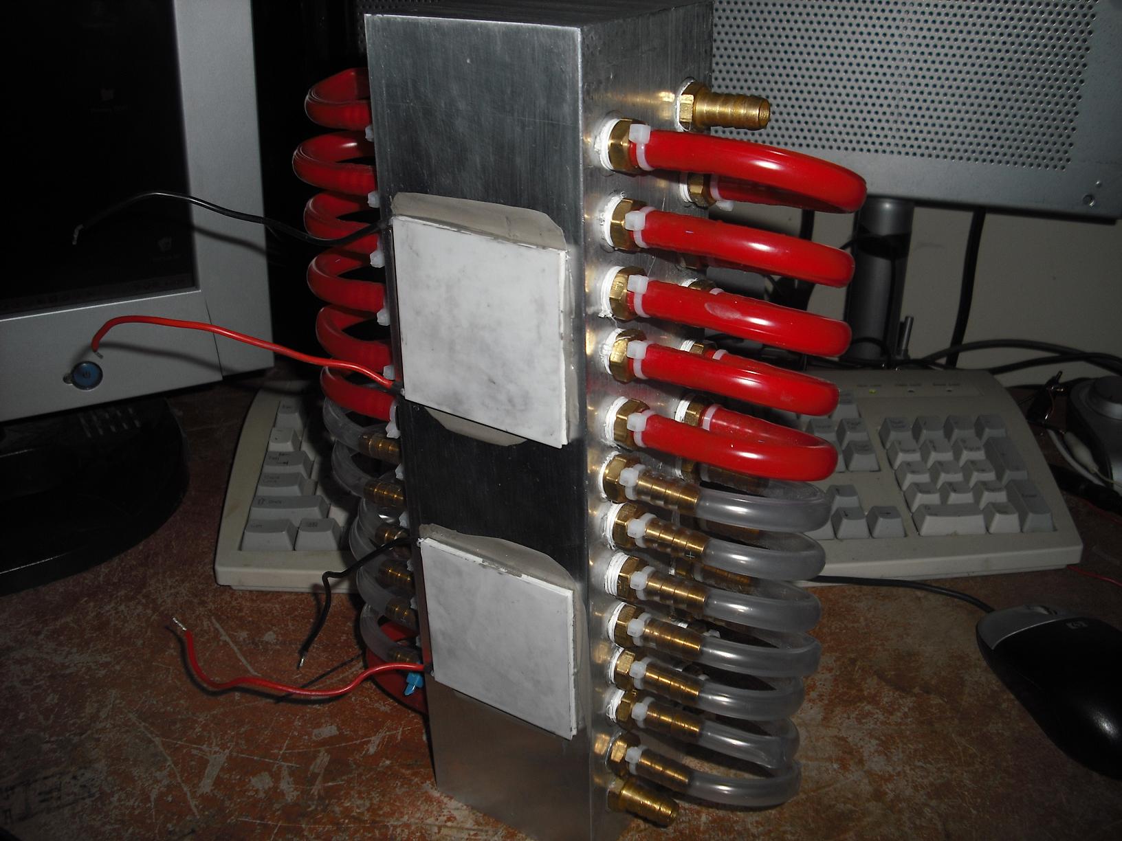

Haven't posted in a while, so I figured I'll post my progress on the water cooling block idea. I've attached two peltier devices, and they work remarkably well; haven't tested them with a load yet. The problem with these devices is even with one running at 5VDC it draws 6A, and at 10VDC about 11A, add the amp its cooling and now we're tripping breakers. I'll have to bring this contraption in the basement, wire the trafos up for 240VAC and let it rip. 8 degrees F at 5V, -5 degrees F at 10VDC.
I'm thinking a 5A Mini-Aleph @ 22V or possibly a very heavily biased F5.
These peltiers have a 545W rating, operate from 0-16 volts DC and 0-32 amps. The question I have, if anyone is familiar with these devices.....does the 545W rating mean that the device can handle 545W or does it mean that just by powering up the devices to full power, they consume 545W?
Juding from the simple math, if they draw a max of 16 V @ 32 amps, then that would equate to 512 watts--which is pretty close to the 545W rating you refer to. Just taking a guess, then, you are quoting a "power consumption" rating, rather than the cooling rating. Based on the efficiency of the peltier junction, I'd suspect your "cooling capacity" is significantly less.
Fun devices, peltier junctions. I've run VHF MOSFETS in a 144 MHZ power amp at SEVEN TIMES their rated (ambient temp) output, by using "stacked peltiers" (three levels), coupled to a room temp fan-cooled heat sink.

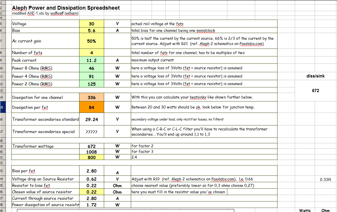

one "cool" Aleph
Back at it, Merry X-mas everyone!!
essentially an Aleph 3, but with 5.5A bias, and roughly 30V rails, 0.22R Source resistors. Simple (silly) question. Now I've read about setting AC current gain in the Aleph ad nauseum. Referencing R21 (Aleph 2 schematic), removing it, and measuring the AC value while the amplifier is outputting 10 watts....How do I measure the output wattage at any given moment, and do I need a signal generator that will provide some sort of constant arbitrary frequency? I've built plenty of alephs, mainly just blindly with others input, so I never did any real measurements, other than the basics.

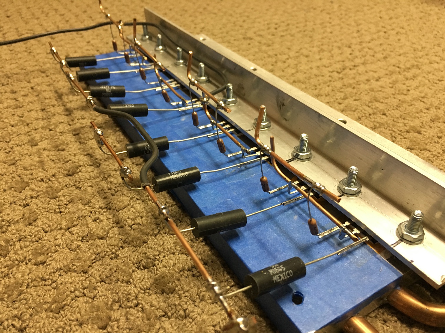

It got a little too hot!! Worked fine with 1000VA 30V, rails right at 30V. I then connected my big 1500VA 38V toroid, rails came out to 35V...current source gate resistors burned up followed quickly by the source pins on the fets, for both channels...almost simultaneously. My gate leads from the board to the fets was 18ga and about 8 inches, I think it was oscillating like crazy....sounded good for a few minutes. Next iteration will be a little more tame, 8 fets/channel, and slightly lower bias.
