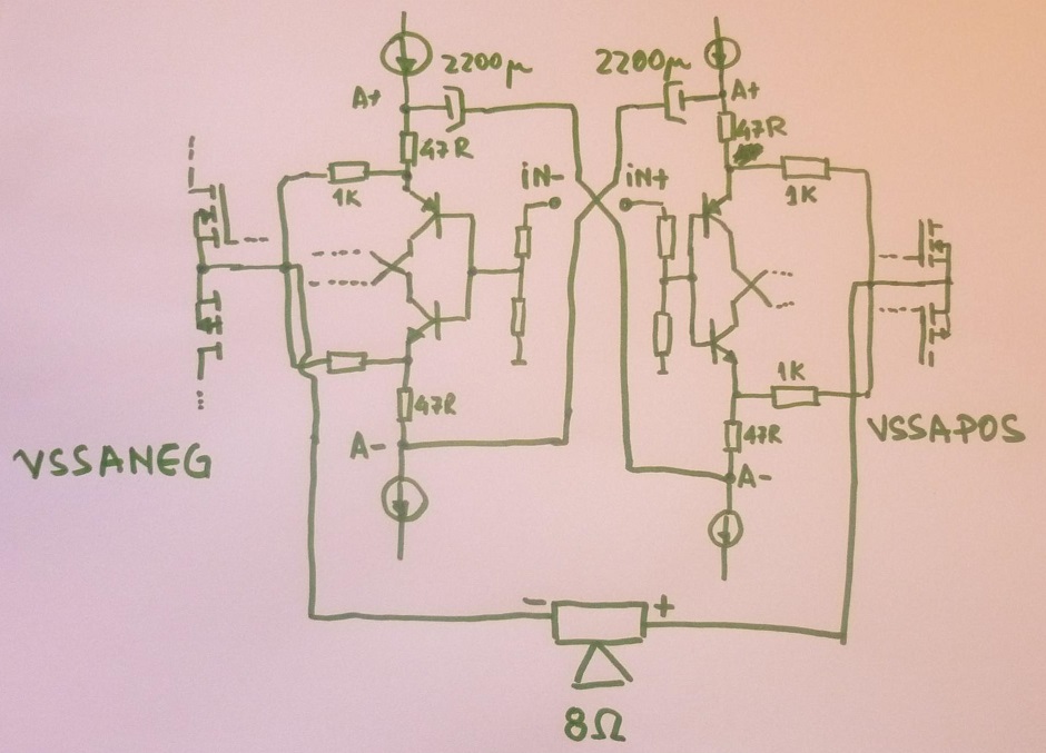

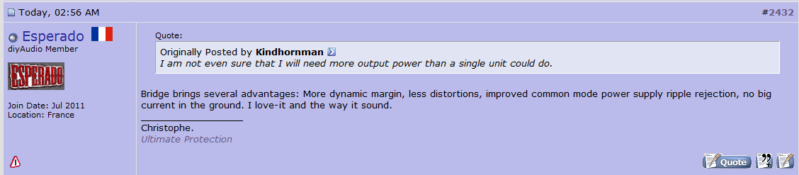

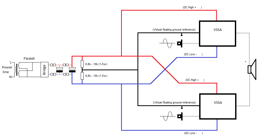

Hi Do, metallicus69 reference to post #1660. I attach here picture from that post where he makes virtuel ground in X for C2/3/4/5 between two modules. Also see my simplified schematic with more vituel ground for PSU, and last Christope's post #2432 explanation. Only drawback seems you need balanced pre signal and if not having one need to build a splitter with specs as good or better than your single ended pre.

Just wanted to let you know that this works :D
I used two VSSA modules. First calibrated them independently according to the instructions delivered. Then removed the C2 and C3 caps and mounted the ELCaps Nichicon KT (6800uF) according to the schematic in #1660.
No oscillations, no hum, no unwanted noise. Just wanted good nice sound :) Especially after bypassing the elcos with the film caps the sound was even more clear (almost night and day difference).

Bravo Radu, very nice experimental work. :up:
VSSA in full balanced version hehe, perfectly, even more if the rest of the system is balanced. :cool:
I very much like your findings that parallel film cap across elco is an improvement, for the same reason I provided both 10 uF in VSSA. I also found out that this cap should have non resonant high-Q dielectric material, like film caps are. ;)
Just please have in mind output current limitation, but as I see what are you're doing I am sure we can trust you by that. :)
Enjoy your work. :cheers:

As soon as I received the previous batch of 4 boards I started to arrange them and I noticed the perspective of testing this arrangement. If you put two boards aside with the inputs in close proximity, as you can see from my pictures, everything comes in naturally, without too many artifacts in the build. Taking into account that every amp has an input resistive load, you don't even need to get the balanced GND input wire to the boards, as the arrangement creates an input virtual GND.
Honestly, I think the best win for the balanced VSSA is for 8 OHM loads. If Andrej tested that one channel works for 4 OHM up to +/- 45V, then the balanced one will work as well into 8 OHMS, in the same conditions. Well, I can see that only one MOS can handle 8A of current, so probably the best top working voltage would be around +/-37-38V, but if you use this amp in home conditions, and your supply rails may fail under load a few volts, we must be probably safe even with higher voltages, especially with lower power transformer.
If you intend to go on 4 OHMS, or even lower, you should consider how one amp can cope with your load divided by two. So for 4 OHM, the load is actually 2 OHMS for one VSSA; that means Vmax to be +/-21-22V, considering Imax=8A and 5V drop over MOSFETs. So if you only want to hunt higher power, it does not make much sense; however, balanced at much lower voltage, might still raise your interest, as the price for capacitors is much better in 25V range; it's up to you what you might like. if load is lower than 4 ohms, I don't think you can get anywhere with balanced VSSA using Andrej's boards; they are specified for a minimum of +/-20V. I am sorry if I ruined some dreams, but let's be realistic. 8 Amps are 8 AMPS. Please think well if this arrangement is worthy or not for your case, before investing in additional hardware or pushing existing one above the limits!
In my case this arrangement is perfect; I use 8 OHM wide range speakers, without separation filters, meaning not too many non-linearities in the impedance; using an equalizer that takes extremities 17-18dB higher than the middle range, I need better reserve of power, but not continuously.

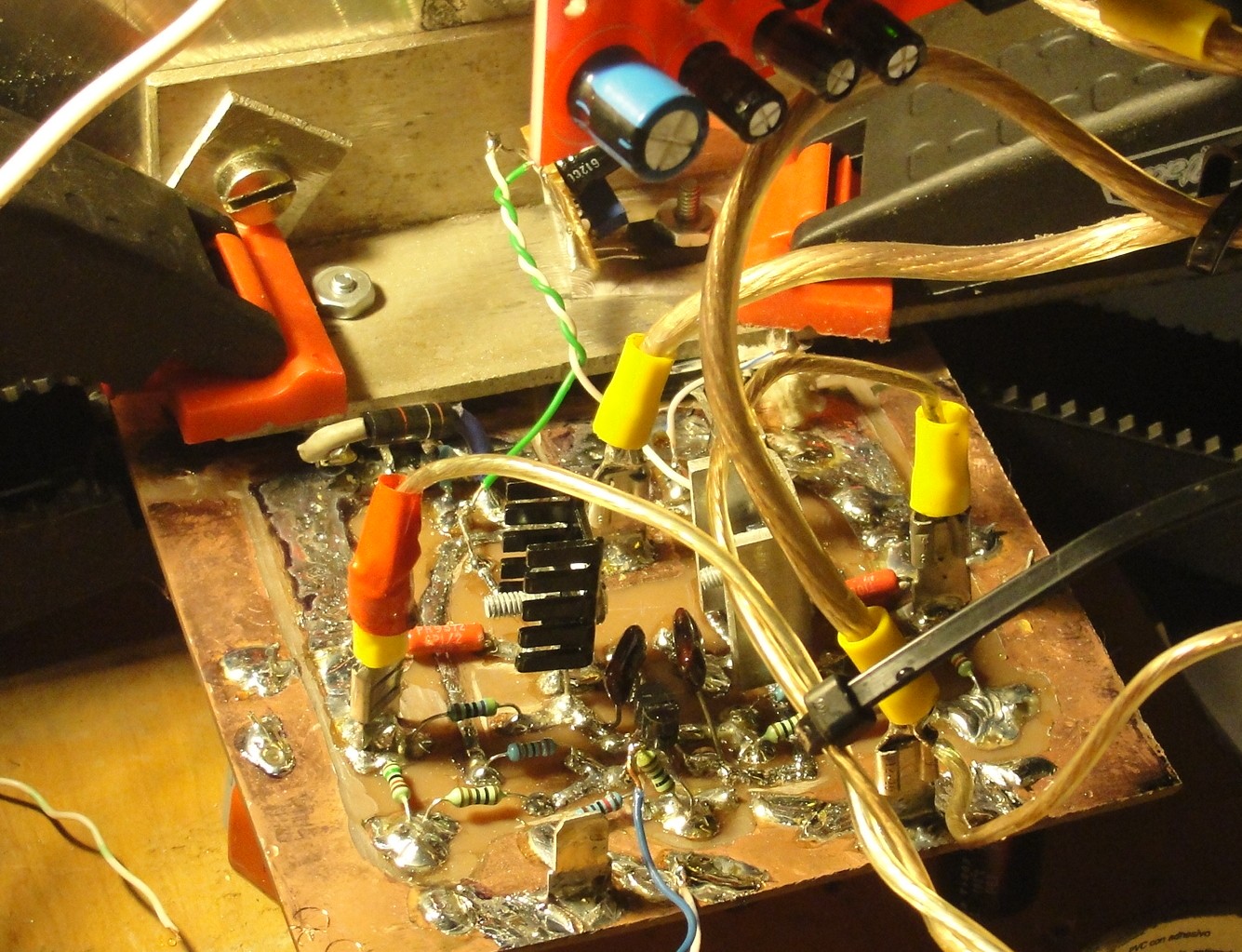

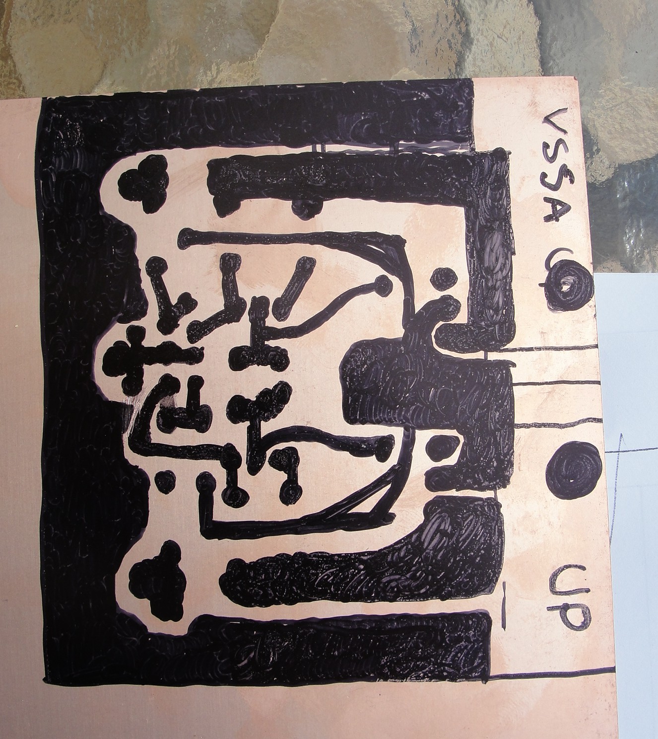

Anyway, as I got frustrated after failure to correctly bias the VSSA-DIY (I suspect my 2SJ162) and while I wait for new MOSFET to arrive, I decided to adapt the VSSA to a BJT output, with the simple cap. multiplier used for the SSA-BJT and 39pF caps between b and c of the VAS transistors, just in case. Miraculously, it worked at first attempt and with reasonable numbers and excellent sound.
DC offset was 27mV, cold (without 1M trimmers) and raised to 65mV when playing; current for the VAS was 13mA on cold and raised to 16,5mV when hot; total bias was around 160mA cold...now I have to make a star ground and add some Russian film caps to the rails.
Thanks again to the generous and not so lazy LazyCat.
There goes a picture of the VSSA DIY (in positive) and then a second one of the board adapted to BJT.

You're too kind...I am only an amateur trying to figure out how the H*** do amps work. I guess I still have begginers luck from time to time. :D
Oh! I didn't add Zobel network but I could add it underneath if something strange happens...the neighbors you know...
