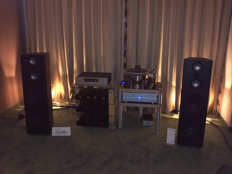

This weekend First One amp played in a Gallus audio room at Hi-Files show in Belgrade.
As I read some comments, visitors were quite positive about the sound of the system.
