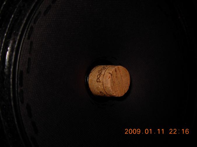

Hi Vix,
Do make sure that the T-bass circuit is connected directly to the amplifier, and not after a crossover section. T-bass needs very low impedance drive.
So how does the cork sound compared to other phase plugs.
Possibly a little less strident ?
My impressions is that the cork needs to be sanded for a rounded or asymmetrical leading edge. There is a symmetrical central launch plane about 1" in diameter which could introduce a diffraction notch and peak at higher frequencies.

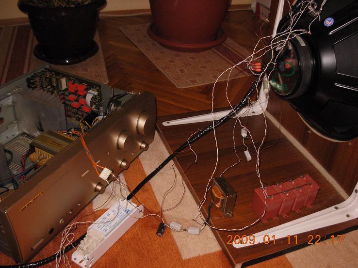

Hi Graham,
Once again, thank you very much for the T-bass!
Yes, it is connected directly after the amplifier (OK, not immediately, but via thick cables) , and then comes an inductor (for 1-st order low pass) and a boucherot.
Cork phase plug does not sound bad, but there is still some slight fuzziness to the sound. I may get more such plugs and try to shape them and see what happens.
Vix

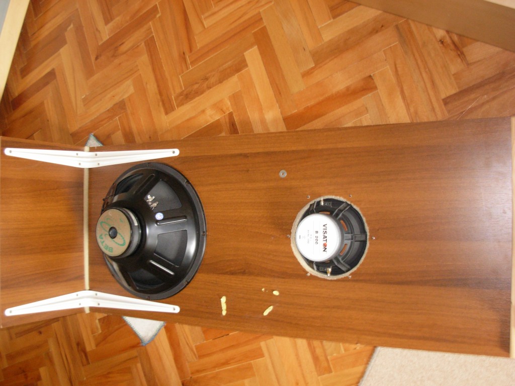

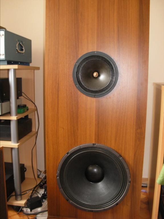

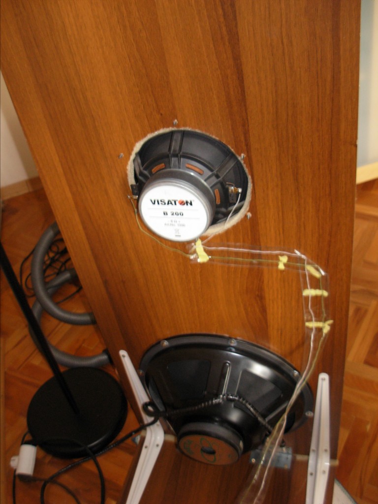

As you could probably read, I had also started an OB design based on Visaton design. My initial ideas was " just to change the BGS for Eminence" but it didn't work as expected. In the meantime, bit by bit, it changed so much that the only common thing with that design is the fullrange driver itself, Visaton B200.
To summarize, the basic baffle remained the same. No side wings meant a metal "L" support was added, and it also meant a completely different crossover. I am using a DIY active crossover. After a lot of experimentation, I had settled for those crossover points:
1. Visaton B200: 350 Hz high-pass, 2nd order, Q=0.5
2. Eminence Beta 15: 80 Hz low pass, 2nd order Q=0.5
had later added a passive T-bass circuit between bass amplifier and Eminence driver:
http://www.diyaudio.com/forums/full-range/130679-t-bass-drive-ob-lf-drivers.html
So, in the configuration you have, I wholeheartedly recommend you not to waste your time with passive crossovers. Get one more amplifier and an active crossover. Either build it, or buy something like Behringer or if you can afford, purchase Nelson Pass B5 crossover circuit, made specifically for open baffles.
Edit:
p.s. Visaton B200 is modified with dustcap cut and phase-plugs installed. If your driver is not modified, you may find that you need a notch circuit, either active, like here:
http://www.diyaudio.com/forums/full-range/99662-visaton-b200-taming-shout.html
Or passively with 0.6-1 mH inductor in parrallel with 6-15 ohm resistor (adjust to taste).

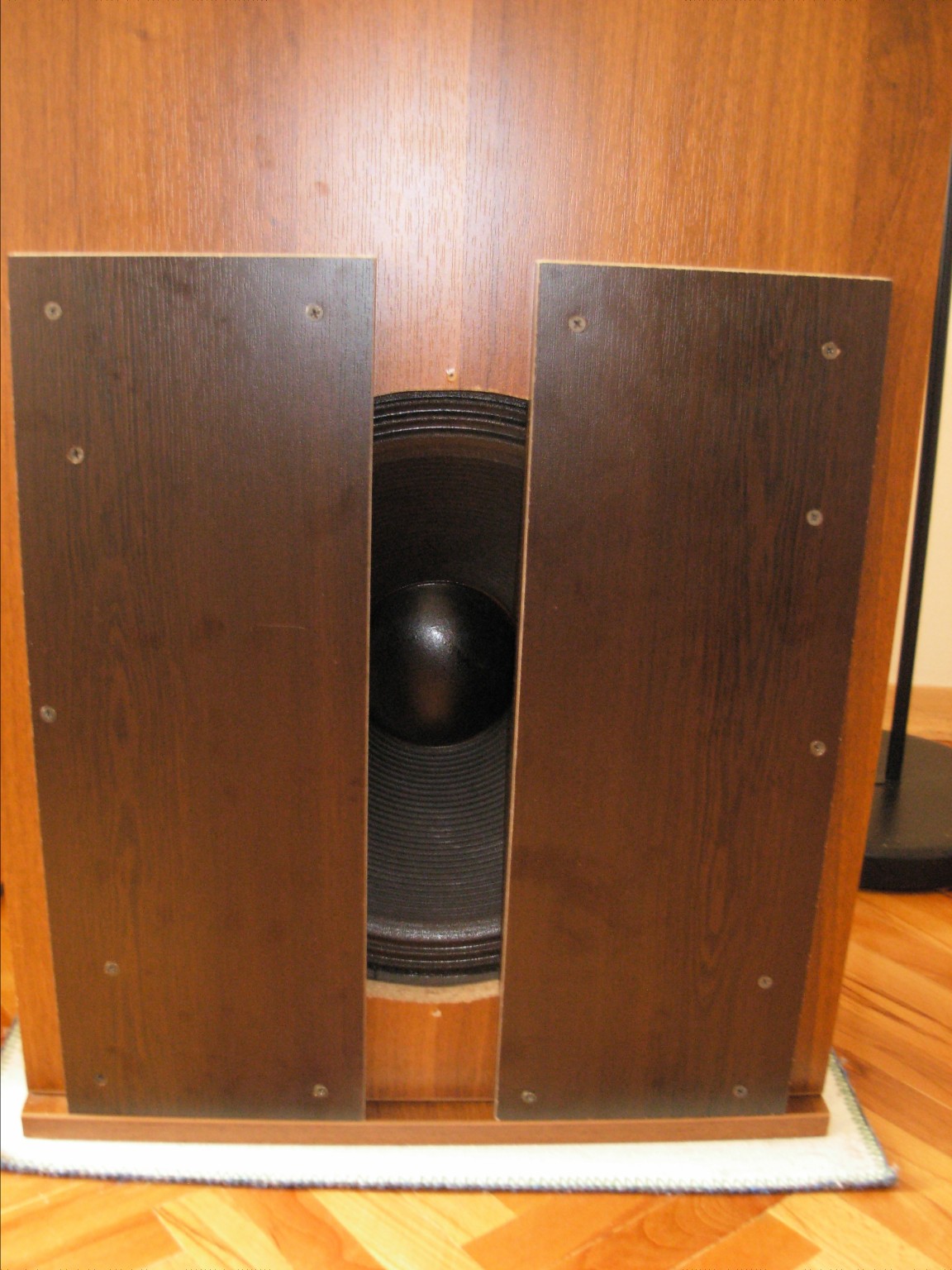

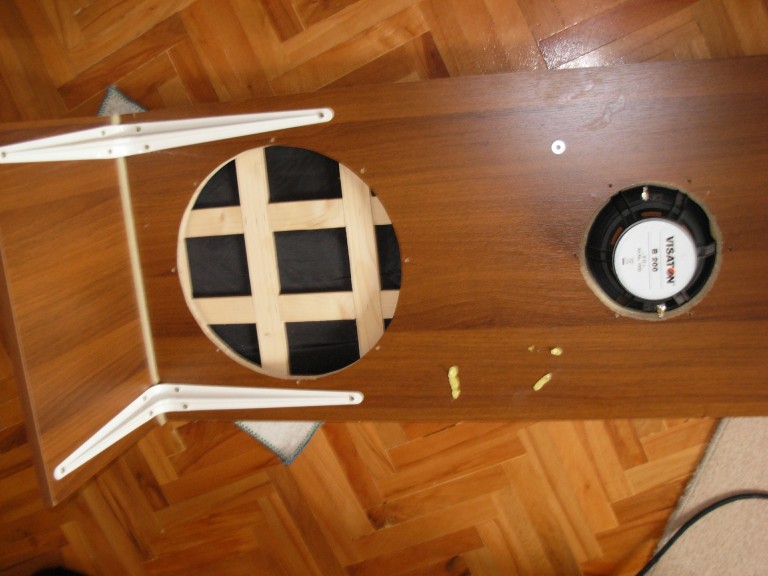

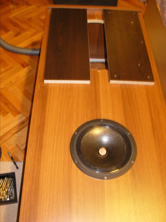

So, the latest thing I tried was to make a 'quick and dirty' version of "Slot Loaded Open Baffle" something which is about exploring the effects that Nelson Pass described here:
The Slot Loaded Open Baffle Project Article By Nelson Pass

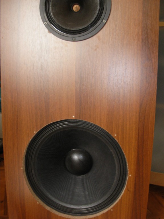

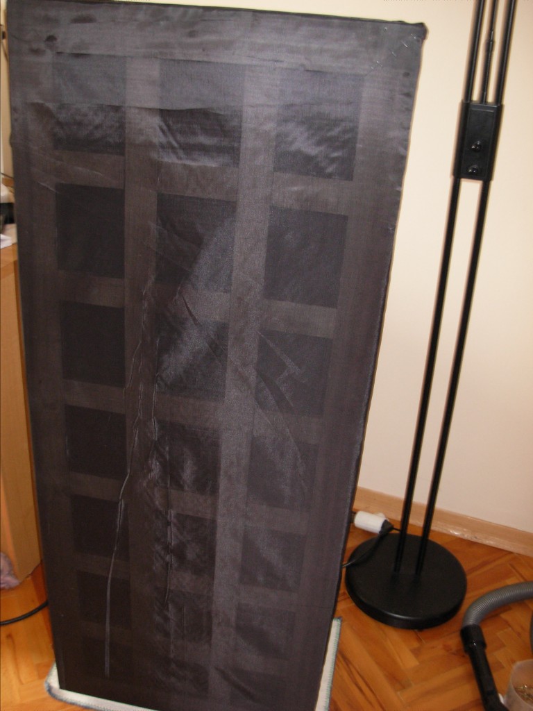

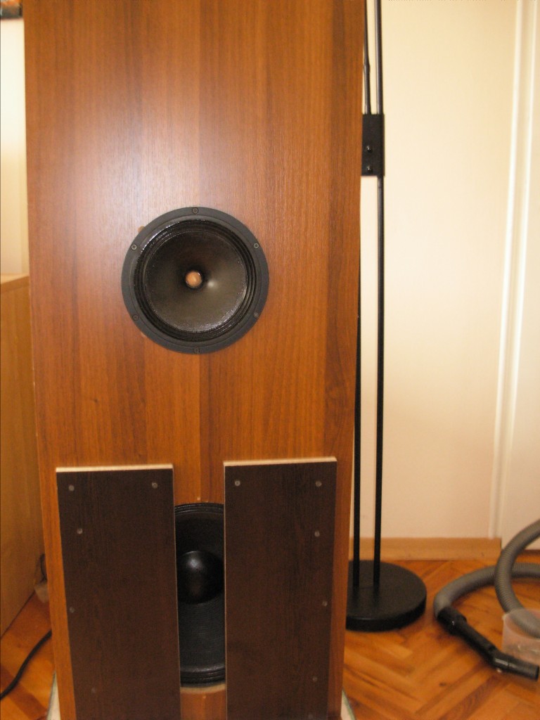

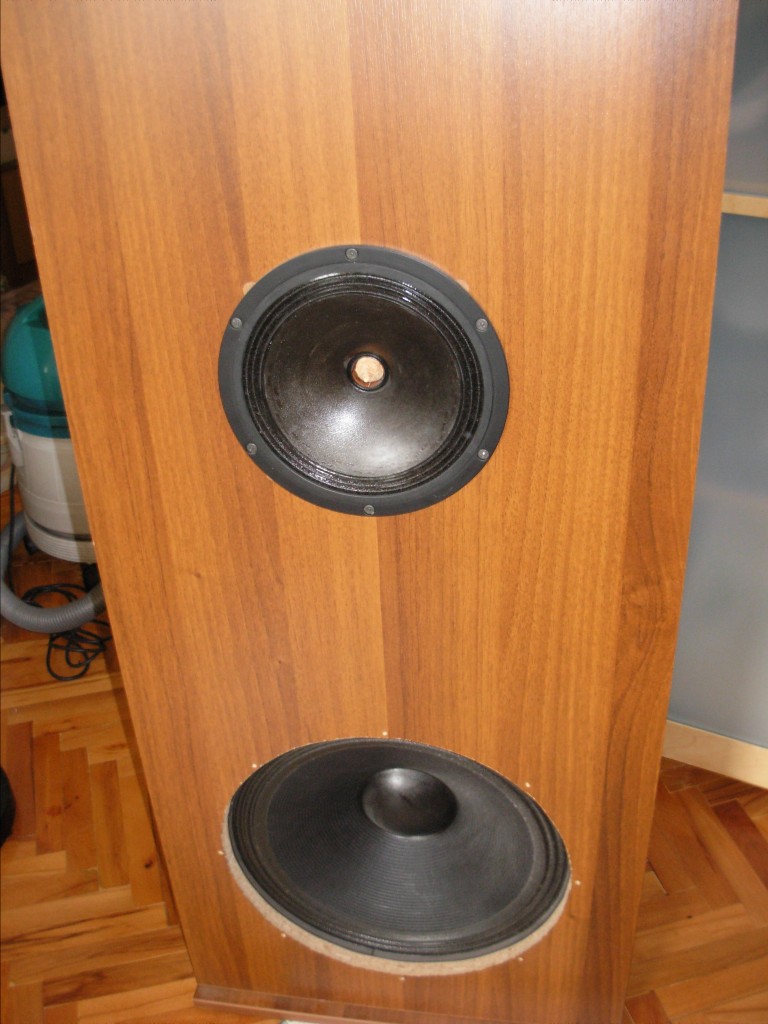

Since it's quite late over here, I can't play them loud, so more about impressions tomorrow. Since the baffles are as ugly as they can get, I will not post the pics in the OB gallery. For the ones who want to see the mess I made today, here they are:
