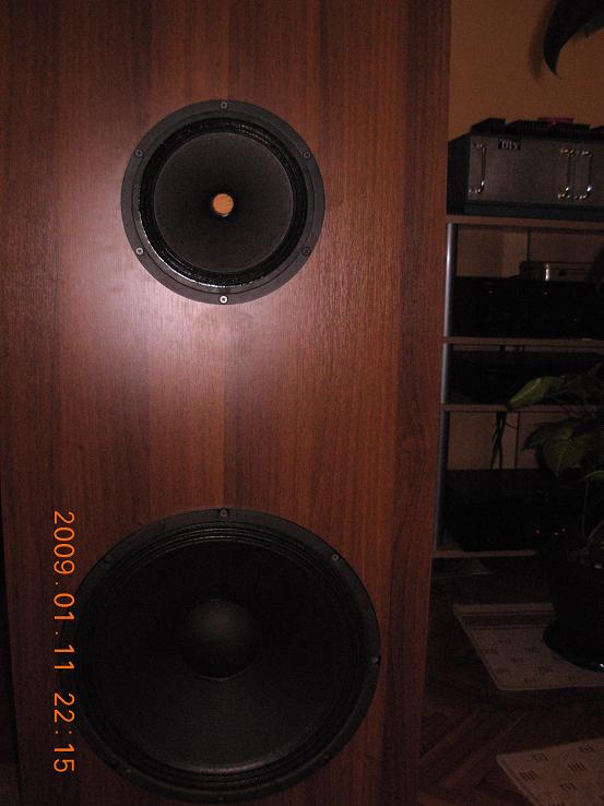

Since I've built them, I haven't stopped playing with my OB's.
1.I removed the side wings.
The result: Without side wings, it sound much more open and relaxing. A side wing covering a midrange driver (Visaton B200) is a no no. Of course, bass is weaker, but the overall sound is more pleasing. Eventually, I may try some small "short" wings, covering just the woofer, but not any higher.
2.Visaton B200 got its dust cup cuttted off, and I installed a "mock up" phase plug (you'll laugh at this, I put a candle instead). This definitely improved the sound of Visation, but it still needed some notch filtering. I installed a 0.68 mH inductror in paralel with 7 ohm resistor ( value obratined by parallel connection of several various values), so now it sounds very balanced.
3.Crossover. So far, what works best is a 100 hz/12 db Linkwitz Riley alignment, both HP and LP. (Thank you Nelson for the tip!)
Just yesterday I tried 200 Hz/18 dB for a low pass and 200 Hz/6db for a high pass, but it didn't combine very well. It sounded somewhat muddy, there was plenty of bass, but there was a lack of definition and the drums sounded as they were all over the place. I guess it has to do with the phase variations/anomalities. So I went back to the 100 Hz/ 12db oct setting and I am convinced that this is the value that works best here.
What next? I need to improve a buffer circuit that I used in the active crossovers. Neson Pass will pulish the buffer circuit so I hope to utilize that one....
Even though Open baffles turned out to be a tough lesson, they will stay...

Never stopped playin'...and tweaking...
I was playing with the crossover, trying different settings, listening to that for a few weeks, then changing again...
What works now is: Visaton B200 run fullrange, with the active notch filter (sandwiched between two Firstwatt B1 buffers).
Eminence Beta 15 LP-ed at 45 Hz, 12/db oct.
Some of you may argue that it is not a good idea to run Visaton fullrange, but, at "normal" listening volumes it sounds better, more coherent and more musical. At high volumes, excursion gets unpleasant, but most of the times I don't listen very loud, so I care not.
Eminence Beta 15 just adds a bit of missing bottom end.
Future thoughts: A Step backwards: BOX!
Since my listening room is not big (12x12 feet approx), and due to domestic considerations the baffles are fairly close to the wall (2 feet), I thought about building a sealed box for the Betas, and leave Visatons "open air". Something similar to BassZilla concept...
Vix

Shot in the dark
A friend of mine gave me a broken Marantz amp. PM -68. It was destined for a trash bin, so...I opened it, and while the main amp part was blown and missing, the rest was there..so...hmm..
I tried it, the preamp section and the main transformer were Ok...
So what...
I made a mess in the living room today. Spaghetti....
I decided to use that transformer to quickly assemble Graham's T-bass circuit. (I have tried it before , but with inappropriate transformer, so ther result was not pretty) Now that I could do it properly..why not...
Surprise! With the T-bass circuit in place, I run a first-order passive crossover. Had to pad-down Visaton B200 to bring it in balance.
I found the sound very enjoyable and musical. I have traded-off some efficiency, but since I don't listen loud, it doesn't matter.
So, it seems that I 'll be buying two new transformers and build this circuit ( I have tried only one channel now)...
p.s. Have a look at the cork phase-plugs...
