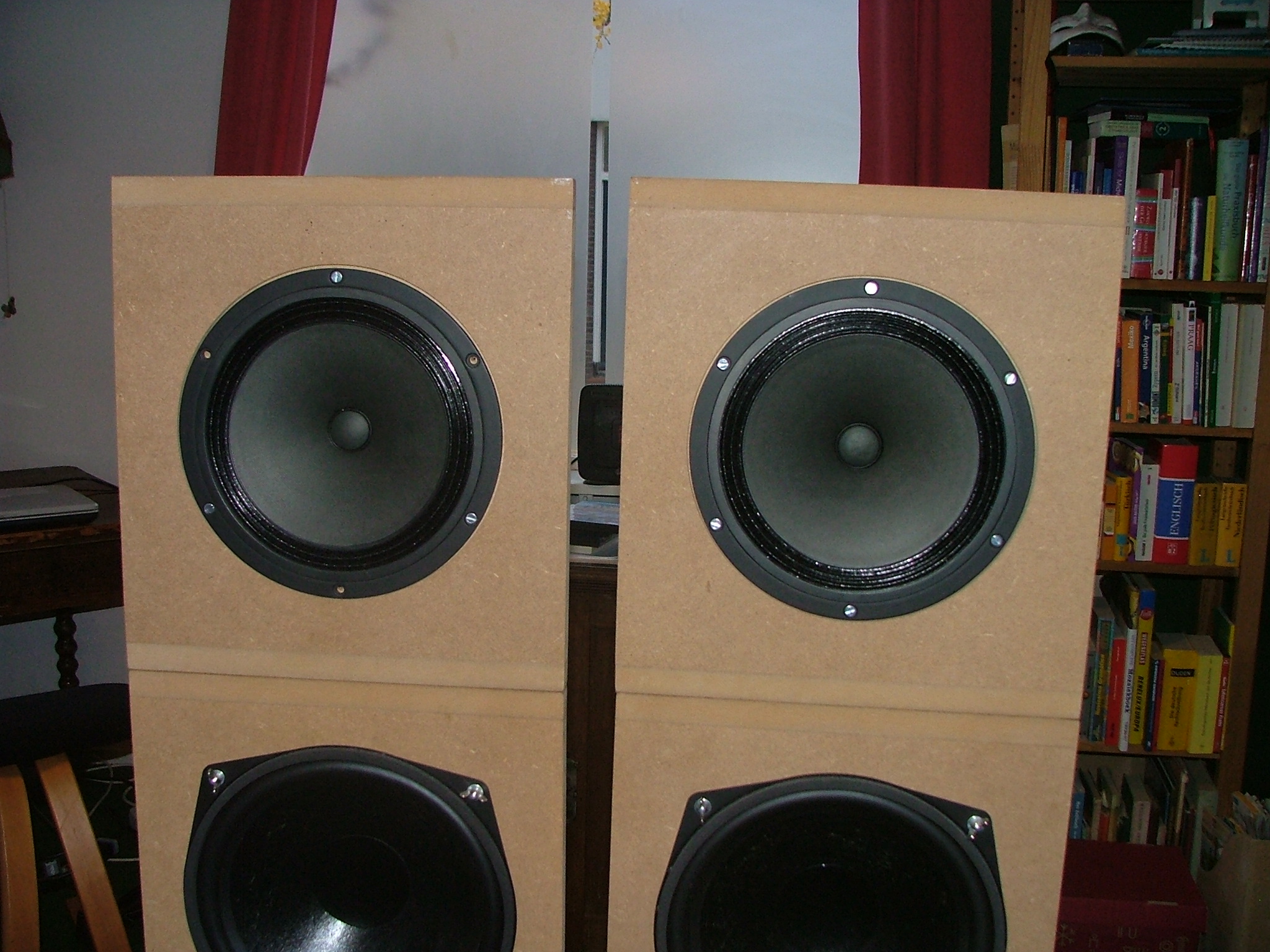

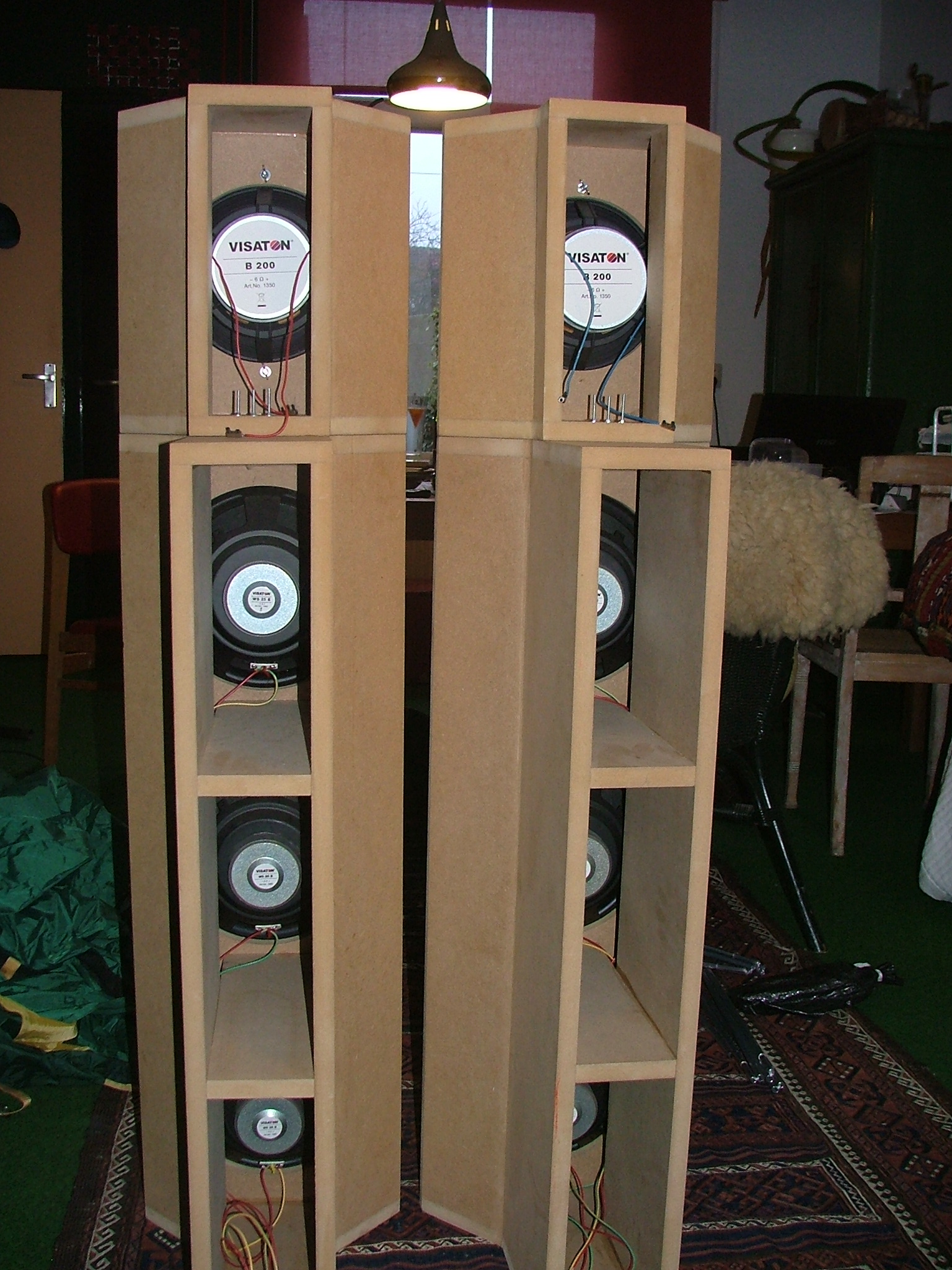

have been LOVING my B200/Alpha 15A combo for years
Recently bought Erik de Best's Klang und Tone dipoles (2007/2)
http://www.lautsprechershop.de/inde...rechershop.de/hifi/audio_circle_dipole_en.htm
And with the subs on it sounds lovely sometimes amazing (plate amp <120Hz with the b200's playing without filter)
The b200 on their own it sound poor. I think the enclosures are hurting the performance of the b200 big time. Also need to do the phase plug mod.
Actually if I turn the sub-array around I will have something of a slot loaded arrangement? Hopefully will be able to experiment a little this weekend.
