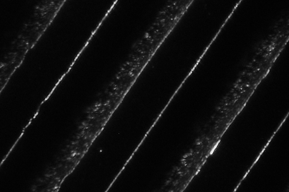

Here's one of my own optical micrographs which is lit and contrasted to view the grainy surface of one vinyl wall. This was always a particularly noisy example I should say, so somewhat exaggerates......nevertheless the grain structure of the wall is just about visible with optical microscopes for normal records. Note the random nature of the grain.
