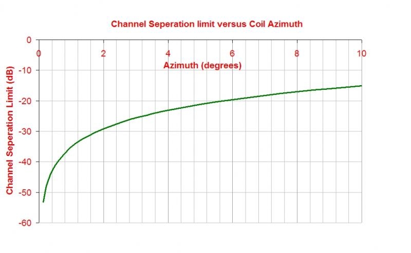

The best way to set stylus azimuth is to measure friction, eg as per the Pardee paper in the OP. Most of the audible effects arising from incorrect stylus azimuth, including mistracking, are due to variation of friction with exact alignment of the stylus. The only exception is channel separation, which is determined by coil azimuth alignment. Everything else is influenced by friction, which varies with the exact angle presented by the stylus to the groove. The finer the contact radius, the more sensitive to exact alignment.
Same is true of VTA, and also zenith (cartridge tracking angle).
There is also a noise minima at optimal azimuth and VTA, and zenith, this is the best method for setting them, IMO.
Setting azimuth for optimal channel separation aligns the coils, but not necessarily the stylus. If the stylus is not set accurately in the cantilever, as can often be the case IME, best overall results might not arise from most of the accepted methods which align coils...............
Skate force compensation is just a hopeless cause. See Barlow's footnote in the Pardee paper, how measurement of even steady state or average friction can vary over the surface of the record by a factor of 3..........furthermore friction varies from moment to moment in a flicker law, perhaps by a factor of +/- 4 from moment to moment - see my earlier posts on this thread.
Then applying a constant antiskate force doesn't do much good in the grand scheme of things. It's just surrogate VTF, so might as well press up VTF by 10% and omit the antiskate mechanism IMO. Less things to rattle around.......
That will set coil azimuth. See my post immediately above for why this might not be overall optimal..........I've done that measuring x-talk L>R and R>L and phase delta, and setting az to where they are the same. See attached, I would set it at + 0.5 degr.

You mean not optimal for things like distortion? Setting the az to where xtalk in both directions is equal does implicitly assume that the tip is aligned perfectly wrt the coils, isn't it? That may not be a correct assumption.
Jan
Yes. Near perfect axis alignment of the stylus is not typically a safe assumption, and indeed varies widely IME. It does seem to be one of those aspects which correlates with price, unfortunately....... Friction is the factor behind the general 'fussiness' of fine contact radius stylus as to alignment versus performance in the broadest sense.You mean not optimal for things like distortion? Setting the az to where xtalk in both directions is equal does implicitly assume that the tip is aligned perfectly wrt the coils, isn't it? That may not be a correct assumption.
Here's another blast from the past: attached is an old plot of mine from a few years back of how coil azimuth affects channel separation in principle. You can see that setting for the optimal separation is very critical, and results in a very specific setting for the coils. This setting might not be optimal for the stylus axis, if it isn't set near perfectly in the cantilever.
Whereas, if one say compromises channel separation to a limit of say 20dB or lower, a much broader range of stylus axis alignment is permitted. And there may be friction related performance gains which more than offset the compromise in separation..........
