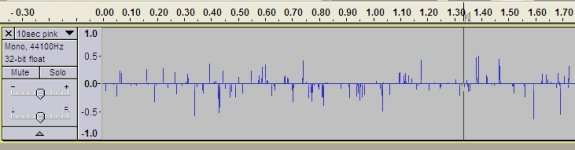

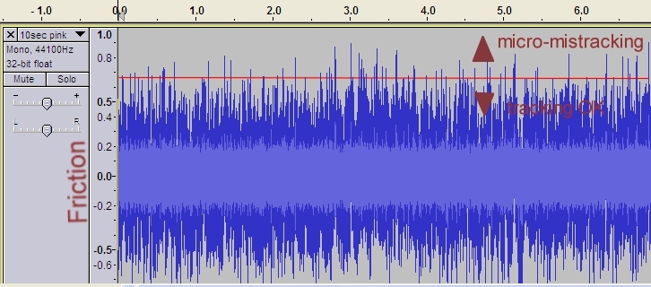

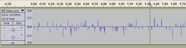

Here's some detail on the relationship between friction and crackle-pop noise.
The first attachment below is not from vinyl playback, but nicely shows how measured friction between a stylus and a surface varies randomly with time. There is an average friction level (1) and noise variation resulting in peaks and troughs (2) which are prominent at very low repetition rates, following a 1/f energy law (flicker noise).
Random variation in friction force means random variation in stylus upforce, acting against VTF to lift the stylus, there being a vertical component to applied friction forces (reaction) because of involved angles. It also means random variation in skate force, which acts to make the headshell move inward, applied tonearm reaction force is applied at tracking offset angle (c 22 deg).
The second attachment shows synthesised pink noise (1/f), representing variation in stylus-groove friction force. It also shows a threshold, arbitrarily, at -5dB representing the force at which VTF is overcome and the stylus loses contact with one of the groove walls. This is micro-mistracking, very short term loss of contact between stylus and at least one of the groove walls.
The third attachment shows simulated cartridge output arising from micro-mistracking when the friction force momentarily randomly exceeds the threshold set out in the example above. You can see it has the appearance of random pops and crackles, and an audio file of these events sounds exactly like the familiar crackle-pop of vinyl surface noise.
So friction force, especially random variations in it, often plays a dominant role in crackle-pop surface noise. Methods which reduce friction reduce surface noise, and vica versa.
