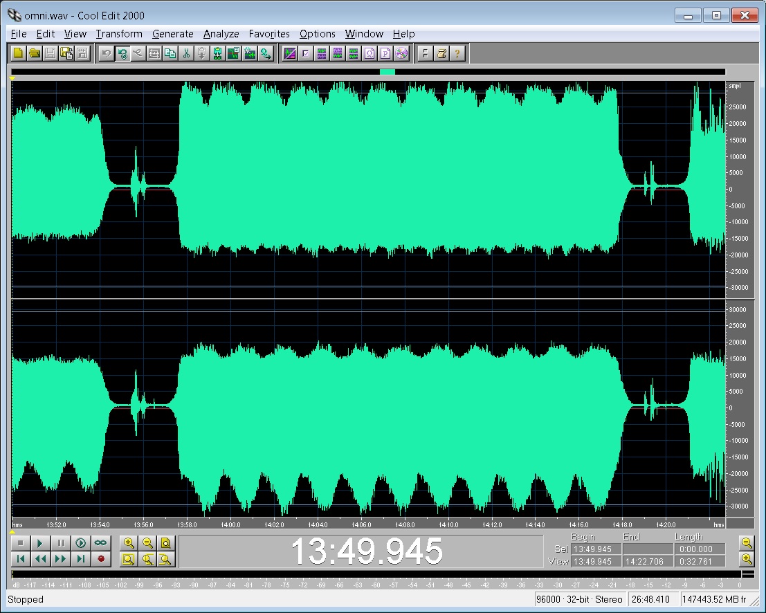

This might amuse you. This is 1/3 octave noise at 12kHz modulated by rotational artifacts. The surface crackle on a silent groove is also modulated. This TT has a spindle diameter well out of RIAA specs requiring careful centering of each LP, time for a sleeve shim.
