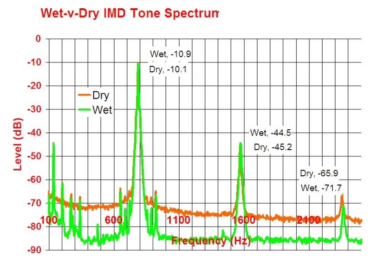

Here's a few measurements which nicely show some benefits of reducing friction. They date from my experiments with water as a lubricant, which sparked my interest in the whole opportunity that reduced friction can offer to vinyl playback. It can be profound, IME.
First is a plot of IMD spectrum, for dry and wet playback of the same test record. It not only demonstrates no change to IMD performance, if anything a small improvement for wet playback, but very nicely demonstrates profound improvement to noise floor.

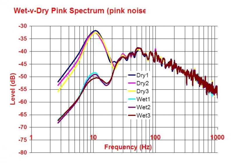

Second plot is measurement of low frequency spectrum whilst playing a pink noise track. Shows profound reduction in low frequency headshell wobble with wet playback, repeated 3 times because I did not initially believe the result ! It took a long time before I could work out why this might be so. Skate force depends on friction force, and random noise variation in it is a stimulus for headshell wobble. What the graph shows is a reduction in low frequency stimulus associated with reduced random variation in friction.

Lots of folks do a clean and play wet, I've even seen "pouring it on". BTW why does the noise floor wet/dry at 1k look the essentially the same in the second plot?

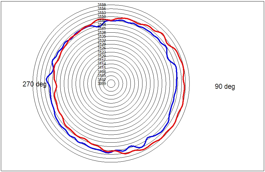

BTW, here's a neat way of looking at profound FM effects of eccentricity, the mechanical source of 0.55Hz IMD. For a test tone c 3kHz, once round the plot is one platter revolution, radius is 'instantaneous' frequency. One can also see warp and headshell wobble, as well as motor speed variations on these plots.
This plot happens to be a SP10 versus a 1200, red and blue traces.
Because it's not the noise floor, it's playing back a pink noise test record so at 1kHz that is programme material. Another test record bought that bit the dust.......BTW why does the noise floor wet/dry at 1k look the essentially the same in the second plot?
After playing wet, some (but not all) records measure significant increase in coefficient of friction in subsequent dry playback IME from my own tests. Many end up with higher coefficient than before wet playback. Those records which show this increase also show increased crackle-pop noise, and those which don't, don't. So I suppose wet playback can somehow permanently alters the vinyl friction surface, but don't know enough about vinyl polymer mechanics or tribology to explain why.What I don't have a handle on is the cause of a commonly-reported phenomenon with wet play (that I personally experienced with the old Lenco system)- records, once played wet, become horribly noisy if they are ever played again dry. Any ideas or data?
OK, I thought it was a silent groove magnified.

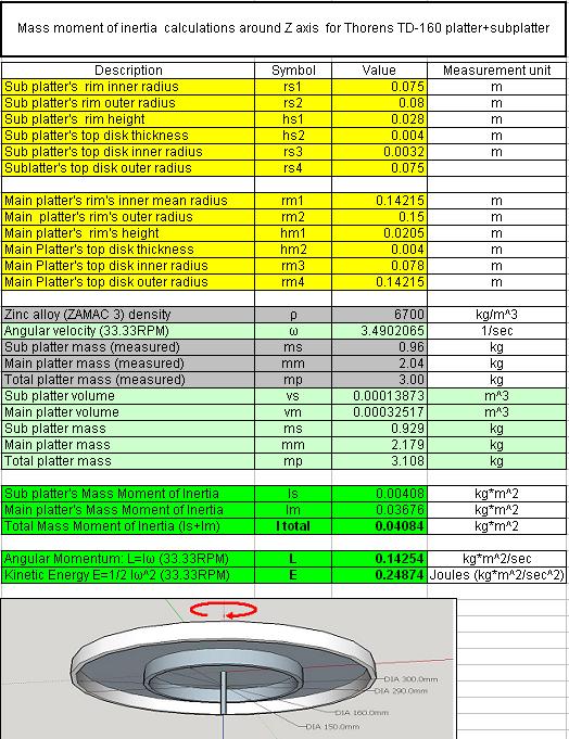

I calculated kinetic energy for a platter. Was surprised how pathetically low it is. 10mJ for the platter used in the pardee paper. Just goes to show if you don't do the sums you think wrong!
For the TD160 platter the rotational kinetic energy is ~250mJ at 33.3rpm

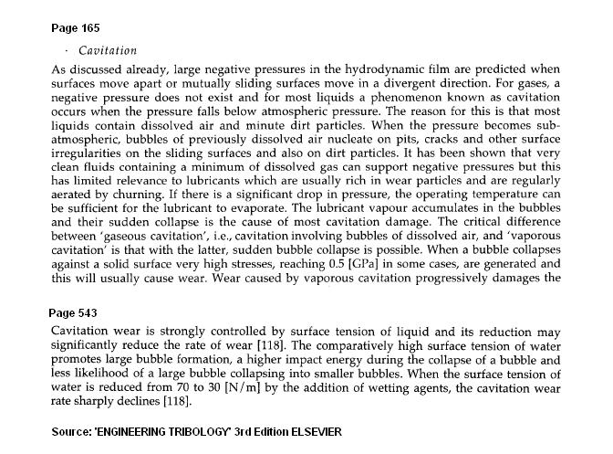

Cavitation maybe an issue.
Hydrodynamics is a complex field. The more the liquid film is squeezed and the more abrupt it’s thickness changes, the chances for cavitation formation increase.
My opinion is that the damaging of the groove walls from cavitation can be seen through an optical microscope.

It would not surprise me if changes to vinyl surface were visible with good microscopy. But the leap to cavitation as an explanation, though plausible IMO, is not confirmed AFAIK. The fluid layer is under great pressure for a very short time, and I'd imagine examination of available energy would be revealing as to whether the dynamics supports cavitation - I don't know enough to comment. Where is a tribologist when you need one ?My opinion is that the damaging of the groove walls from cavitation can be seen through an optical microscope.

And yes, with such a range of platter inertia available, stored rotational energy can vary by more than an order of magnitude and ~250mJ is also plausible. For the stopping method as per Pardee's paper, what matters really is that stopping time from bearing friction alone is as long as can be, and >90s is a good target for accurate measurement of stylus-groove friction measurement IME, which implies a high inertia platter.
