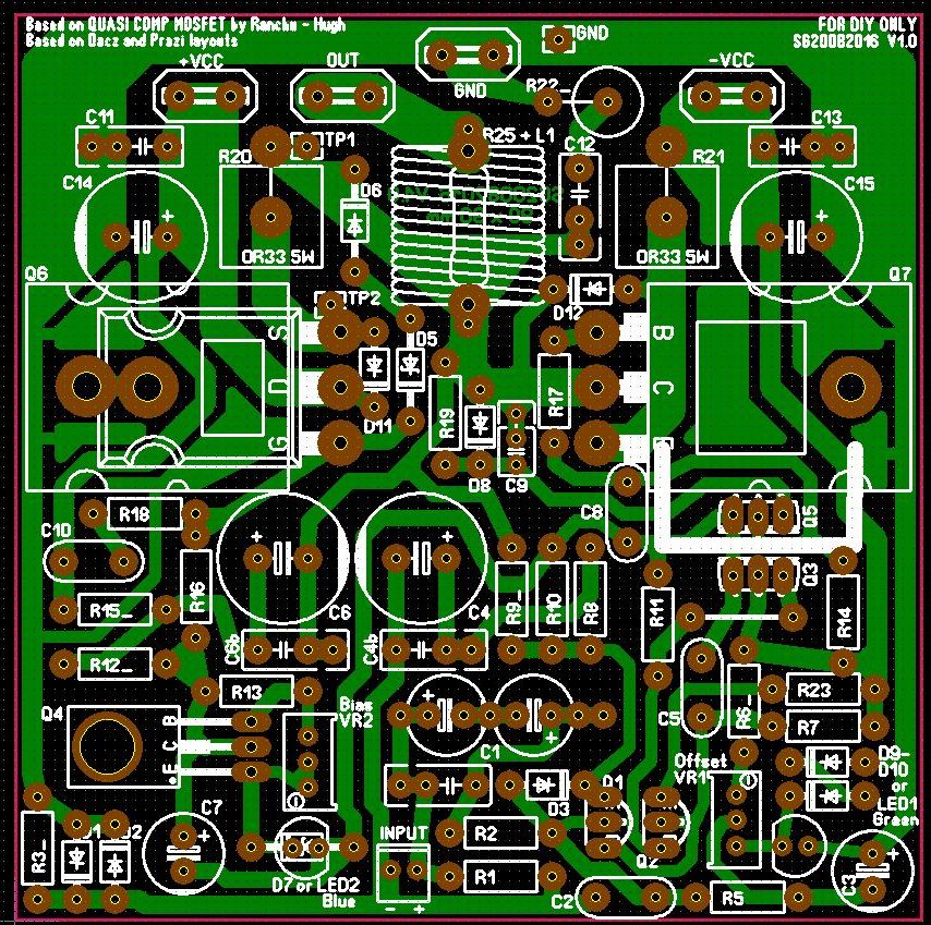

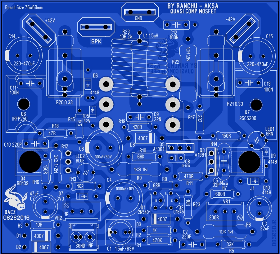

All, attached a little teaser. 90x90mm.
Regards.
I like it... and also "Prazi".. thanks for remembering me...Smartx21, it´s comming...
Regards.
also use metal washers on top to clamp down the o/p, as big as you can fit...will help in uniform load distribution...

You are both artists and this latest quasi layout is wonderful -- tight spacing and elegant.
What concerns me is how long it takes before this pcb and its brothers appears on Ebay - and how much profit is made by some anonymous entrepreneur whom no one here will ever know....
Hugh

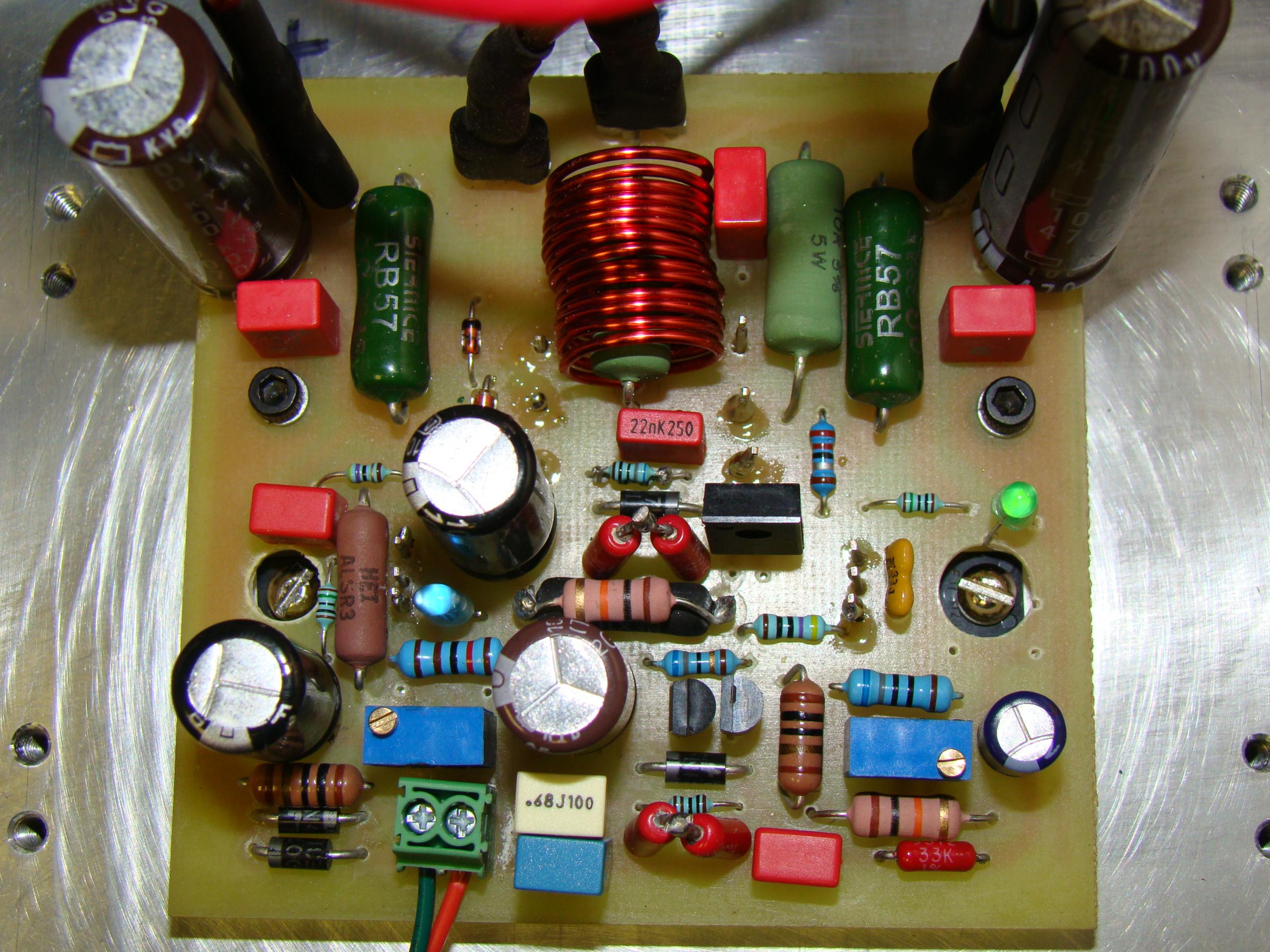

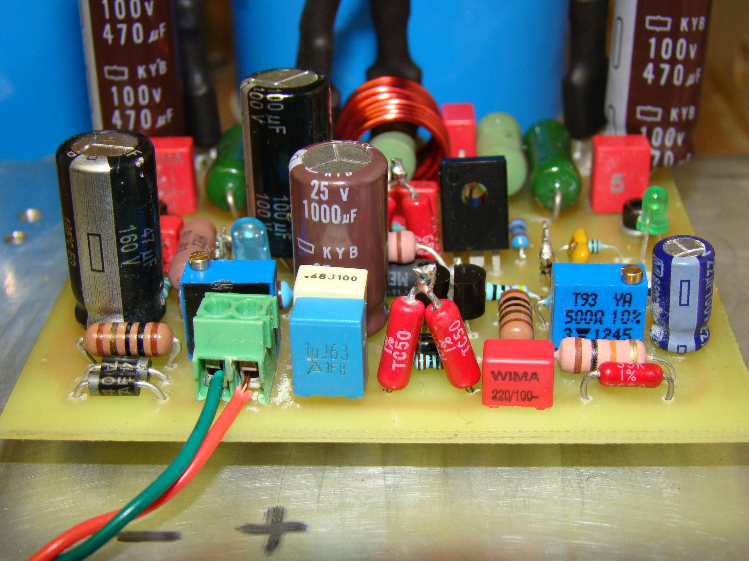

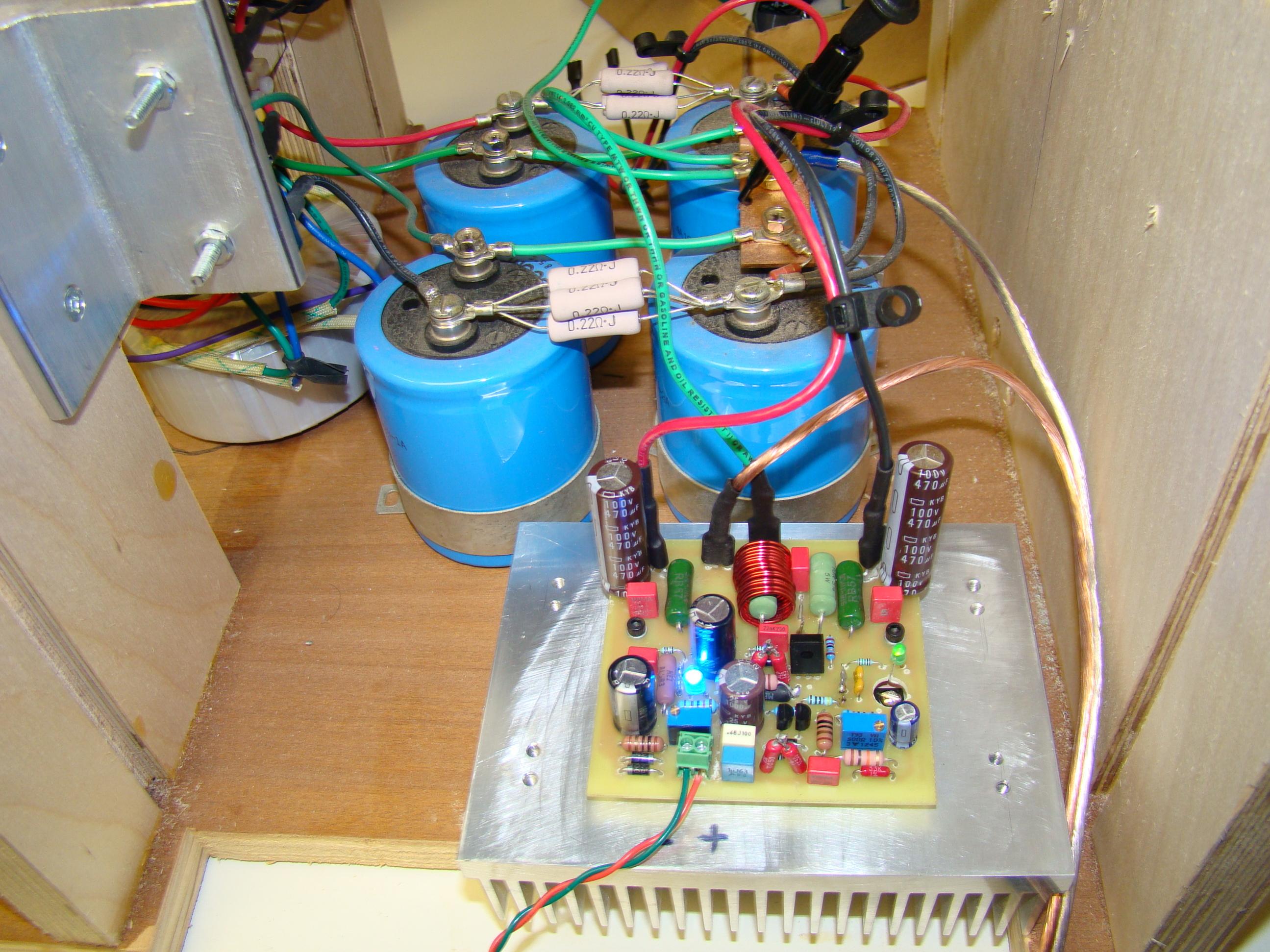

I know... late to the party as usual. 1st channel up and running. No drama. +-36 volt rails. No hum or buzz. Dacz layout is tight but all the components fit. The second channel should come together a bit faster. 1st impression says it's worth putting the second channel together for a real listen.
Thanks to all for all the work put in to make this happen.
Evan

Nice job! So Dacz layout works as prescribed on silkscreen with. No changes needed?
congrats evanc for the build.. now i am attaching the final PCB (only zobel capacitor rerouted) with better silk view.

Dacz layout and silk screen are perfect. The only tight parts are the electrolytic caps I used. I only had higher voltage then is needed on hand. It will probably take me a couple days to get the second channel running. I'll report back.
PS. I used IRFP 240 and MJL 3281A. The 1381 parts are F rank.
