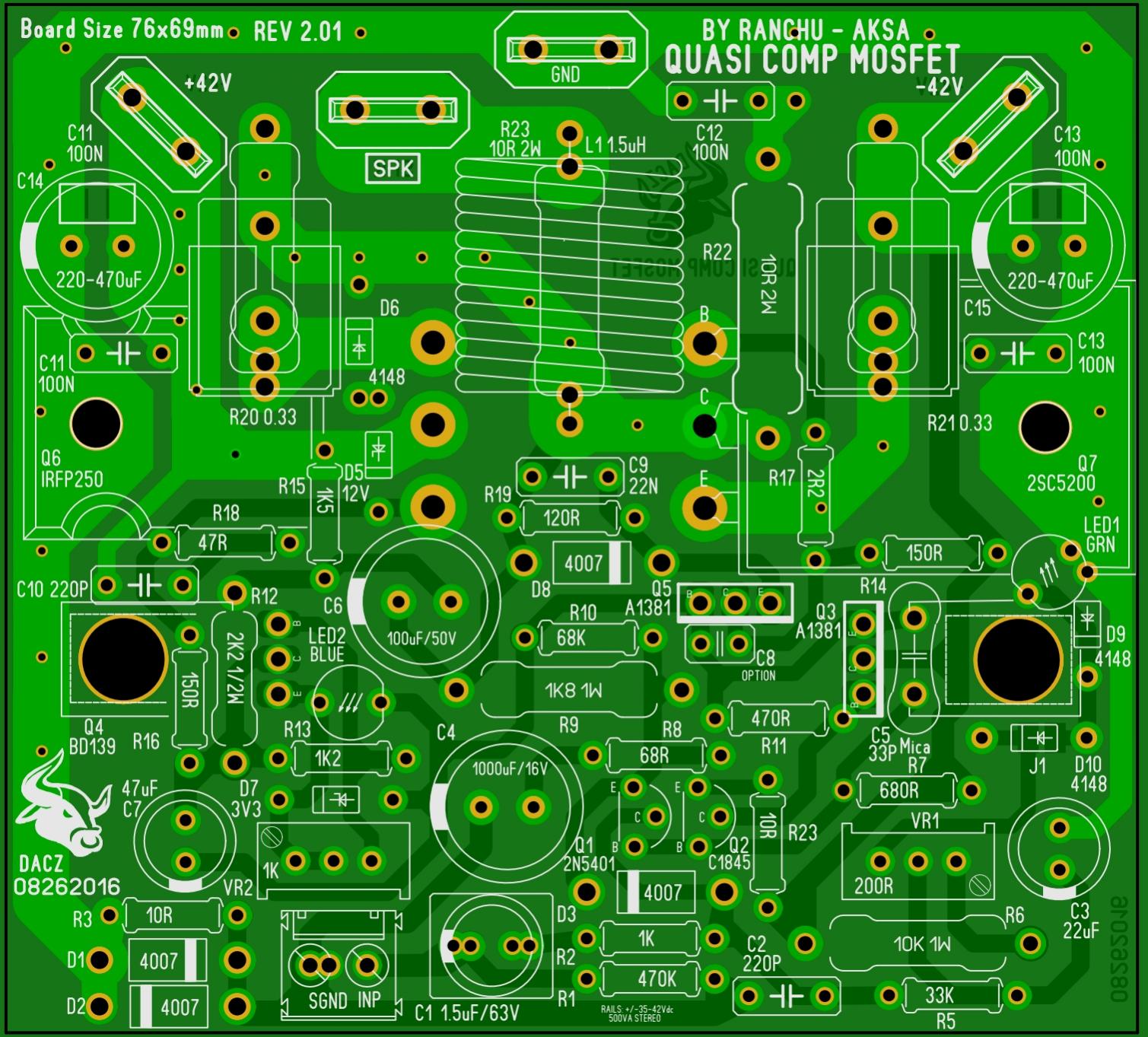

I have 8 spare boards lying around - happy to give a few away. They were dirt cheap from PCBway (10 for same price as 5). Ranchu layout - tried and tested...

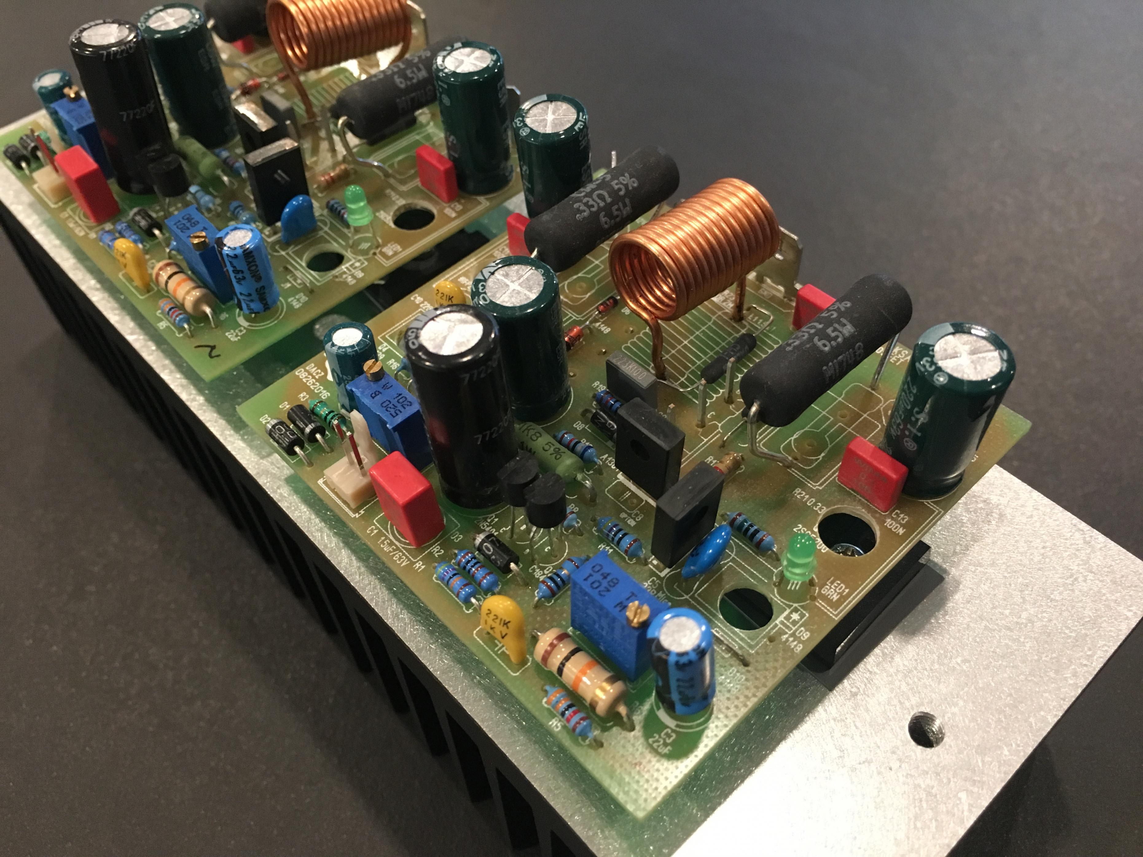

Yes, it's coming back to me now...I have the DACZ layout. 1 sided and tight fitting in places. I have had 2 stuffed, mounted and ready to test for a few months, but haven't had time to get back to them :(

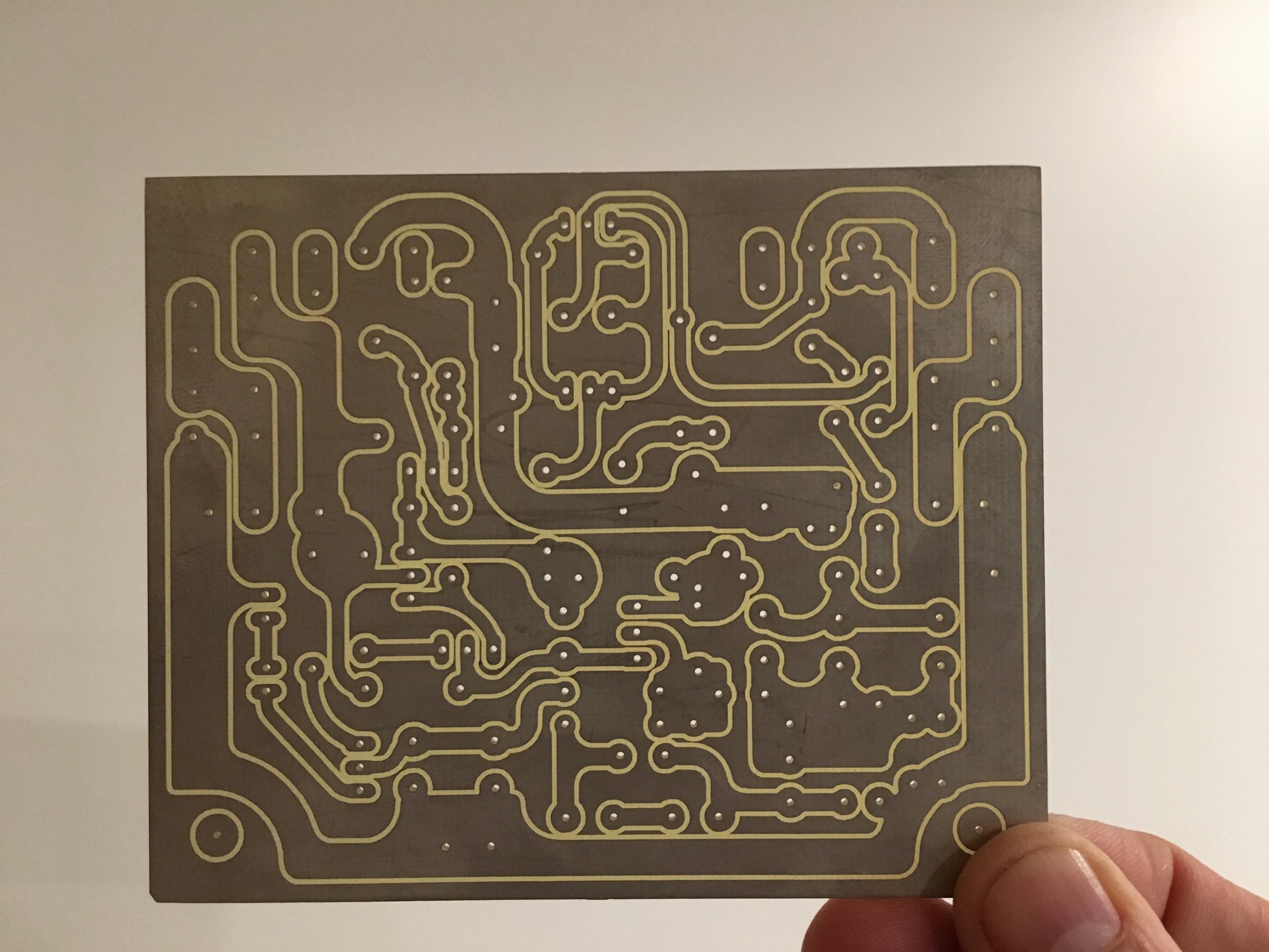

I also played around with the Thiago layout on my (biggish) CNC - I didn't think it would have the finesse required, but it looks to have worked a treat (not stuffed yet though). I am confident I can probably easily knock out a few more if I ever need, although PCBway is so convenient, cheap and fast that it's hardly worth the trouble of making your own.

Hello Scott,
That's a beautiful looking CNC job. with that you dont need pcbway!, ever.
All the best with testing those beauties and thank you for the confidence shown.

There were four VSQA pcbs. Ranchu (Oz), DACZ (Phillipines), Thiago (Brazil), Phunk (South Africa) and last, Prasi (India). All were outstanding and very tidy, tight layouts and a credit to the original schematic. I particularly enjoyed Phunk's Paisley version, which looks like a psychedelic extravaganza, humorous and ironic. But the most most frequently used version was from DAZC, which was dense and elegant. All worked just fine, so you select what you want.... all the gerbers are available on this thread.
Looking back this was one of the most most versatile amps on this forum. There was design input from Ranchu, Bigun, Richard, XRK971, me, Ilizmn and others. On listening tests with particularly StillforGiven, XRK, and a few others it was described as very satisfying, and very musical, with strong bass and utter silence. It also showed huge depth of image and marvellous stereo field. There was even a full power version which gave more than 100W using FQA40N25 Fairchild mosfet and FJL4315 from OnSemi - just two output devices - run from up to 56V rails.

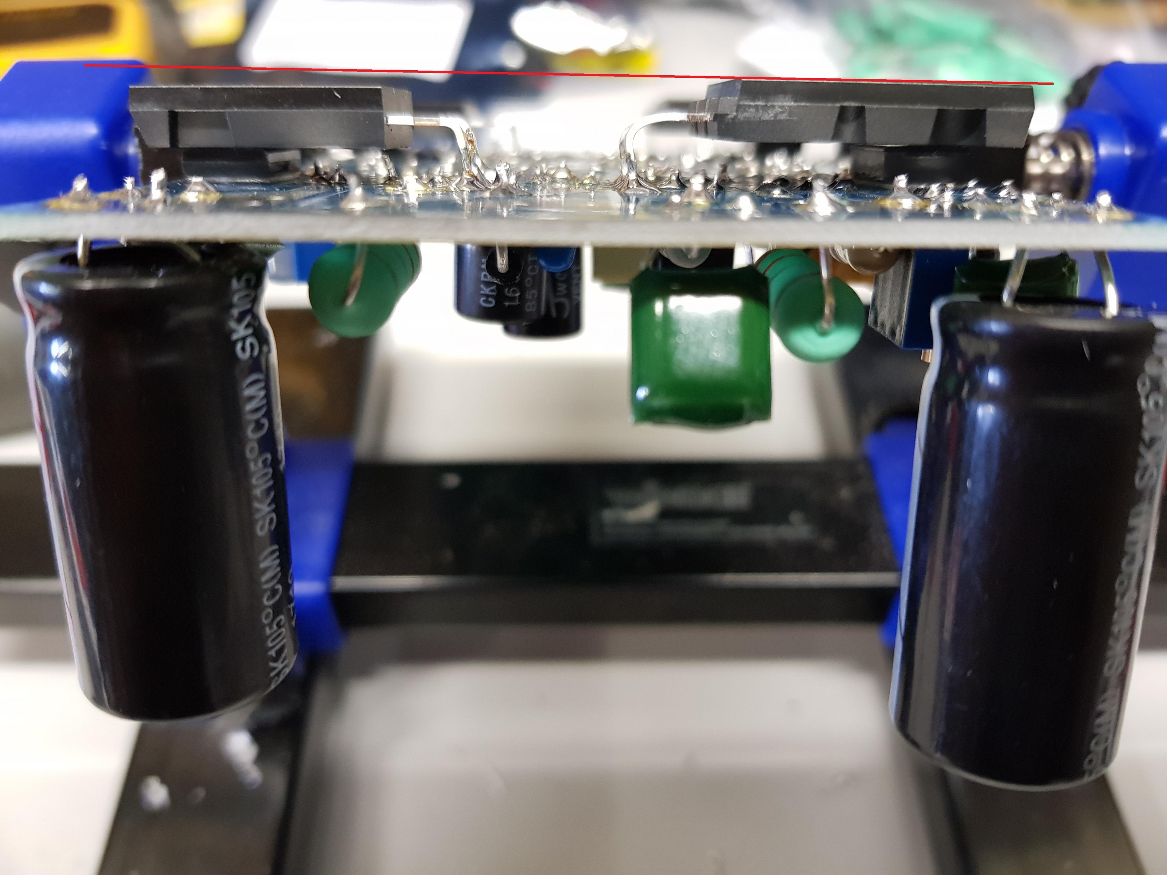

Just a note regarding the Phunk layout - I've gone for 2SC5200 and IRFP250M, BD139 and KSA1381 but found that the combined widths between 2SC5200+KSA1381 are not equal to IRFP250M+BD139.
This means that mounting the outputs directly to a heatsink isn't possible without a shim, otherwise there would either be a gap or mechanical stress.
I've ordered a piece of copper flat bar to shim it out, so hopefully I can get this fired up soon.
I guess it depends on the tolerances of the trannies as to whether or not the widths end up equal, as the dimensions added up right in the datasheet 'middle of average'.
