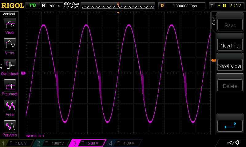

Do you still observe these bursts in the falling slopes, right after crossing the zero line?
As said elsewhere in this board, by swapping both the input and the output devices from BJT's to FET's, you've turned the amplifier into completely another one. Your scope clearly shows massive stability issues that cannot be resolved just by increasing bias. Now you may not take the compensation regime of the Honey Badger as-is, you need another one. Sadly I can't help you either, as I'm clearly no KOC (King of Compensation).

Does this oscillation turn on as you pass above 0.8Vac at the input?Here is what I see in the scope when the amp is loaded by a speaker.
Input is 0.8v
But is invisible below 0.8Vac?
Does a low input voltage with various reactive loads promote any oscillation?
Have you tried stepping from 1nF through to 1uF at the speaker terminals?

Overshoot is no sign of instability, and some topologies work best with a little overshoot. Ringing however is. Outright oscillation should not occur regardless of overshoot. Hopefully you are taking the square wave measurements without the RC filter.
Try tuning the compensation without R24 first, since it can introduce some overshoot and harmless response quirks at RF.
Crackling when the volume is changed probably means the amp is going in and out of oscillation as the pot change resistance to ground and resistance to source (sometimes grounding the input causes oscillation, or it can be the other way, there is oscillation if the input is not grounded - either way, it should be addressed either as local parasitic oscillation or by adjusting the global compensation). If you cannot find the oscillation on the scope it's possible it's in the hundreds of MHz and is probably parasitic oscillation of the input FETs. Your input is heavily filtered by the input RC, but it's also possible that interactions through the input ground could cause oscillation. If this is the case you may have to try changing grounding arrangements. For instance grounding the heatsink to the PCB through a 47R resistor is something that may help. Or changing the order of connections along the ground trace.
Your scope plot shows oscillation in the crossover region where the output stage is slower than normal. To me this suggests that C17 may be too large.

I matched the mosfets and the resistor I did using your suggested method. These are between 0.1012 and 0.1015 ohms.... Anyway this issue is now adressed as I found the difference in currents was due to oscilations while measuring.
I increased the capacitors between drain and gate of the output mosfets to 15p and now everything seems more stable
The oscilation was visible only when input higher than 0.6Vac
I did not try purely reactive loads
