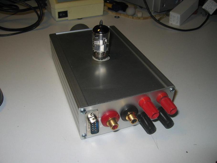

Andypairo said:Hanzwillem, are you leaving a hole in the cover of the case for the tube?
Cheers
Andrea
Yes, I drilled a hole (21mm I think), the tube socket is just slightly under it. The entire tube will stick out.
I hope digi is allright indeed. He's probably short on time.
I only have to wait for a proper relay. Then I'll try firing it up. I got a spare 6dj8 tube anyway...

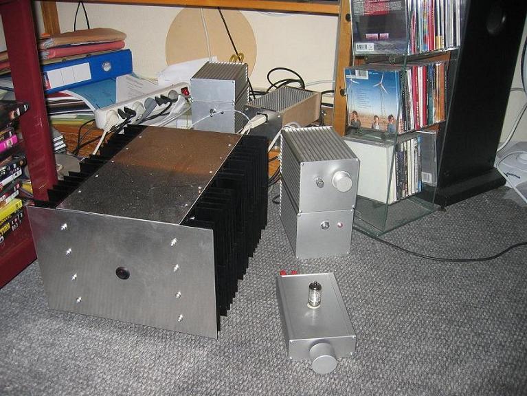

Here is my version.
Nothing fancy really. All surplus stuff, except for the housing, but that was real cheap.
Here is my version.
For size comparison.
Here is the VBITNGC next to the Aleph 30. Behind it with the red LED is my upgraded BoZ, with Vitamin Q paper oil decoupling caps. (this one plays a lot better than my unBosoZ with elna silmic coupling caps)
Behind it right is Peter Daniels non-os DAC. And a gainclone.
I hope this valve unit will sound nice. The Aleph has just no competition to my gainclone. The bass and control of the GC is very very good, but the overall soundquality of the aleph is so far unbeatable in all amps I had.
Cheers, I'll keep you guys updated when I fire it up. (hopefully not literairly )
