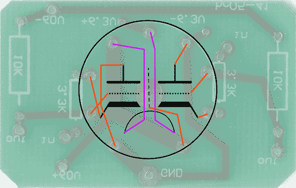

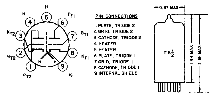

I don't think it is a matter of disconnecting one pin.
The pinout given in the datasheets is from below (looking at the pins) but here is interpreted as from above. The solution for this is to mount the socket on the component side.
I was disappointed because I had a hard time fitting the socket just to find that it couldn't work as-is.... :bawling:
Cheers
Andrea
Indeed. I made the same mistake with my 1st tube PCB (handdrawn ARC SP3A pre-amp clone).
I just did a bit of PhotoShop/Illustrator to get the following 2 illustrations.... the one in this post is with the tube socket mounted on the silkscreen side (as intended but wrong -- digi don't add power to your board) and in the next post, mounting socket on the solder side (a but tricky to solder but probably doable -- I may have to use my isosocket).
Did that preamp work well?
dave
In this case fireworks might happen :hot: :cannotbe:
I suggest the use of a "spare" tube for the first tests.
Cheers
Andrea
dave
It seemed that also I got confused with how you look at the pins, from the bottom or from the top... It is not the first time that that happened to me :(
What a shame, I am really sorry about that mess! And it is at least 50% my fault.
It's true: the upper board is mirrored, so has to be assembled from the cupper side.

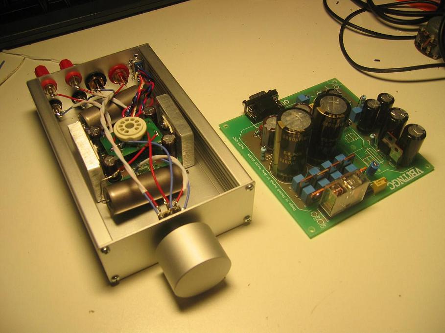

How is everybody doing with their projects?
I am approaching the finish. The amp itself is almost finished. I got all the parts for the PSU as well. I will start building assambling that later this week, or maybe even tomorrow.
All signal wiring is silver. PSU wiring is salvaged from some sony ES DAT recorder, as well as the ALPS pot.
Decoupling caps are military grade russian paper in oil. Very nice stuff.
I hope to be able to finish this one soon!
Hallo Hanzwillem,
Very, very nice construction on the photo ! Is it a conrad enclosure you build it in? It looks great!
Did you read and repair all the reported missngs in the PCB's?
Can your please post all the chanches that you made on the original schematics and PCB's, i am sure you help many builders (me included).
I stop with the project becouse off all the bugs in the PCB's, and i am not a crack you know. So i wait till anyone has a working prototye of it.

Yes, it is a case from Conrad. Part.nr. 523232 It is only 10,95 Euro. And looks pretty good. I drilled a hole in the top plate were the tube will stick out.
I guess it will be my duty to be one of the first to fire one of these babies up :)
I have not really made a list of problems occured, the biggest ones were ones already described. Of course I do not know if the thing will work, but my guess is that it will work. We'll see...
Also, please do not forget to mount the T-network on the bottom of the amp board. Easy to forget that part :)
