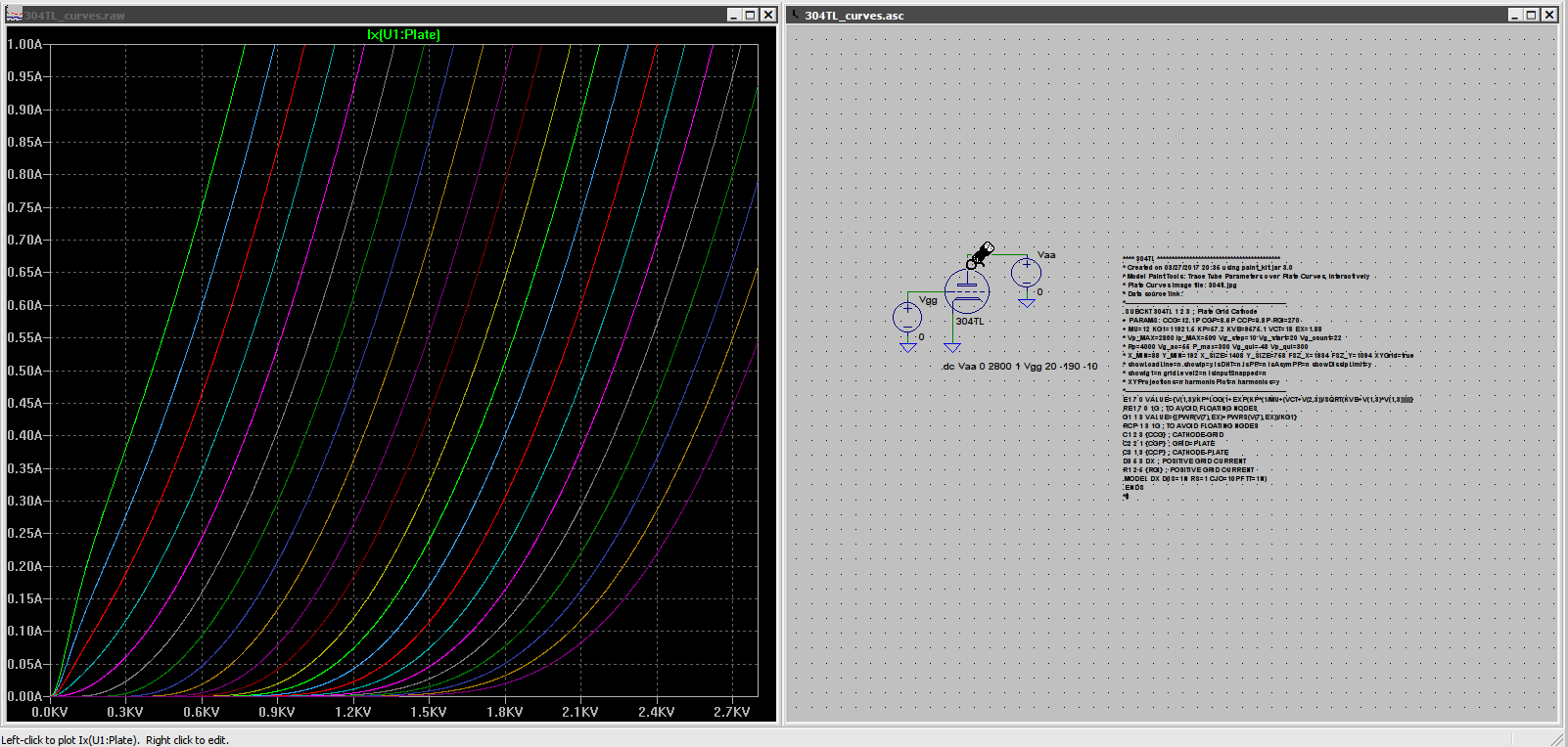

I settled for just triode model, it generated more accurate model than DHT, hope you like it, and if you know why DHT model is less accurate, let us know.
Get rid of those resistors, you don't need them, as it will skew your curves. ;)
Measure plate current directly, as in the example below.

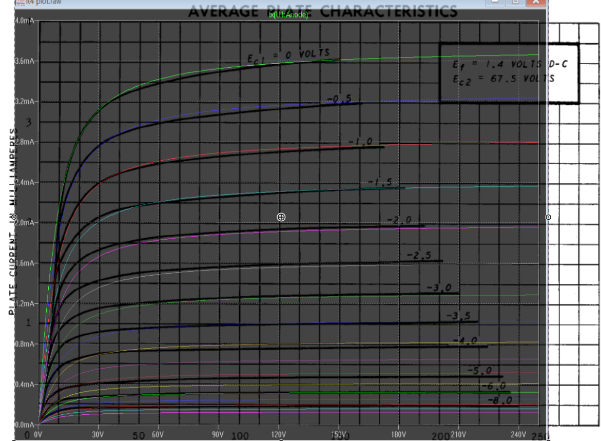

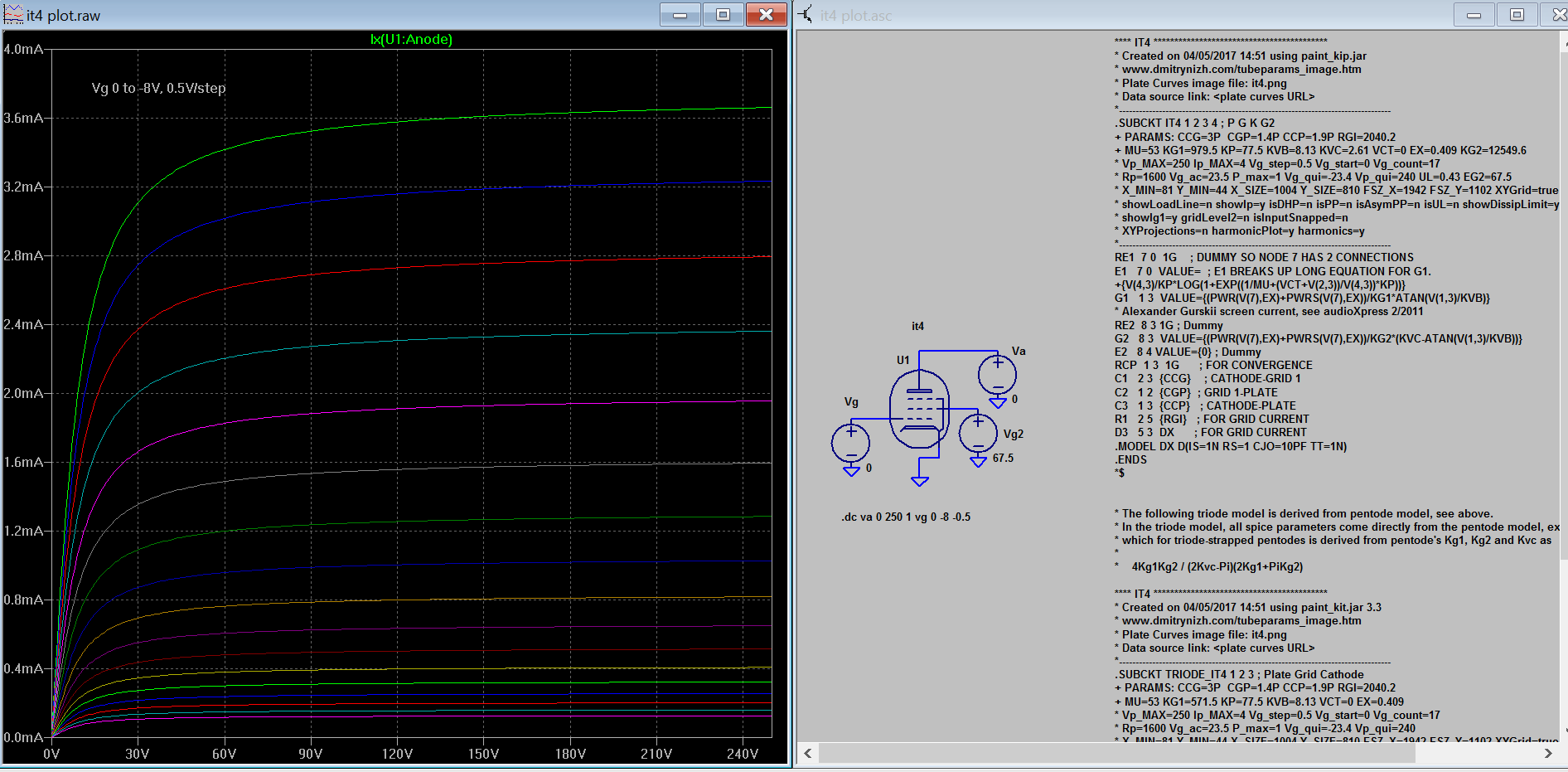

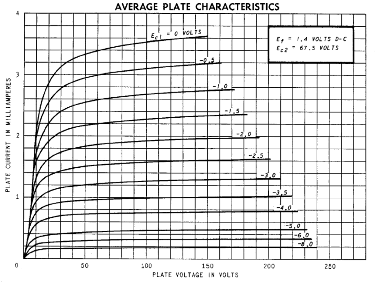

Here is the model for GE IT4 I painted:
Code:
**** IT4 ******************************************
* Created on 04/05/2017 14:51 using paint_kip.jar
* [URL="http://www.dmitrynizh.com/tubeparams_image.htm"]Model Paint Tools: Trace Tube Parameters over Plate Curves, Interactively[/URL]
* Plate Curves image file: it4.png
* Data source link: <plate curves URL>
.SUBCKT IT4 1 2 3 4 ; P G K G2
+ PARAMS: CCG=3.6P  CGP=0.01P CCP=7.5P RGI=2000
+ MU=53 KG1=979.5 KP=77.5 KVB=8.13 KVC=2.61 VCT=0 EX=0.409 KG2=12549.6
* Vp_MAX=250 Ip_MAX=4 Vg_step=0.5 Vg_start=0 Vg_count=17
* Rp=1600 Vg_ac=23.5 P_max=1 Vg_qui=-23.4 Vp_qui=240 UL=0.43 EG2=67.5
* X_MIN=81 Y_MIN=44 X_SIZE=1004 Y_SIZE=810 FSZ_X=1942 FSZ_Y=1102 XYGrid=true
* showLoadLine=n showIp=y isDHP=n isPP=n isAsymPP=n isUL=n showDissipLimit=y
* showIg1=y gridLevel2=n isInputSnapped=n
* XYProjections=n harmonicPlot=y harmonics=y
RE1  7 0  1G    ; DUMMY SO NODE 7 HAS 2 CONNECTIONS
E1   7 0  VALUE=  ; E1 BREAKS UP LONG EQUATION FOR G1.
+{V(4,3)/KP*LOG(1+EXP((1/MU+(VCT+V(2,3))/V(4,3))*KP))}
G1   1 3  VALUE={(PWR(V(7),EX)+PWRS(V(7),EX))/KG1*ATAN(V(1,3)/KVB)}
* Alexander Gurskii screen current, see audioXpress 2/2011
RE2  8 3 1G ; Dummy
G2   8 3  VALUE={(PWR(V(7),EX)+PWRS(V(7),EX))/KG2*(KVC-ATAN(V(1,3)/KVB))}
E2   8 4 VALUE={0} ; Dummy
RCP  1 3  1G      ; FOR CONVERGENCE
C1   2 3  {CCG}    ; CATHODE-GRID 1
C2   1 2  {CGP}  ; GRID 1-PLATE
C3   1 3  {CCP}   ; CATHODE-PLATE
R1   2 5  {RGI}   ; FOR GRID CURRENT
D3   5 3  DX      ; FOR GRID CURRENT
.MODEL DX D(IS=1N RS=1 CJO=10PF TT=1N)
.ENDS
Code:
* The following triode model is derived from pentode model, see above.
* In the triode model, all spice parameters come directly from the pentode model, except for Kg1,
* which for triode-strapped pentodes is derived from pentode's Kg1, Kg2 and Kvc as
*    4Kg1Kg2 / (2Kvc-Pi)(2Kg1+PiKg2)
* Created on 04/05/2017 14:51 using paint_kit.jar 3.3
.SUBCKT TRIODE_IT4 1 2 3 ; Plate Grid Cathode
+ PARAMS: CCG=3P  CGP=1.4P CCP=1.9P RGI=2040.2
+ MU=53 KG1=571.5 KP=77.5 KVB=8.13 VCT=0 EX=0.409
* showLoadLine=n showIp=y isDHT=n isPP=n isAsymPP=n showDissipLimit=y
E1 7 0 VALUE={V(1,3)/KP*LOG(1+EXP(KP*(1/MU+(VCT+V(2,3))/SQRT(KVB+V(1,3)*V(1,3)))))}
RE1 7 0 1G  ; TO AVOID FLOATING NODES
G1 1 3 VALUE={(PWR(V(7),EX)+PWRS(V(7),EX))/KG1}
RCP 1 3 1G   ; TO AVOID FLOATING NODES
C2 2 1 {CGP} ; GRID=PLATE
D3 5 3 DX ; POSITIVE GRID CURRENT
R1 2 5 {RGI} ; POSITIVE GRID CURRENT
.ENDS

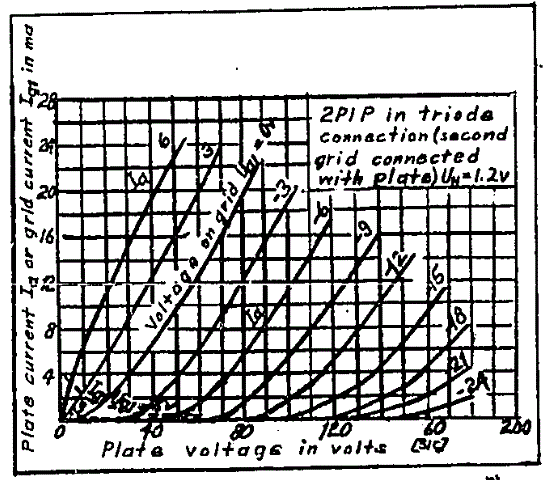

2P1P SPICE Models
Hope someone can help me to create a LTspice model for 2P1P tube. Thanks!
2P1P Triode-Connected SPICE Model:
Code:
* Generic triode model: 2P1P_T_AN
* Copyright 2003--2008 by Ayumi Nakabayashi, All rights reserved.
* Version 3.10, Generated on Wed May 17 12:02:28 2017
*                 Anode
*                 | Grid
*                 | | Cathode
.SUBCKT 2P1P_T_AN A G K
BGG   GG   0 V=V(G,K)+-0.38808109
BM1   M1   0 V=(0.058425221*(URAMP(V(A,K))+1e-10))**-0.77409793
BM2   M2   0 V=(0.6596022*(URAMP(V(GG)+URAMP(V(A,K))/5.8262133)+1e-10))**2.2740979
BP    P    0 V=0.00079283737*(URAMP(V(GG)+URAMP(V(A,K))/8.8329198)+1e-10)**1.5
BIK   IK   0 V=U(V(GG))*V(P)+(1-U(V(GG)))*0.00047510475*V(M1)*V(M2)
BIG   IG   0 V=0.00039641868*URAMP(V(G,K))**1.5*(URAMP(V(G,K))/(URAMP(V(A,K))+URAMP(V(G,K)))*1.2+0.4)
BIAK  A    K I=URAMP(V(IK,IG)-URAMP(V(IK,IG)-(0.00053479945*URAMP(V(A,K))**1.5)))+1e-10*V(A,K)
BIGK  G    K I=V(IG)
* CAPS
CGA   G    A 0.5p
CGK   G    K 3.5p
CAK   A    K 4p
.ENDS

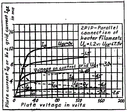

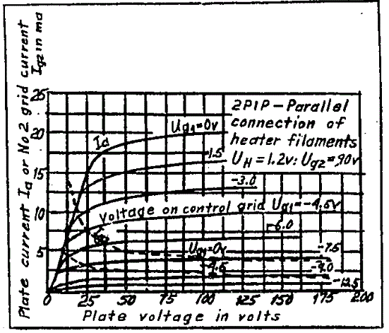

2P1P Pentode SPICE Model:
Code:
* Generic pentode model: 2P1P_AN
* Version 3.10, Generated on Tue May 16 13:43:57 2017
*               Anode
*               | Screen Grid
*               | |  Control Grid
*               | |  |  Cathode
.SUBCKT 2P1P_AN A G2 G1 K
BGG   GG   0 V=V(G1,K)+-0.38808109
BM1   M1   0 V=(0.058425221*(URAMP(V(G2,K))+1e-10))**-0.77409793
BM2   M2   0 V=(0.6596022*(URAMP(V(GG)+URAMP(V(G2,K))/5.8262133)))**2.2740979
BP    P    0 V=0.00079283737*(URAMP(V(GG)+URAMP(V(G2,K))/8.8329198))**1.5
