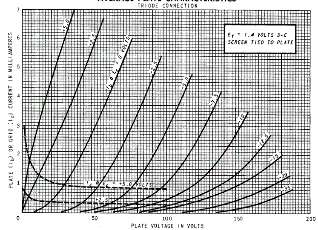

So I am attaching my digitized triode plate characteristics for the 1T4
Also, I am attaching the resultant triode model that Ayumi generates.

Yes, the digitized characteristic should be in CSV format, and it should contain less data points - 3-4 points per Eg1 should be sufficient. I also like to skip the Eg1>0V curves to reduce the error rate.
In any case, attached please find the simplified dataset (be sure to rename the suffix to CSV before using) and here is the command to trace the dataset, try it for yourself to see if it works for you.
View attachment 1T4_T.txt
Code:
Ip.cal("1T4_T.csv", "t1T4", Cgp=1.0E-14, Cgk=3.6E-12, Cpk=7.5E-12, pentode.chara=c(67.5, 67.5, 0, 0.0034, 0.0015, 250000))

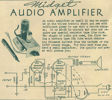

OK, I am building a simple two tube amp, just for the heck of it. I have attached the schematic. No, it is not an amp that is "crunchy" or hi-fi but it uses unusual tubes, at least they are unusual for this time. So, I like to model these things to see what the voltages might be and fuss around with other components. blah, blah, blah.
If it sounds half way decent, I will build a second one and use it at work for my PC audio. Most of the engineers where I work are so young they have never even seen a tube let alone a working tube amp! Go ahead, touch it!

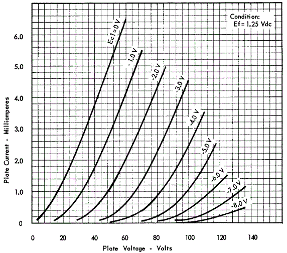

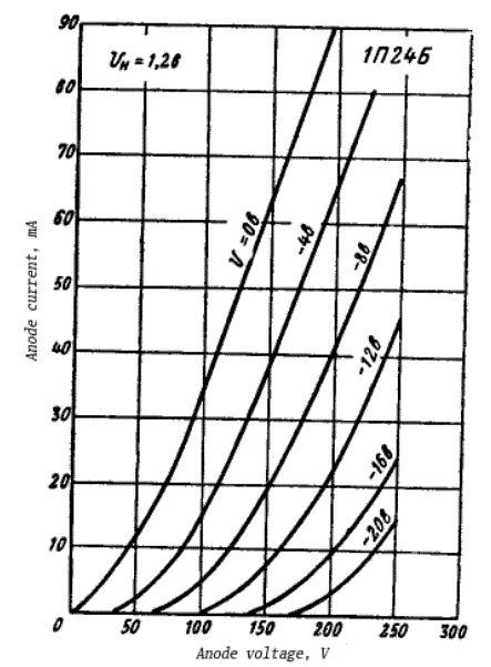

Hello jazbo8,You are welcome.
2P1P model runs great, thanks!
I have attached 1AD4, 1P24B, and 1T4 triode curves here.
I used Curve Captor make triode models which run good with ltspice.
I wonder do you have time to help me creating pentode/triode models.
I am interested to see what difference between tridoe models created from Curve Captor and from Ayumi's.
Thanks again!

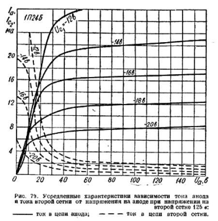

Do you have the pentode characteristic for the 1P24B? The one I have does not seem to correlate with the triode characteristic that you provided.I have attached 1AD4, 1P24B, and 1T4 triode curves here. <snip>
Also, I tried making the pentode model for 1T4, but the result was way off from the characteristic shown in the GE datasheet, so it's not really usable.
