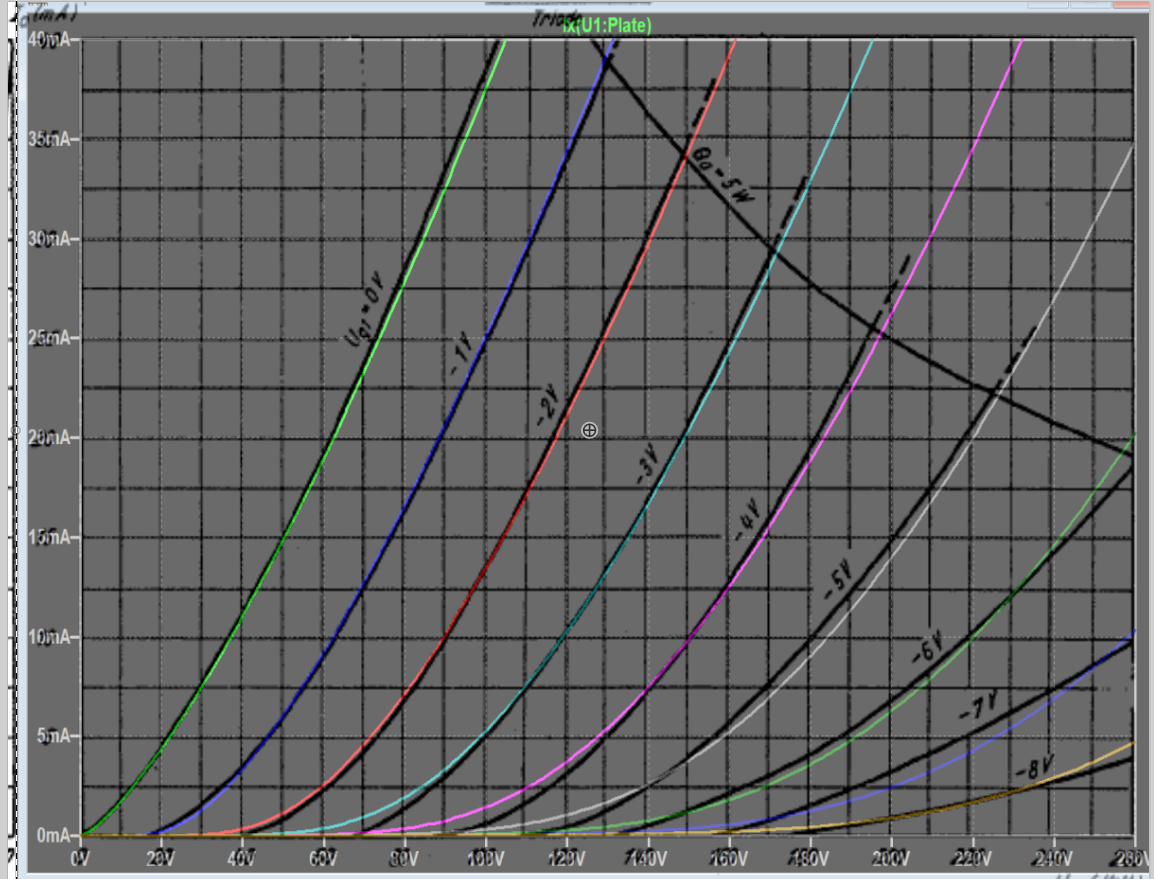

Here you can find a triode connected curve for VF14, (similar to EF14). I just trace it with CurveCaptor and model generated and work in LTSpice.
* ef14-3 PSpice model
.subckt ef14-3 P G K
Gp P K VALUE={(0.07667528023m)*limit(V(P,K)*log(1.0+(0.01432477678)+exp((2.400438702)+(2.400438702)*((27.36298562)+(-3289.702555m)*V(G,K))*V(G,K)/V(P,K)))/(2.400438702),0.0,1.0e16)**(1.33452029)}
.ends ef14-3
Here the tutorial in social media.

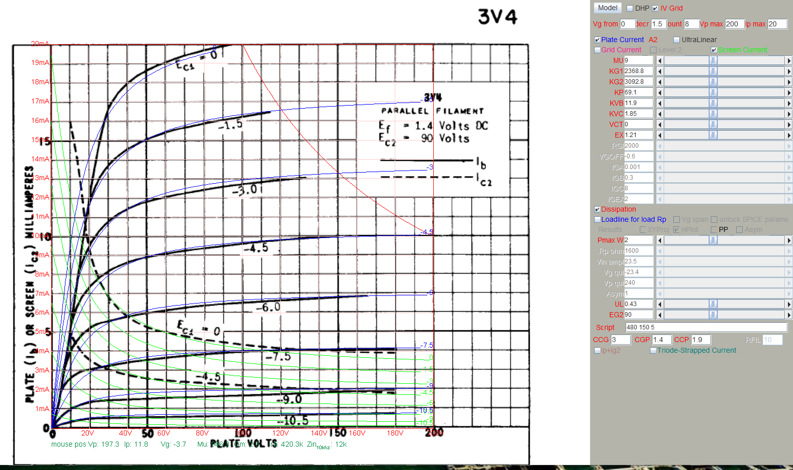

Does any one have triode model for 3V4/3A4? I searched the thread but couldn't find it. Thanks.

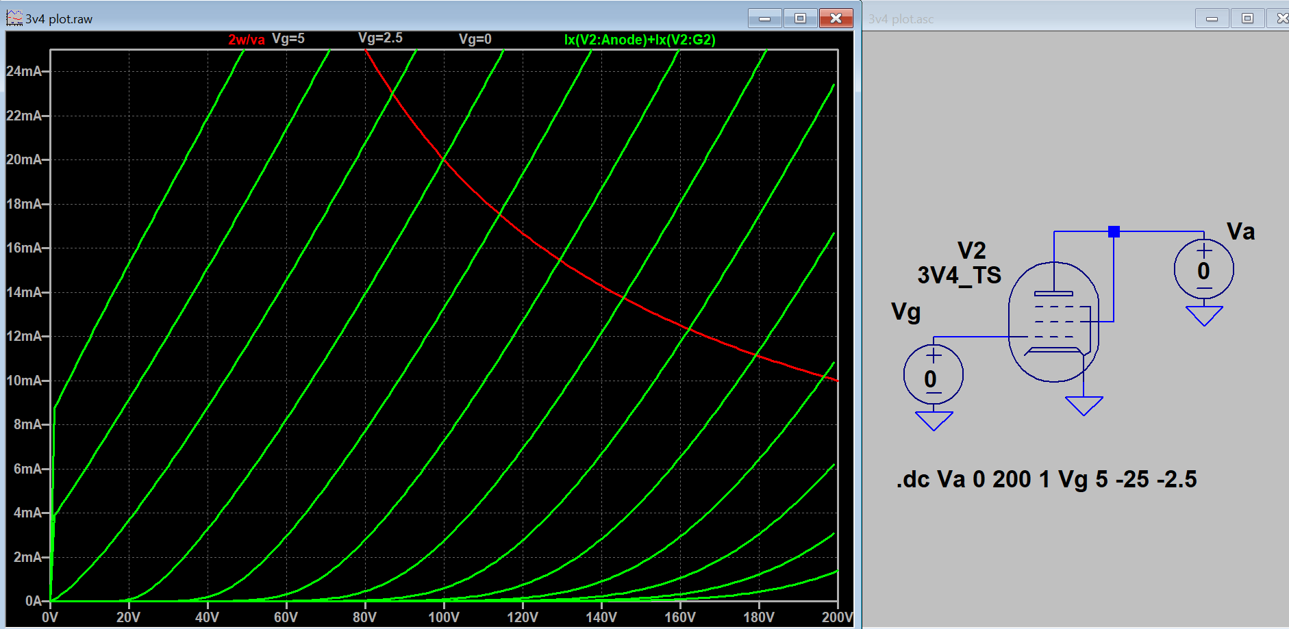

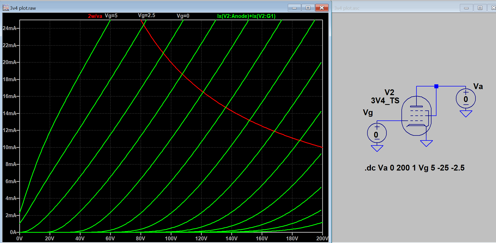

I painted this 3V4 Tung Sol, included screen current and triode Mu est 9. Attached is the pentode and triode connected plot. The inter electrode capacitance can be changed if necessary.
**** 3V4_TS ******************************************
* Created on 07/20/2017 17:52 using paint_kip.jar
* www.dmitrynizh.com/tubeparams_image.htm
* Plate Curves image file: 3v4-ts.png
* Data source link: <plate curves URL>
.SUBCKT 3V4_TS 1 2 3 4 ; P G K G2
+ PARAMS: CCG=3P CGP=1.4P CCP=1.9P RGI=2000
+ MU=9 KG1=2368.8 KP=69.1 KVB=11.9 KVC=1.85 VCT=0 EX=1.21 KG2=3092.8
* Vp_MAX=200 Ip_MAX=20 Vg_step=1.5 Vg_start=0 Vg_count=8
* Rp=1600 Vg_ac=23.5 P_max=2 Vg_qui=-23.4 Vp_qui=240 UL=0.43 EG2=90
* X_MIN=105 Y_MIN=90 X_SIZE=753 Y_SIZE=757 FSZ_X=1589 FSZ_Y=975 XYGrid=true
* showLoadLine=n showIp=y isDHP=n isPP=n isAsymPP=n isUL=n showDissipLimit=y
* showIg1=n gridLevel2=n isInputSnapped=n
* XYProjections=n harmonicPlot=y harmonics=y
RE1 7 0 1G ; DUMMY SO NODE 7 HAS 2 CONNECTIONS
E1 7 0 VALUE= ; E1 BREAKS UP LONG EQUATION FOR G1.
+{V(4,3)/KP*LOG(1+EXP((1/MU+(VCT+V(2,3))/V(4,3))*KP))}
G1 1 3 VALUE={(PWR(V(7),EX)+PWRS(V(7),EX))/KG1*ATAN(V(1,3)/KVB)}
* Alexander Gurskii screen current, see audioXpress 2/2011
RE2 8 3 1G ; Dummy
G2 8 3 VALUE={(PWR(V(7),EX)+PWRS(V(7),EX))/KG2*(KVC-ATAN(V(1,3)/KVB))}
E2 8 4 VALUE={0} ; Dummy
RCP 1 3 1G ; FOR CONVERGENCE
C1 2 3 {CCG} ; CATHODE-GRID 1
C2 1 2 {CGP} ; GRID 1-PLATE
C3 1 3 {CCP} ; CATHODE-PLATE
R1 2 5 {RGI} ; FOR GRID CURRENT
D3 5 3 DX ; FOR GRID CURRENT
.MODEL DX D(IS=1N RS=1 CJO=10PF TT=1N)
.ENDS

That is great. Thanks. I did a line stage with 3V4 in triode mode and it sounds pretty good. I am on travel so I don't have the exact numbers. If the memory served me correctly, I biased at Vp=80V, Vk=4.7V, plate current is around 9mA, which is very close to your plate curve showed. Excellent work!

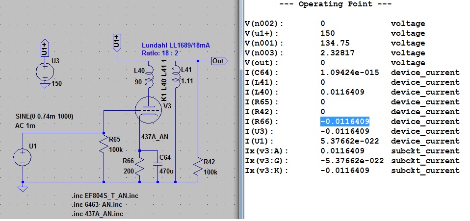

Have tried 6463 ,EF804S Triode-Connected SPICE Model,it worked well,but for the WE437,it seems like incorrect,the current of R66 shows -0.0116409.attached the screen short and the LTSPICE files.
Best Regards
Leo

Try reverse the direction of R66. I found that long ago, not sure why the current phase is reversed.
Edit: in other sim, it shows the direction when you bring the cursor over the components, so please note.
