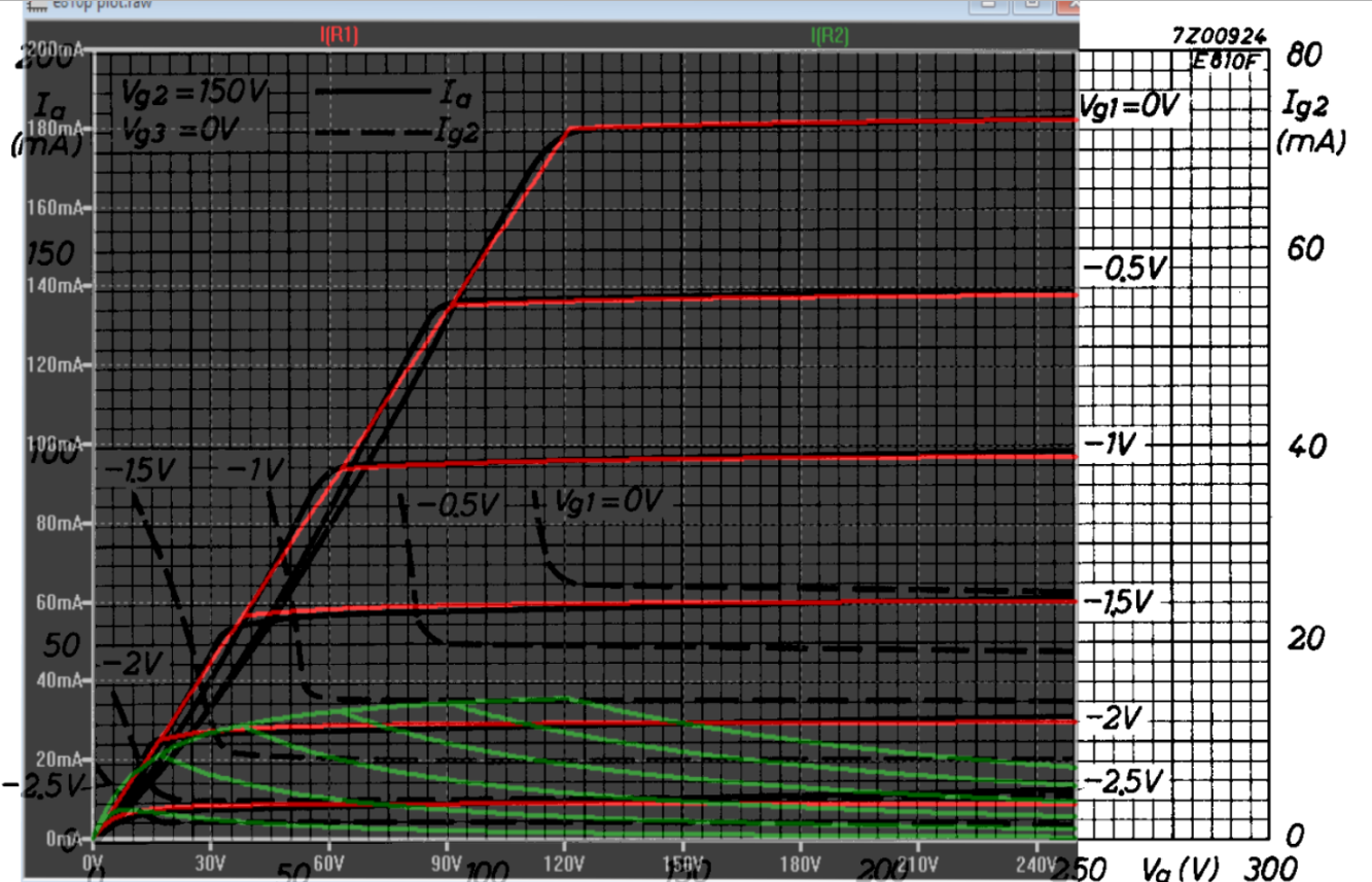

Here is E810F model base of :: View topic - Updated TETRODE.TXT file by Stephie Bench. Formulae in original paint tool has been replaced so to impose sharp cut off limit which paint tool is unable to do. Maybe these changes can be included in paint tool in future I hope.
.SUBCKT E810F 1 2 3 4 ; P G K G2
+ PARAMS: CCG=14.5P CGP=0.036P CCP=3.5P RGI=1000
+ MU=57 KG1=101 KP=550 KVB=3 KVC=2.24 VCT=0.05 EX=1.35 ; KG2=370.1 not used.
* Vp_MAX=250 Ip_MAX=200 Vg_step=0.5 Vg_start=0 Vg_count=6

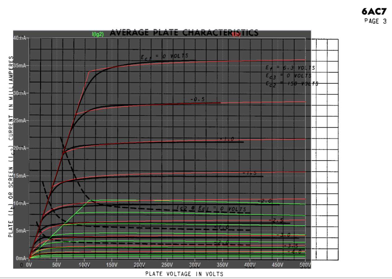

Is there pentode spice model available somewhere for 6AH6, 6AC7, 6j5p or 6j4 ? (they are all the same tube).
From: :: View topic - Updated TETRODE.TXT file
(plot of the model against the original maybe required to verify the accuracy)
.SUBCKT 6AC7 1 4 2 3
+ PARAMS: MU=49.9 EX=1.47 KG1=435 KP=162 KVB=12.3 ; KG2=415
+ CCG=11P CPG1=.015P CCP=5P RGI=2K

Noted the screen current.
.SUBCKT 6AC7 1 2 3 4
+ PARAMS: MU=49.9 EX=1.39 KG1=632 KP=162 KVB=8 VCT =0; KG2=415

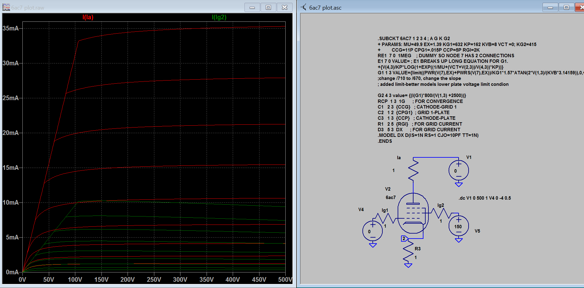

Thanks @Koonw - however, there is error message from LTSPICE: "Iteration Limit Reached" on both (changed pin order on 6AC7 but still no go)
Thanks @jazbo8 - did not show up when I searched for it, maybe my fault ...
the els-ja2dhc.zip has a typo in the 6j4pp data - 2 decimal points in X3 parameter; also needs carets ^ replaced by ** for LTSPICE, seems to workthen.

Try something simple first. Plot the curve using the attach schematic. Also ensure the pins in pentode.asy file match the model
.SUBCKT 6AC7 1 2 3 4 ; A G K G2
1=A, G=2, 3=K, 4=G2
If not you have to change the pin, either the model file or the pentode.asy and save as pentode2.asy.
  • 6ac7 plot.asc
Pin order....;)

Use the tetrode symbol included in LTspice (tetrode.asy) in your schematic.

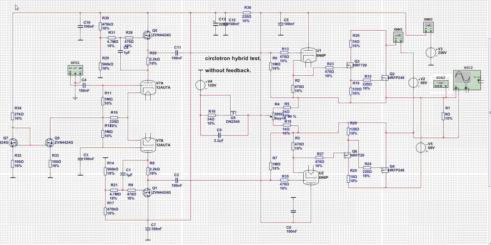

with pin order 1 4 2 3 both 6AC7 models work in simple circuits, but when complexity is higher - in my case see-saw splitter a la quad-ii - the convergence problem shows up;
so, I turned to the Ayumi model which works fine, this one from jazbo8's link (fixed the typo with extra decimal point in X3 parameter and ** instead of ^ for LTSPICE) :

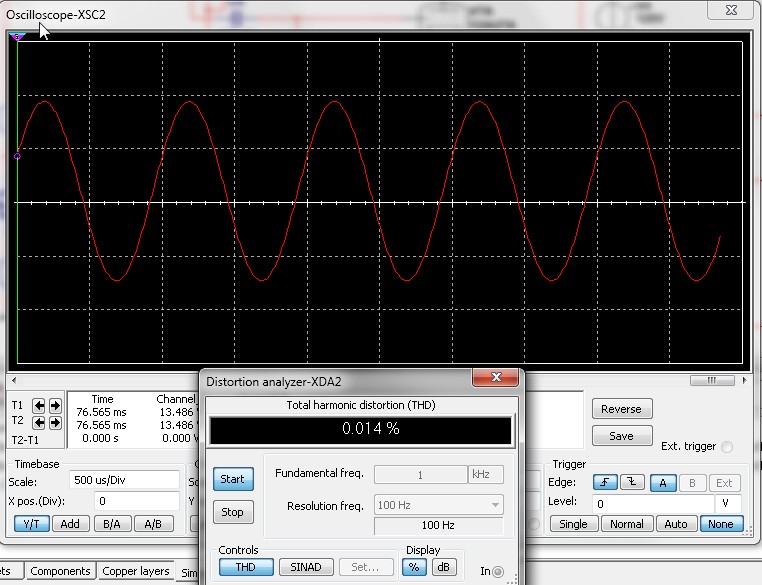

Has this one but do not now it is oke but it do work and good respons see pictures.

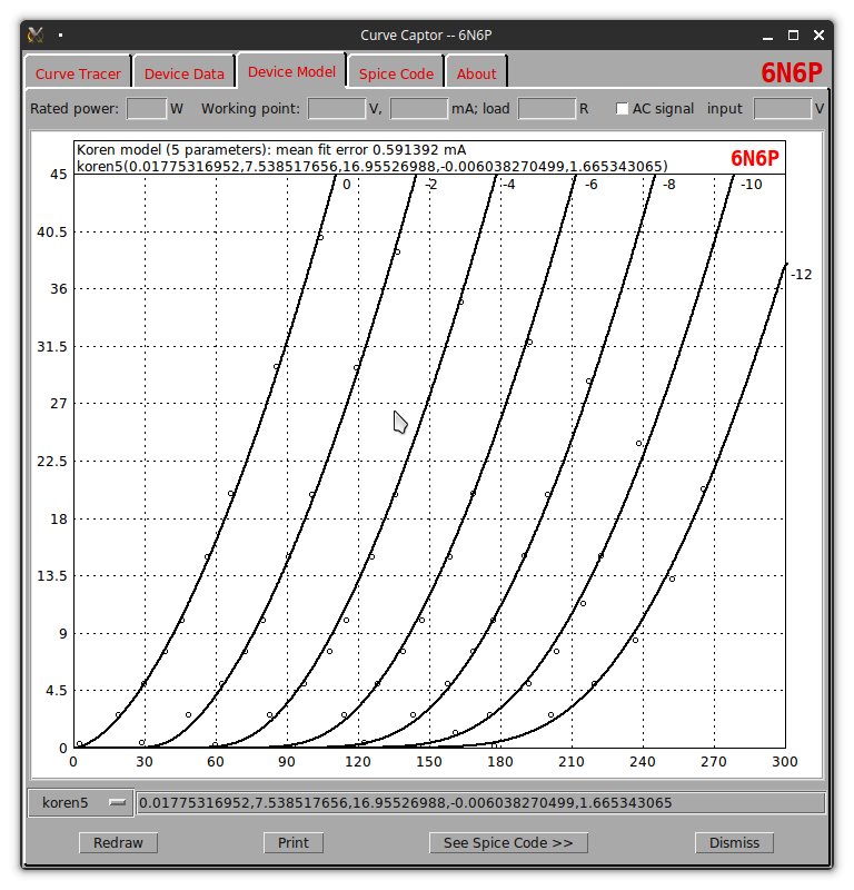

Anyone have a good model of the Russian 6N6P high Gm triode?
Code:
* 6N6P LTSpice model
* Koren model (5 parameters): mean fit error 0.591392mA
* Traced by Wayne Clay on 12/23/2016 using Curve Captor v0.9.1
* and Engauge Digitizer from Soviet datasheet

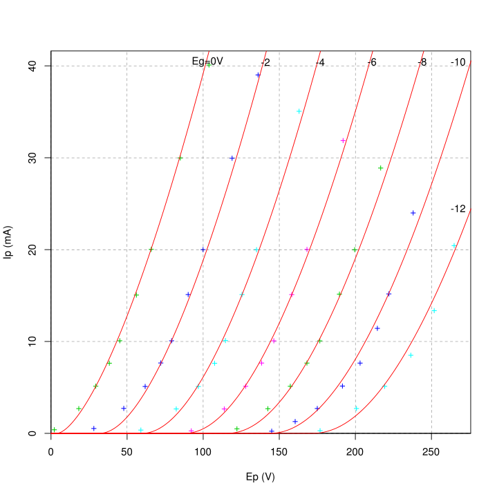

6N6P Ayumi model
Code:
* Generic triode model: 6N6P
* Copyright 2003--2008 by Ayumi Nakabayashi, All rights reserved.
* Version 3.10, Generated on Wed Mar  8 12:22:20 2017
