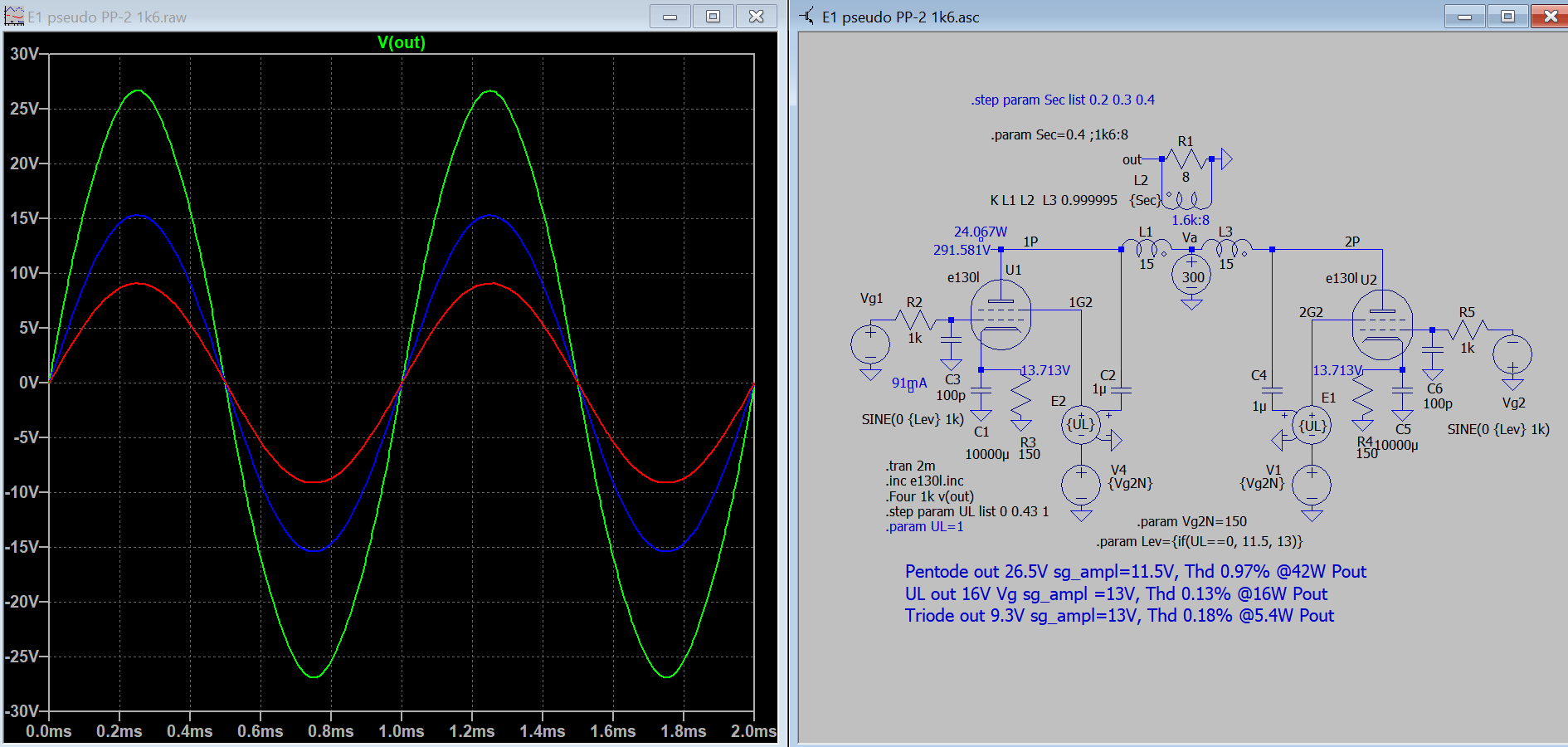

It's possible to use pseudo UL to design amp if you have Pentode model.
  • E1 pseudo PP-2 1k6.asc

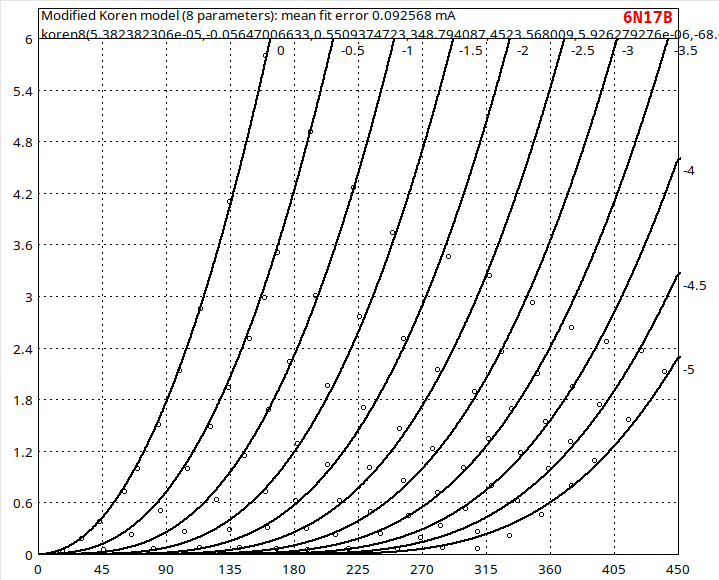

6N17B Curve Captor and Ayumi models.
Curve Captor:
Code:
* 6N17B LTSpice model
* Modified Koren model (8 parameters): mean fit error 0.0935463mA
* Traced by Wayne Clay on 10/10/2018 using Engauge Digitizer and
* Curve Captor v0.9.1 from Soviet data sheet
.subckt 6N17B  P G K
    Bp  P K  I=(8.881819189e-05m)*uramp(V(P,K)*ln(1.0+(-0.05787376447)+exp((0.7467399581)+(0.7467399581)*((266.0580109)+(3397.261292m)*V(G,K))*V(G,K)/sqrt((-0.6714542748)**2+(V(P,K)-(-63.58379404))**2)))/(0.7467399581))**(2.021894)
    Cgp G P  1.8p ; 0.2p added (1.6p)
    Cgk G K  3.6p ; 0.7p added (2.9p)
    Cpk P K  1.9p ; 0.2p added (1.7p)
    Rpk P K  1G ; to avoid floating nodes
    d3  G K  dx1
.model dx1 d(is=1n rs=2k cjo=1pf N=1.5 tt=1n)
.ends 6N17B

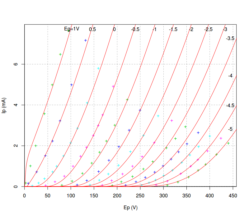

Ayumi model:
Code:
* Generic triode model: 6N17B_AN
* Copyright 2003--2008 by Ayumi Nakabayashi, All rights reserved.
* Version 3.10, Generated on Fri Oct 12 14:46:37 2018
*                Plate
*                | Grid
*                | | Cathode
.SUBCKT 6N17B_AN A G K
BGG   GG   0 V=V(G,K)+-0.35544294
BM1   M1   0 V=(0.01291172*(URAMP(V(A,K))+1e-10))**-2.0483062
BM2   M2   0 V=(0.42273692*(URAMP(V(GG)+URAMP(V(A,K))/44.708457)+1e-10))**3.5483062
BP    P    0 V=0.0043126487*(URAMP(V(GG)+URAMP(V(A,K))/105.75953)+1e-10)**1.5
BIK   IK   0 V=U(V(GG))*V(P)+(1-U(V(GG)))*0.0081637051*V(M1)*V(M2)
BIG   IG   0 V=0.0021563244*URAMP(V(G,K))**1.5*(URAMP(V(G,K))/(URAMP(V(A,K))+URAMP(V(G,K)))*1.2+0.4)
BIAK  A    K I=URAMP(V(IK,IG)-URAMP(V(IK,IG)-(0.0022176355*URAMP(V(A,K))**1.5)))+1e-10*V(A,K)
BIGK  G    K I=V(IG)
* CAPS
CGA   G    A 1.6p
CGK   G    K 2.9p
CAK   A    K 1.7p
.ENDS

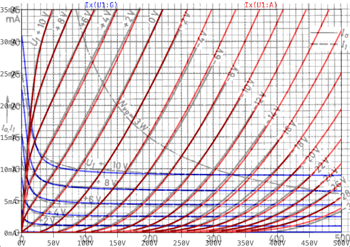

Hi Ray
There's an ECC82 triode model missed in my lib. So I had a closer look to frank's data sheet collection, whether there is a datasheet containing sufficient grid current curves. And there is!!
The Philips E82CC data sheet has really god grid data, so I created a model for you :D.
It is a long plate triode, hence also valid for Telefunken ECC82 and the like of same construction.
cheers, Adrian
