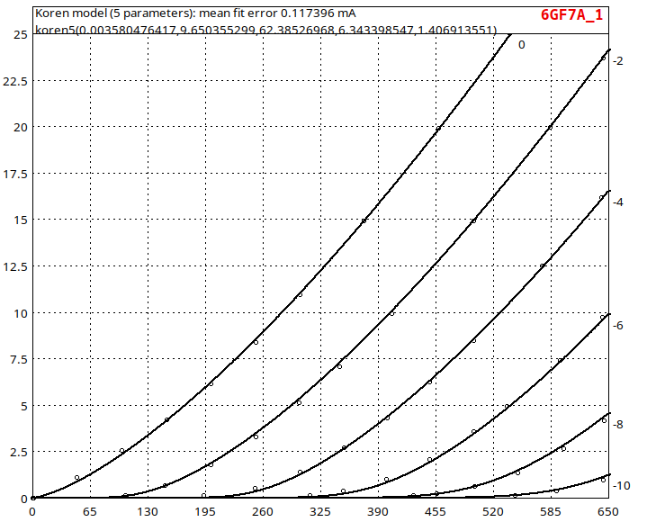

6GF7A LTspice model
Code:
* 6GF7A_1  section #1 LTSpice model
* Koren model (5 parameters): mean fit error 0.117396mA
* Traced by Wayne Clay on 09/28/2007 using Curve Captor v0.9.1
* from General Electric data sheet
.subckt 6GF7A_1  P G K
    Bp  P K  I=
+ (0.0035804764m)*uramp(V(P,K)*ln(1.0+exp((9.650355186)+
+ (9.650355186)*(62.38526966)*V(G,K)/sqrt((6.34339812k)+
+ (V(P,K))**2)))/(9.650355186))**(1.406913552)
  Cgk G K 3.1p  ; 0.7p added
  Cpk P K 0.96p ; 0.7p added
  Cgp G P 5.3p  ; 0.7p added
  Rpk P K 1G    ; to avoid floating nodes
  d3  G K dx1
.model dx1 d(is=1n rs=2k cjo=1pf N=1.5 tt=1n)
.ends 6GF7A_1

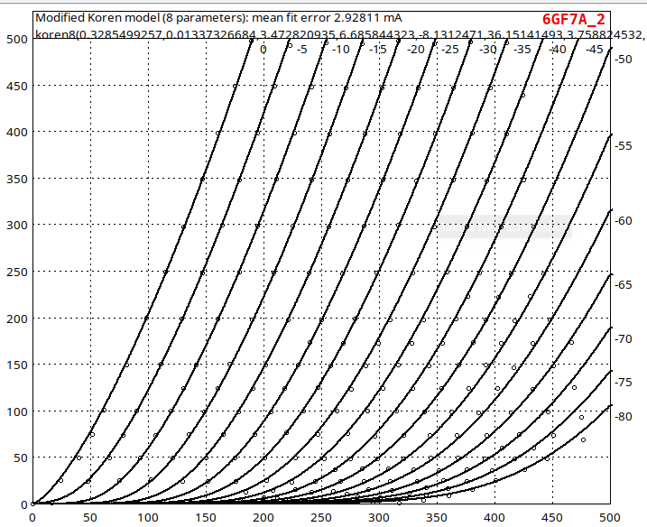

* 6GF7A_2  section #2 LTSpice model
* Modified Koren model (8 parameters): mean fit error 2.92811mA
* Traced by Wayne Clay on 10/09/2013 using Curve Captor v0.9.1
.subckt 6GF7A_2  P G K
    Bp  P K  I=
+ (0.3285499321m)*uramp(V(P,K)*ln(1.0+(0.01337326711)+exp((3.472820984)+
+ (3.472820984)*((6.685844309)+(-8.131246619m)*V(G,K))*V(G,K)/sqrt((36.15141626)**2+
+ (V(P,K)-(3.75882527))**2)))/(3.472820984))**(1.393485883)
  Cgk G K 6.7p ; 0.2p added
  Cpk P K 1.6p ; 0.2p added
  Cgp G P 9.7p ; 0.7p added
  d3  G K dx1
.ends 6GF7A_2

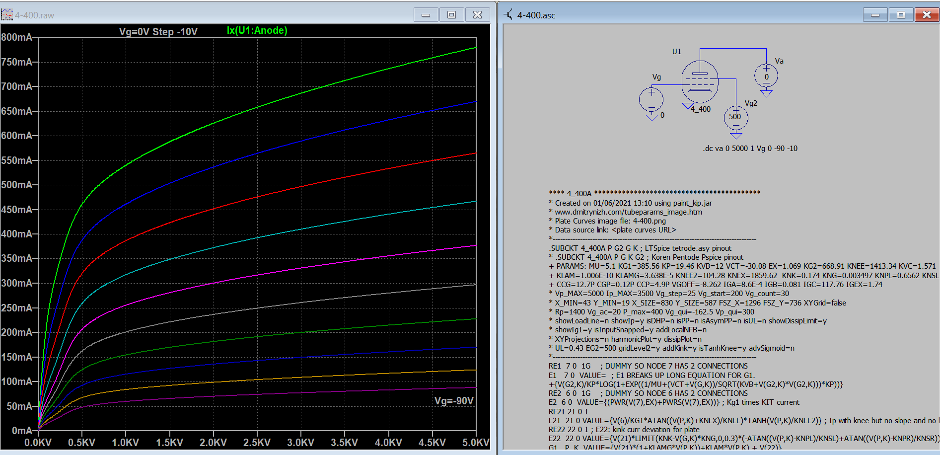

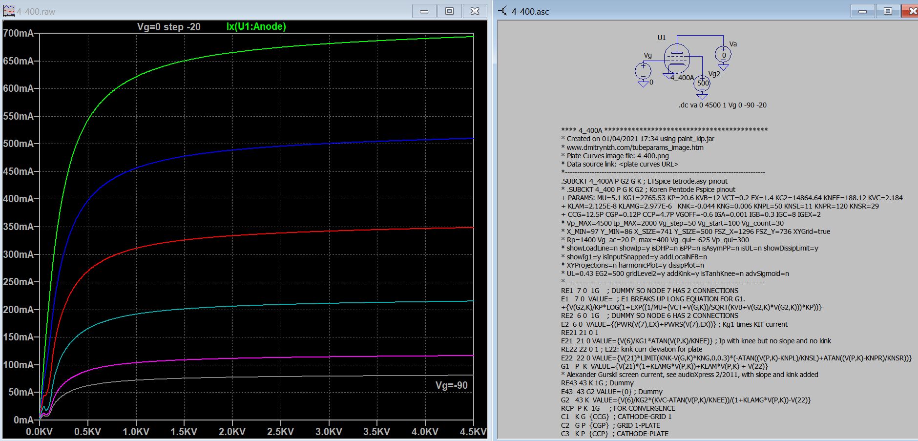

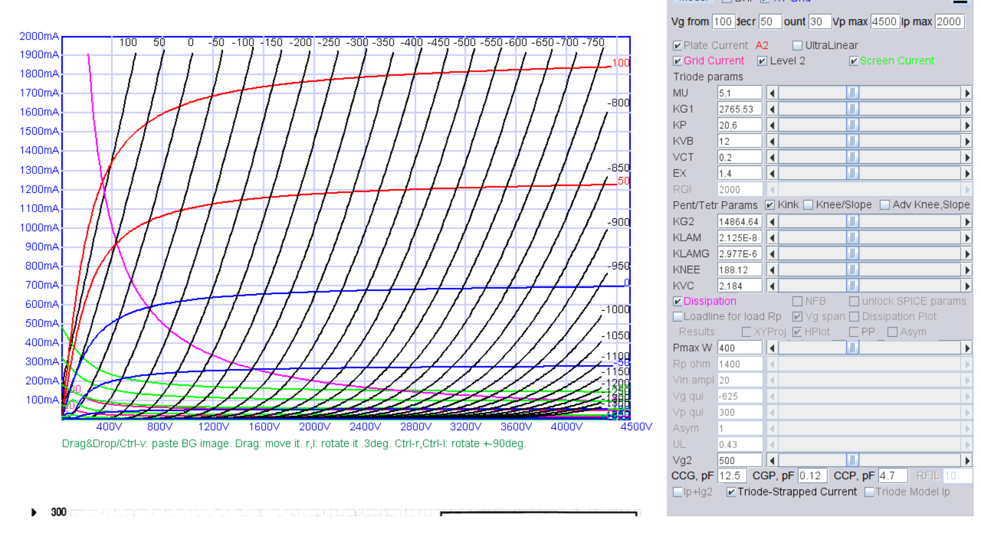

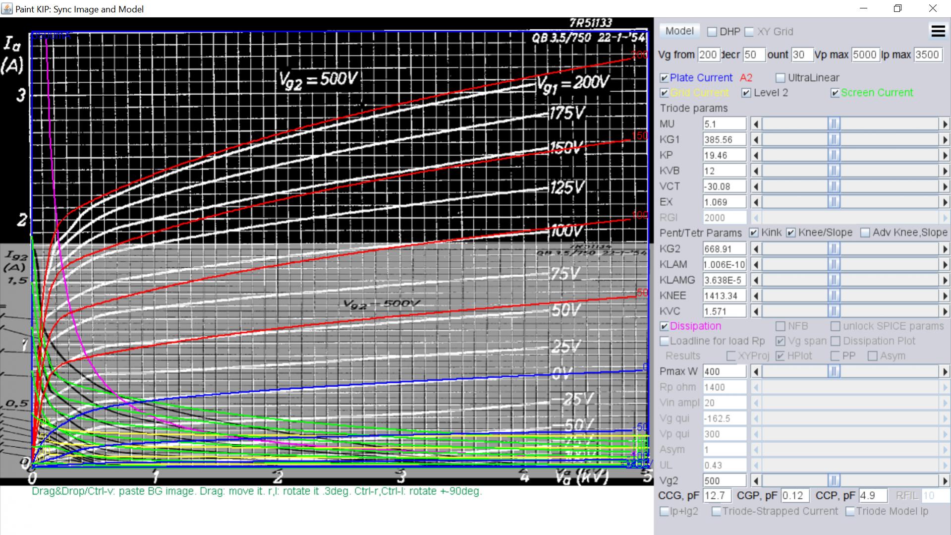

4-400a trial model.
Original curve can not be used by Paint Tool directly, only few data point are extracted, eg Vg=-90V Ia=90mA, Va=4500V. A more accurate model would be to extract more data points.

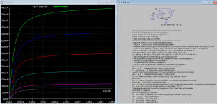

Thank you, here is the updated model for 4-400A:

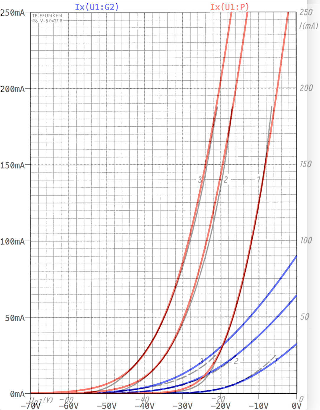

And here is the Ayumi pentode model:

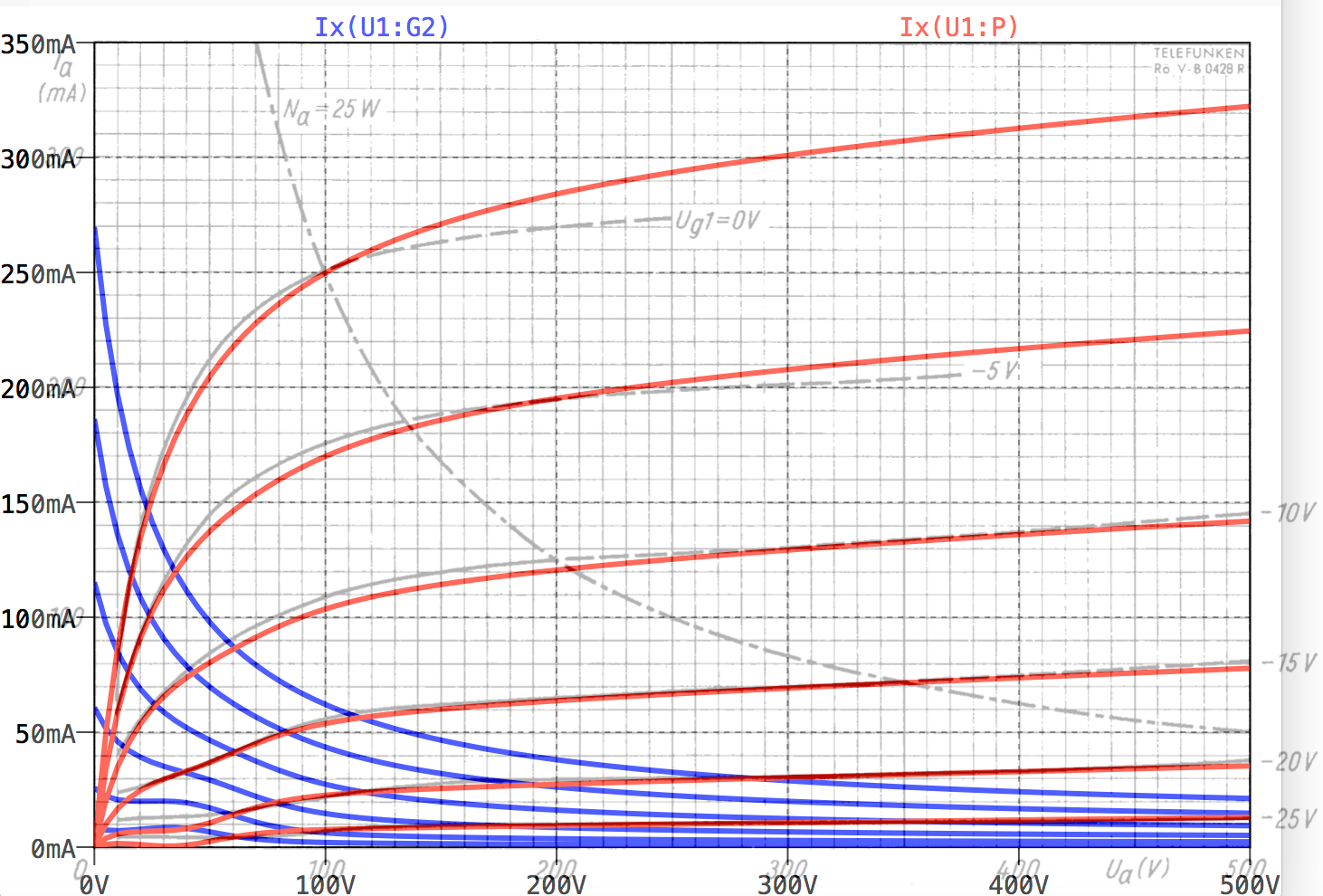

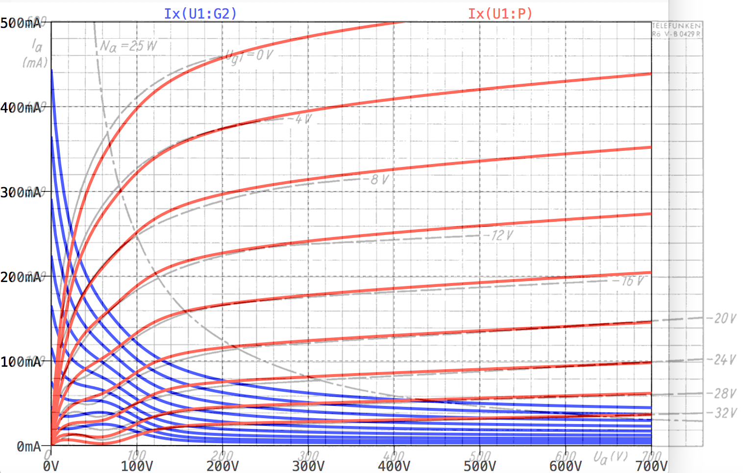

Well, my bad. Thanks for the models but I wasn't paying attention. Those are for EL34 models where grid 3 is assumed to be tied to the cathode. But I was looking for something like where all three grids, plate and cathode are included in the spice model. I have an .asy of a pentode but can't find a spice file to support it.

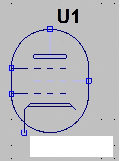

Nearly all "pentode" models are actually tetrode models so you would use the LTspice tetrode.asy symbol instead of the LTspice pentode symbol. The suppressor grid is rarely used as a true signal terminal in mainstream pentode output tubes, being tied to the cathode either internally or externally, depending on the tube. This is a detail you have to pay attention to when you construct an amplifier but is not important when running simulations.
FYI, I have never run across a pentode or beam power tetrode SPICE model that actually models the suppressor grid.

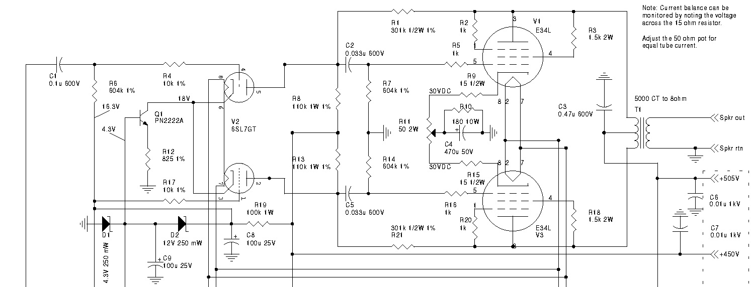

I agree with that. I ran across a Steve Bench schematic of an EL34 tube amp and he used the suppressor grid tied to the plate through a 1K resistor. To spice that I would need a pentode spice model I think? All of the other EL34 circuits I've spiced have the suppressor grid tied to the cathode internally.Here's the circuit.

You would but, as I said, I've never seen a EL34 model that models the suppressor grid. But in this amp the EL34 is operating more-or-less in triode mode. I believe the following link is where you found this schematic, and the description refers to it as a triode-mode amplifier.
Steve's Tube Pages
It would be better to model this amplifier using a triode-strapped SPICE model with the triode.asy symbol instead. For simulation purposes, you can ignore the 1k and 1.5k resistors from the suppressor and screen grids to the plate.
Here is a SPICE model for the EL34, triode strapped.
