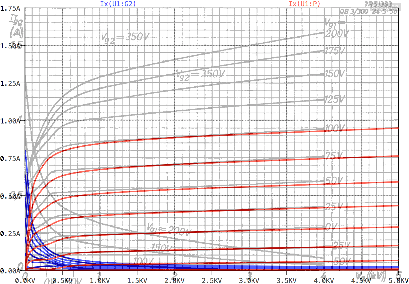

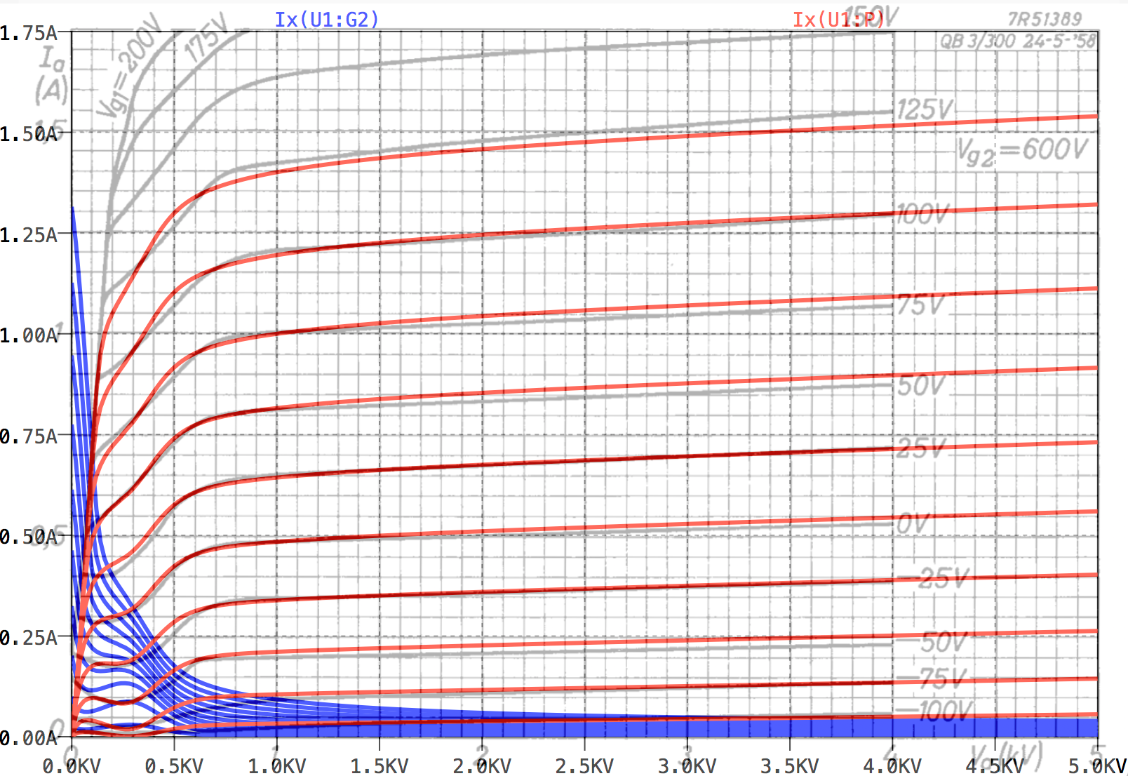

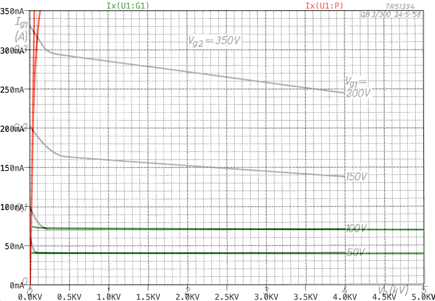

Hello.
There is someone so good to create a tube model qb3 / 300. For me there is no problem modeling triodes but pentodes are a big problem.
Thank you.
Piotr
Hi Piotr
This Tube was the hardest job ever, but now I'm satisfied with the result!
kind regards, Adrian
Code:
*QB3/300 LTspice model based on the generic tetrode/pentode model from Adrian Immler, version i4, Mar. 2020
*A version log is at the end of this file
*Params fitted to Philips datasheet by Adrian Immler, Mar. 2020
*This model is an enhancement of Adrians generic triode model to achieve tetrode/pentode behaviour.
*Hence, it is also suitable when the tetrode/pentode is "triode connected".
*Convenient for tetrodes, power beam tetrodes and g3-grounded pentodes.

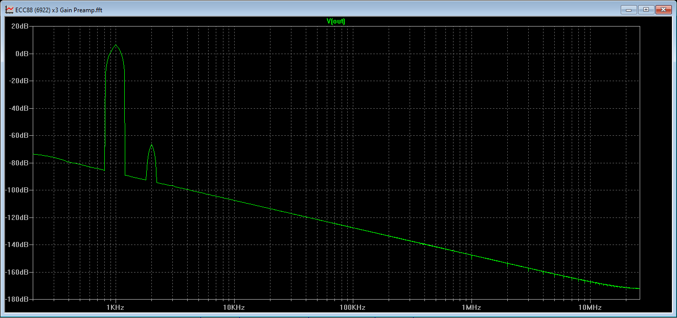

It looks like you want an inverting amp. So here is one using the E88CC (or ECC88 or 6922) that provides a gain of x3, inverting, with low THD, mostly second harmonic (see attached FFT plot). The E88CC SPICE model I used is also attached; as before, I store these in a "User" folder so you will need to modify the path to this file on your own computer.
This particular tube is very linear and works well at relatively low plate voltages. I've used 200 volts for the plate supply instead of the 100 volts you used in your schematic but hopefully you have some flexibility here.
Will this work?

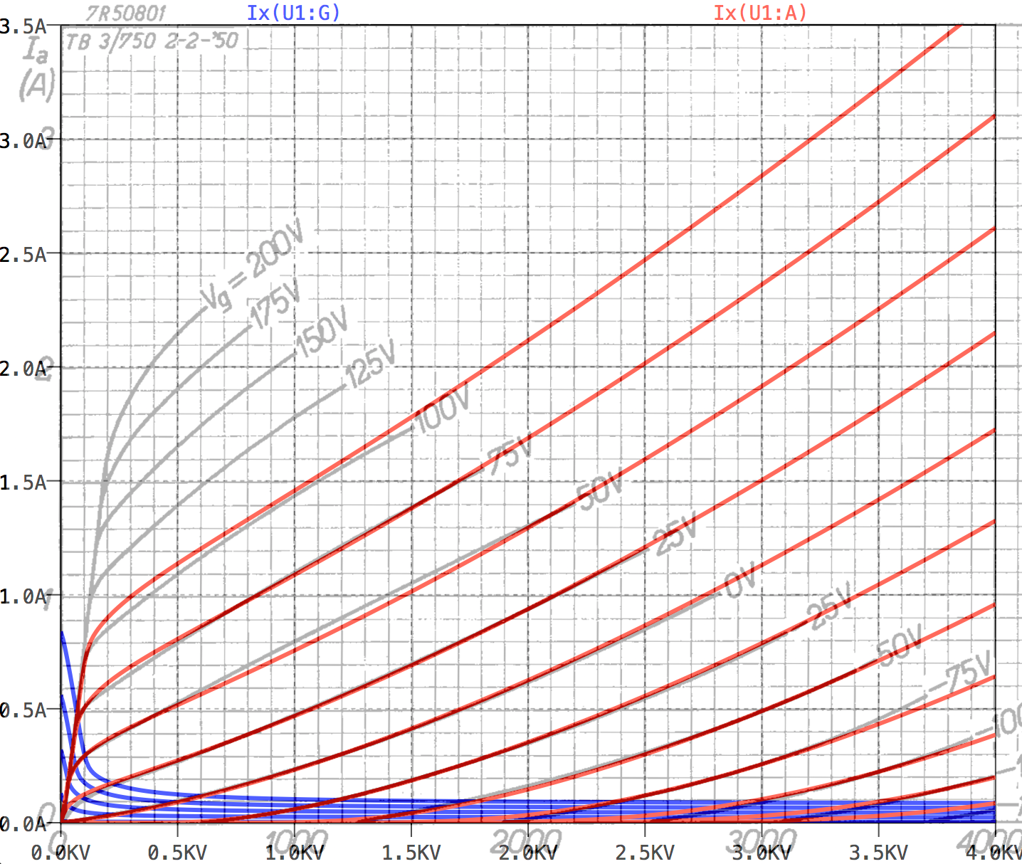

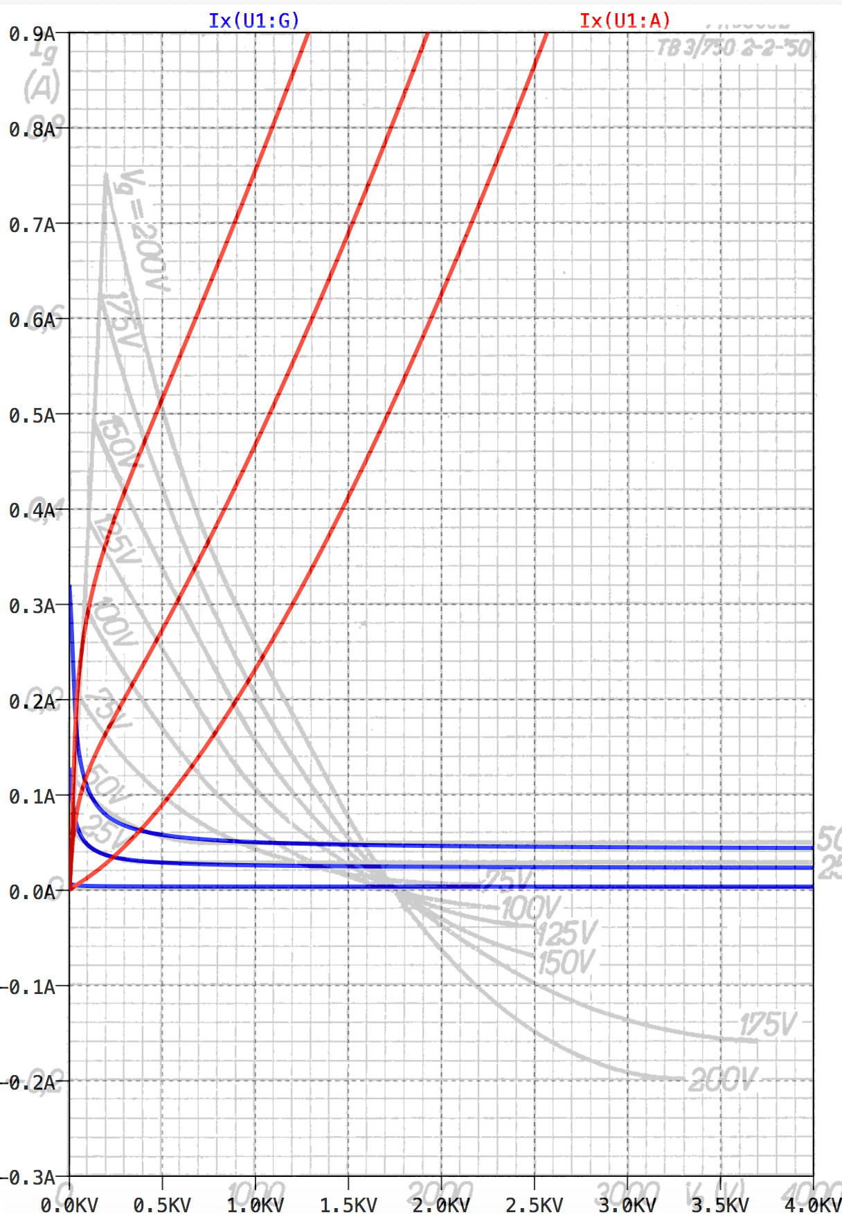

Since we are at big bottles now can you check TB3-750 triode?
Hi panos29
I reale didn't know that a QB3-300 is the same as a 4-125
Here your TB3-750 model.
Please be aware that this model is valid up to Vg=50V. For higher grid voltages, it delivers wrong grid currents.
Code:
*TB3-750 LTspice model based on the generic triode model from Adrian Immler, version i4
*Params fitted to the Philips data sheet by Adrian Immler, Mar. 2020
*The high fit quality is presented at adrianimmler.simplesite.com
*The potential of the negative heater pin is refered as "0V" for the graphs.
*History's best of tube decribing art (plus some new ideas) is merged to this new approach.
*@ neg. Vg, Ia accuracy is similar to Koren or Ayumi models.
*@ small neg. Vg, the "Anlauf" current is considered.
*@ pos. Vg, Ig and Ia accuracy is on a unrivaled level.
*This offers new simulation possibilities like bias point setting with MOhm grid resistor,
*Audion radio circuits, low voltage amps, guitar distortion stages or pulsed stages.

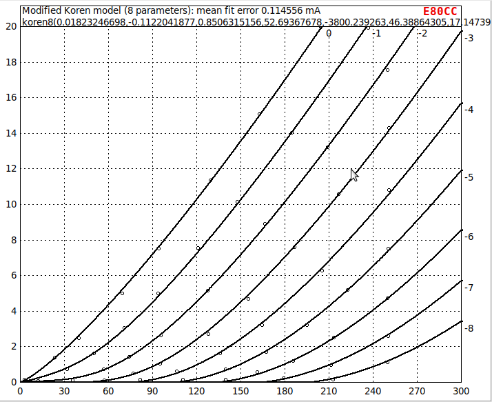

Has anyone got a E80CC LTSpice model? If so, could he share it? Thanks.
Code:
* E80CC LTSpice model
* Modified Koren model (8 parameters): mean fit error 0.114556mA
* Traced by Wayne Clay on 05/24/2018 using Engauge Digigtizer and
* Curve Captor v0.9.1 from Philips data sheet
.subckt E80CC P G K
Bp P K I=
+ (0.01823246698m)*uramp(V(P,K)*ln(1.0+(-0.1122041877)+exp((0.8506315156)+
+ (0.8506315156)*((52.69367678)+(-3800.239263m)*V(G,K))*V(G,K)/sqrt((46.38864305)**2+
+ (V(P,K)-(17.14739421))**2)))/(0.8506315156))**(1.240091528)
Cgp G P 3.8p ; 0.7p added (3.1p)
Cgk G K 3.1p ; 0.7p added (2.4p)
Cpk P K 0.65p ; 0.2p added (0.45p)
Rpk P K 1G ; to avoid floating nodes
d3 G K dx1
.model dx1 d(is=1n rs=2k cjo=1pf N=1.5 tt=1n)
.ends E80CC
