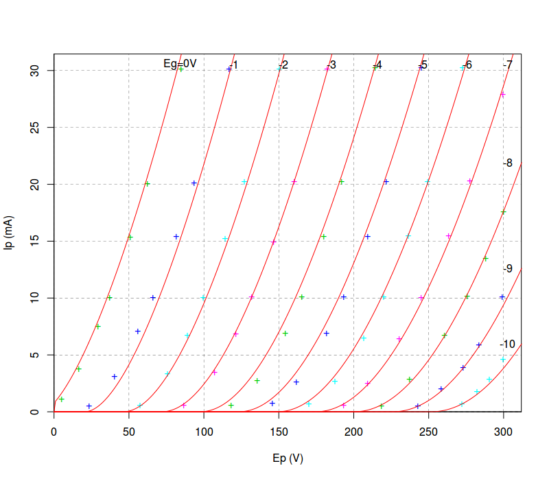

Hello guys, again,
it has turn out, that i've mistakenly thought, that i've got LTspice model for tube E88CC.
After second check, i've seen, that is ECC88.
Would it be possible to post that E88CC Spice model?
This is the last one, i swear (for now)
Code:
* Generic triode model: E88CC_Te_AN (Tesla)
* Copyright 2003--2008 by Ayumi Nakabayashi, All rights reserved.
* Version 3.10, Generated on Wed Dec 26 22:45:53 2018
* Plate
* | Grid
* | | Cathode
.SUBCKT E88CC_AN A G K
BGG GG 0 V=V(G,K)+0.29815813
BM1 M1 0 V=(0.0087052398*(URAMP(V(A,K))+1e-10))**-0.45632922
BM2 M2 0 V=(0.76674211*(URAMP(V(GG)+URAMP(V(A,K))/26.795113)+1e-10))**1.9563292
BP P 0 V=0.0068223047*(URAMP(V(GG)+URAMP(V(A,K))/34.946708)+1e-10)**1.5
BIK IK 0 V=U(V(GG))*V(P)+(1-U(V(GG)))*0.0039636404*V(M1)*V(M2)
BIG IG 0 V=0.0034111523*URAMP(V(G,K))**1.5*(URAMP(V(G,K))/(URAMP(V(A,K))+URAMP(V(G,K)))*1.2+0.4)
BIAK A K I=URAMP(V(IK,IG)-URAMP(V(IK,IG)-(0.0037060676*URAMP(V(A,K))**1.5)))+1e-10*V(A,K)
BIGK G K I=V(IG)
* CAPS
CGA G A 1.4p
CGK G K 3.1p
CAK A K 0.5p
.ENDS

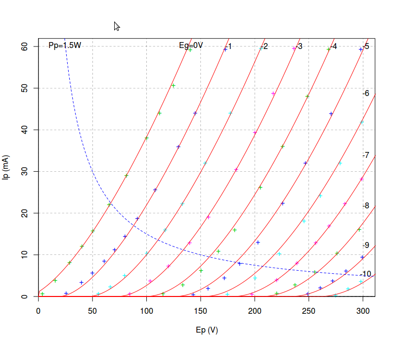

6922 models
Here are two 6922 models I cooked up some time ago from the Raytheon datasheet for your simulation pleasure(s).
Code:
* 6922 LTspice model
* Modified Koren model (8 parameters) mean fit error 0.333943mA
* Traced by Wayne Clay on 05/29/2016 using Curve Captor v0.9.1
* and Engauge Digitizer from Raytheon data sheet (low current region)
.subckt 6922 P G K
Bp P K I=
+ (0.08796398672m)*uramp(V(P,K)*ln(1.0+(-0.2246171356)+exp((6.356515287)+
+ (6.356515287)*((34.07615547)+(302.8072861m)*V(G,K))*V(G,K)/sqrt((41.2072838)**2+
+ (V(P,K)-(5.251577024))**2)))/(6.356515287))**(1.317210472)
Cgp G P 2.3p ; 0.7p added
Cgk G K 4.6p ; 0.7p added
Cpk P K 2.15p ; 0.2p added
Rpk P K 1G ; to avoid floating nodes
d3 G K dx1
.model dx1 d(is=1n rs=2k cjo=1pf N=1.5 tt=1n)
.ends 6922

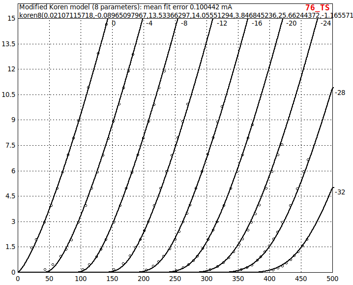

76 spice model
Code:
* 76_TS LTSpice model
* Modified Koren model (8 parameters): mean fit error 0.100442mA
* Traced by Wayne Clay using PlotDigitizer and Curve Captor v0.9.1
* from Tung-Sol data sheet
.subckt 76_TS P G K
Bp P K I=
+ (0.02107115629m)*uramp(V(P,K)*ln(1.0+(-0.08965100473)+exp((13.53366263)+
+ (13.53366263)*((14.05551312)+(3.84684871m)*V(G,K))*V(G,K)/sqrt((25.662436)**2+
+ (V(P,K)-(-1.165574625))**2)))/(13.53366263))**(1.323073242)
Cgp G P 3.0p ; 0.2p added (2.8p)
Cgk G K 3.8p ; 0.2p added (3.6p)
Cpk P K 2.8p ; 0.2p added (2.6p)
Rpk P K 1G
d3 G K dx1
.ends 76_TS

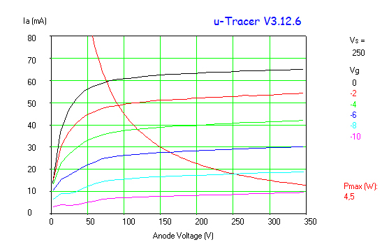

The EL3 is an audio output pentode from 1938. Ten years later the updated version was the EL3N that was functionally equivalent to the EL33 that was fitted with a standard IO base cap. I found data sheet of the EL33 Mullard, I hope that could help....all the best
Hi Pillo69, hi kissabout2002

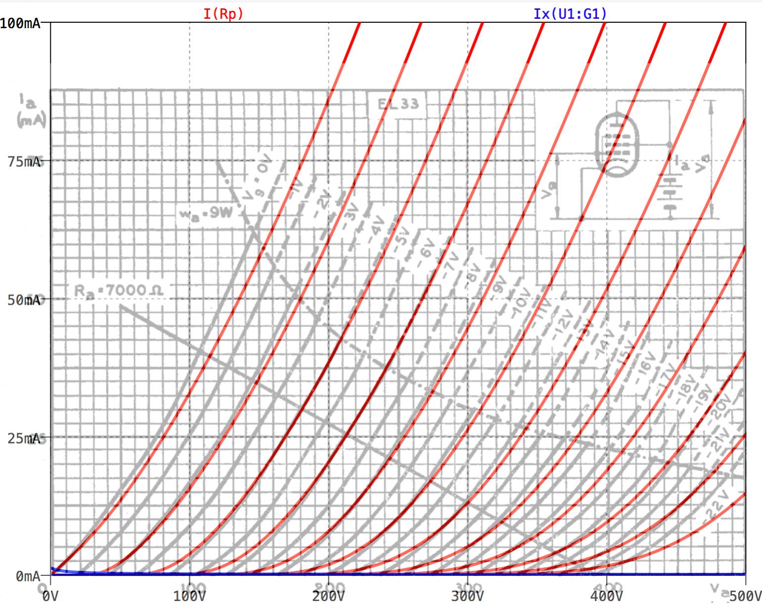

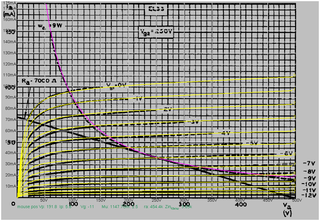

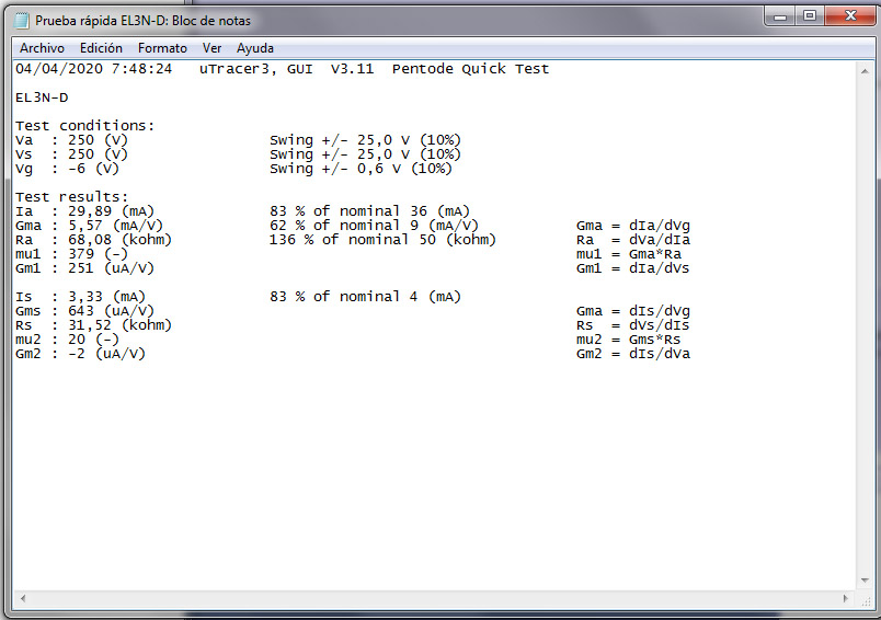

Thanks for uTracer curves and EL33 data sheet.
While the uTracer curve tells us Ia=61mA @ Va=100V, the data sheet says it should be 97mA. So that means that the given EL3N sample seems to have a quite reduced emission capability. Perhaps it has run already a long time?
How ever:
@ Pillo69, what would you prefer, a spice model according your uTracer curve or according the EL33 data sheet?
If uTracer, may you do additional measurements for the grid currents?
all the best, Adrian
How ever:

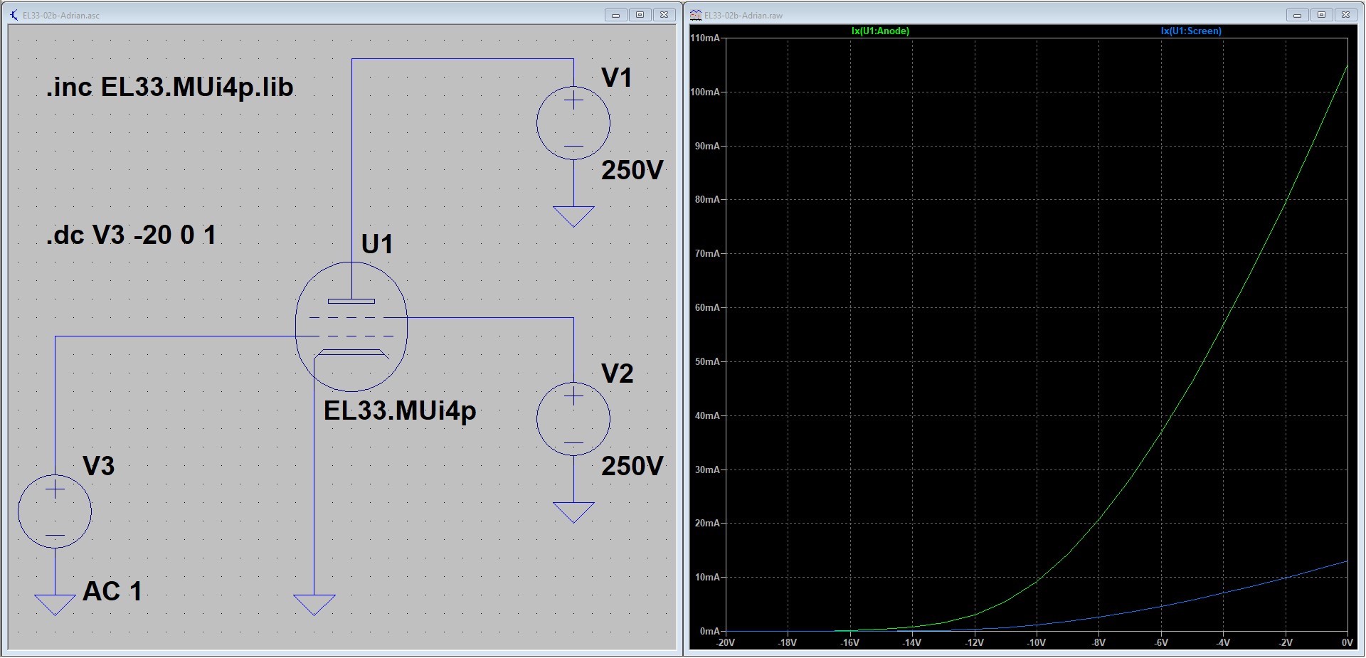

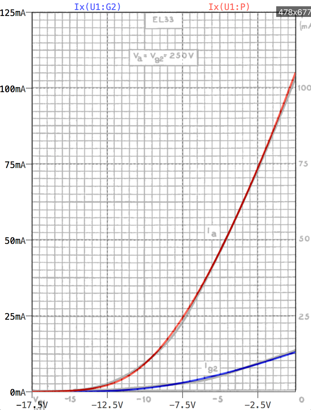

Hi Pillo69, hi Zung
here is my EL33 model. It turned out that my model can't fit both modes well (standard mode and triode connected), so I decided to optimize for standard mode.
And Ig1 behavior is estimated by comparison with other power pentodes, so don't expect to much accuracy for Ig1.

Hi Adrian,
Sorry disturb you but I try as an exercise to model this tube EL33, can you please check when you can no hurry this model, because I do not know if is right or not, I know you are very prepared in this matter....all the best

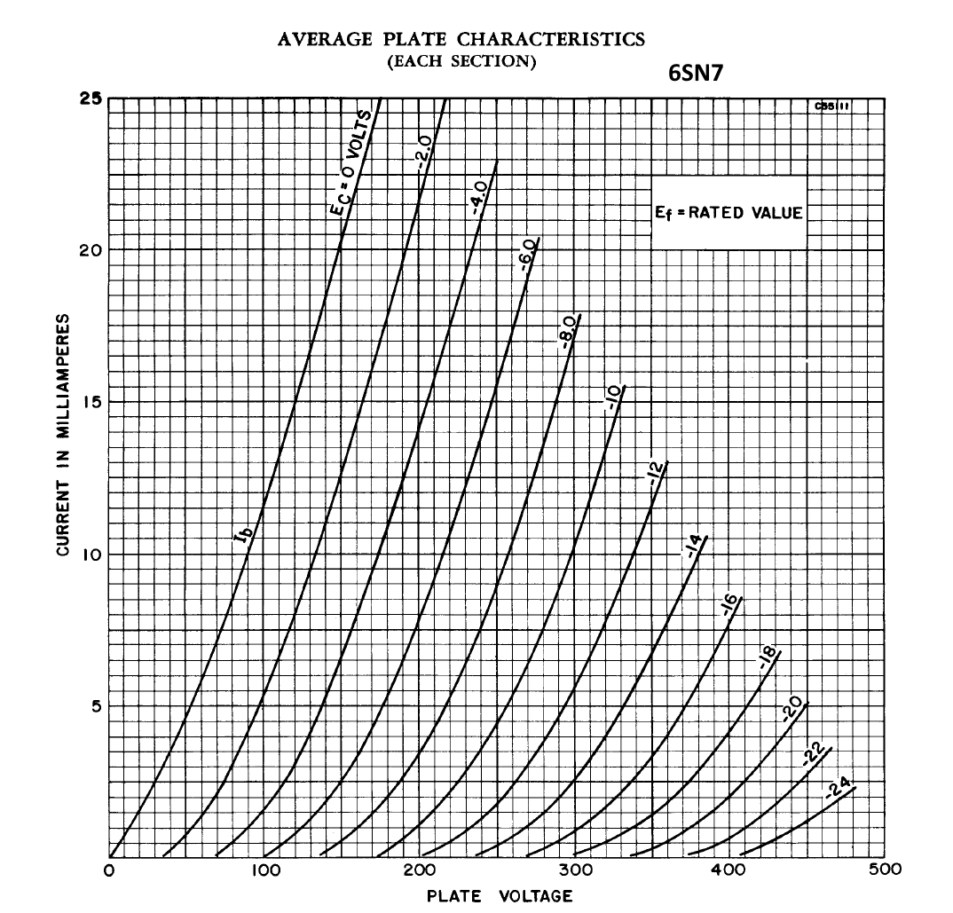

Hi Adrian. I have an interesting problem. I am running two 6SN7s in parallel (a-a, g-g, k-k). I am also using a Constant Current Source for the plate load. I notice that when I move the bias point away from the 0Volts end of the curves, the harmonic distortion becomes much less. This seems to me to be counter-intuitive, but that's the way the sim turns out. I am at -9 Volts in this simulation, using Ayumi's model. It is also true for just one single half of the 6SN7, but better distortion figures for two in parallel. And with one tube, I run up against the supply voltage sooner, which is like a brick wall on the sine wave.Gern gscheh!
("you are welcome!" in Swiss German)
What I would really like to see is a set of curves for the two paralleled triodes, as if it were one single tube. Is there any way that I could draw out this theoretical graph? It would be very interesting.
