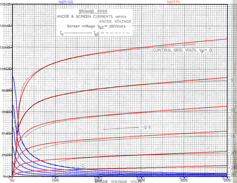

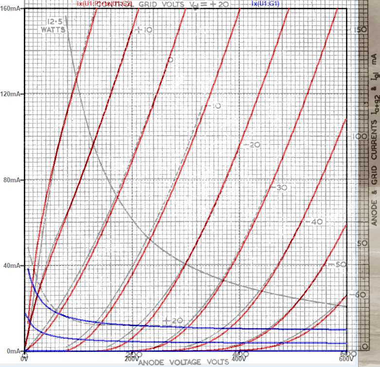

Looking for 6BW6 tube
Hi panos29
I'm happy to have found some rudimentary g1 current curves in the Brimar data sheet from 1952 - so I will start to develop a 6BW6 model, but it will need some days.
all the best, Adrian
Hi panos29
Thank you dear! Actually I have a lot of cv4043 which are similar to 6bw6 and would love to use these in some way!
Hi panos29
here you go...
My freshly baked 6BW6 model!
here you go...

I whipped up a little test circuit using your 6BW6 model and everything worked great. No error messages, got a good sine wave out, all good. Thanks!
