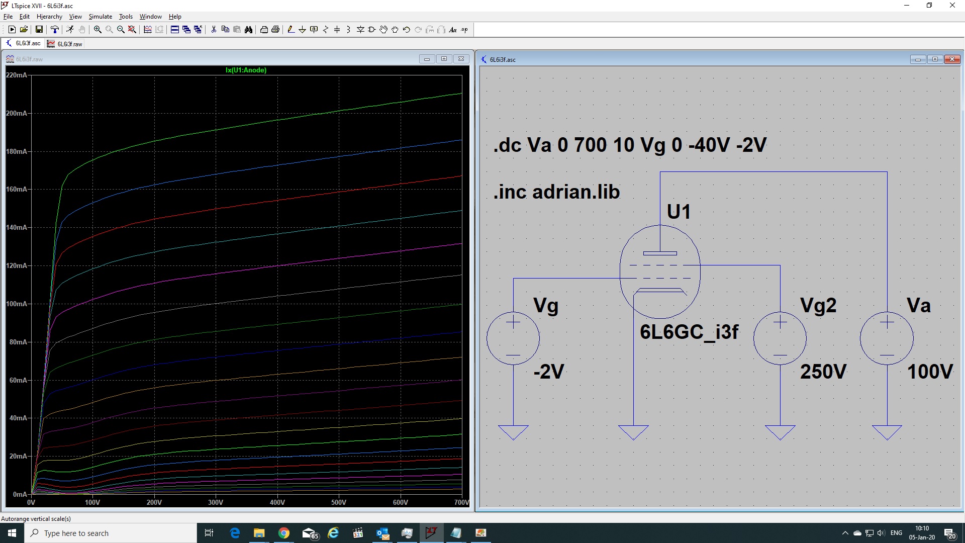

Hi all
Please be aware that I discovered this week a major bug in my generic pentode spice models with version i3 and i4. All simulations with this models delivers correct results only in case of grounded cathodes. So no self-bias, cathode follower and the like possible!
But I have now fixed versions _i3f and _i4f to offer . (f means "fixed")
Here the code of the fixed 6L6GC model:
Here the code of the fixed 1j29b model:
all the best, Adrian

* i3f : Major Bug Fixed. Some Grid/Plate voltages has been refered to GND instead of cathode

I also have the error
After that I still get results that resemble the GE plate curves (Va = 300V, Vg2 = 250V, Ia = 190mA instead of 200mA).
I'm running LTspice XVII(x64) Dec 3 2019 on Windows 10.

Rongon, would you do a test for me? Would you deceive x and y in my smin-function and tell me what happens?
I'd be happy to. How should I do that?
I'm using the older LTspice IV on Windows 10.
Would it help if I upload the .asc file?
FWIW, it's a push-pull amp using cathode bias of the 6L6s.

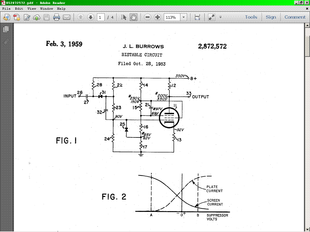

Just from an academic standpoint, I would love to see that model as well! What a neat tube!
I want to use a 6Z10 or 6T10 compactron tubes like a standard 555IC using this concept.
A kind of Schimitt trigger using suppressor to screen resistive coupling. Those tubes include a pentode with the suppressor tied to a pin in the base, used as FM detector, capable of doing the hysteretic part of the IC.

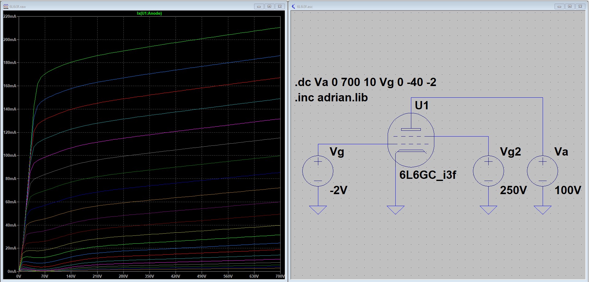

Hi rongon,
I have breaking news regarding the warnings due to my smin-function!
When I run your simulation on my Mac, everything is ok.
After installing LTspice on my win10 Laptop (actually intended for my job only...) I can now reproduce the warnings. After some playing, I have now a clear diagnosis:
In self defined functions (.func), LTspice for win don't like any parameter called x! (while LTspice for Mac does not have this issue.)

yes, your proposed code will work - but be aware that it is sufficient to rename the x only. The y does not cause any problems/warnings.
