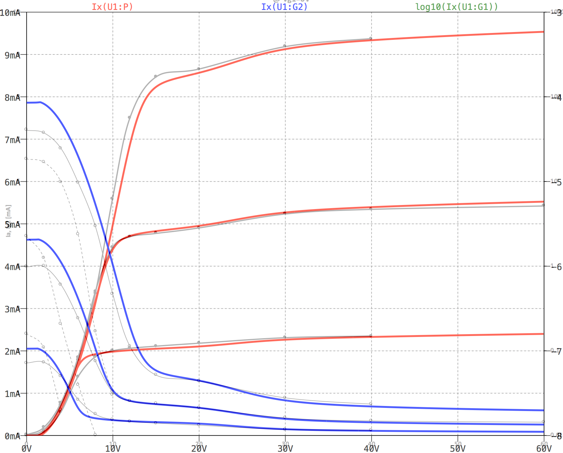

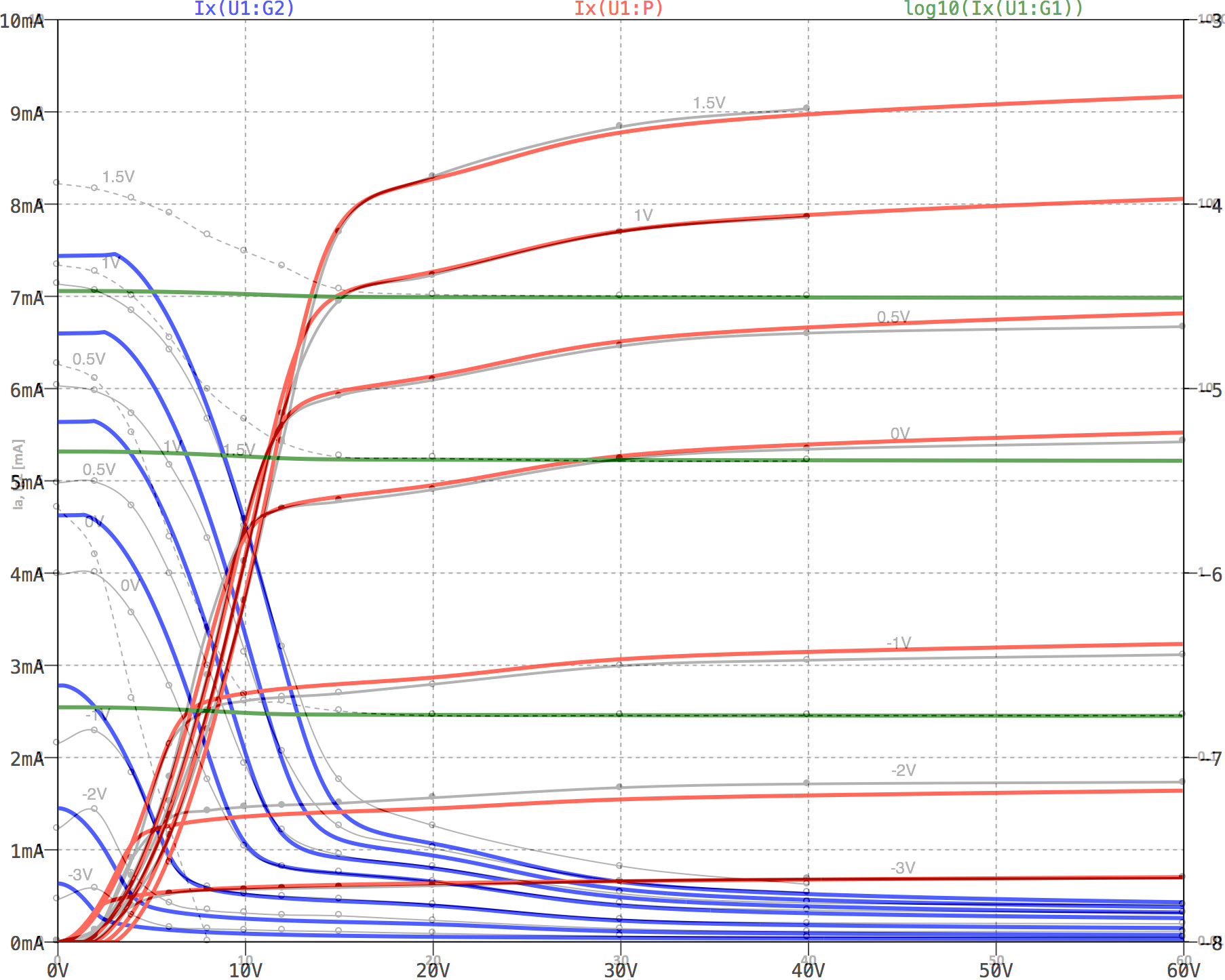

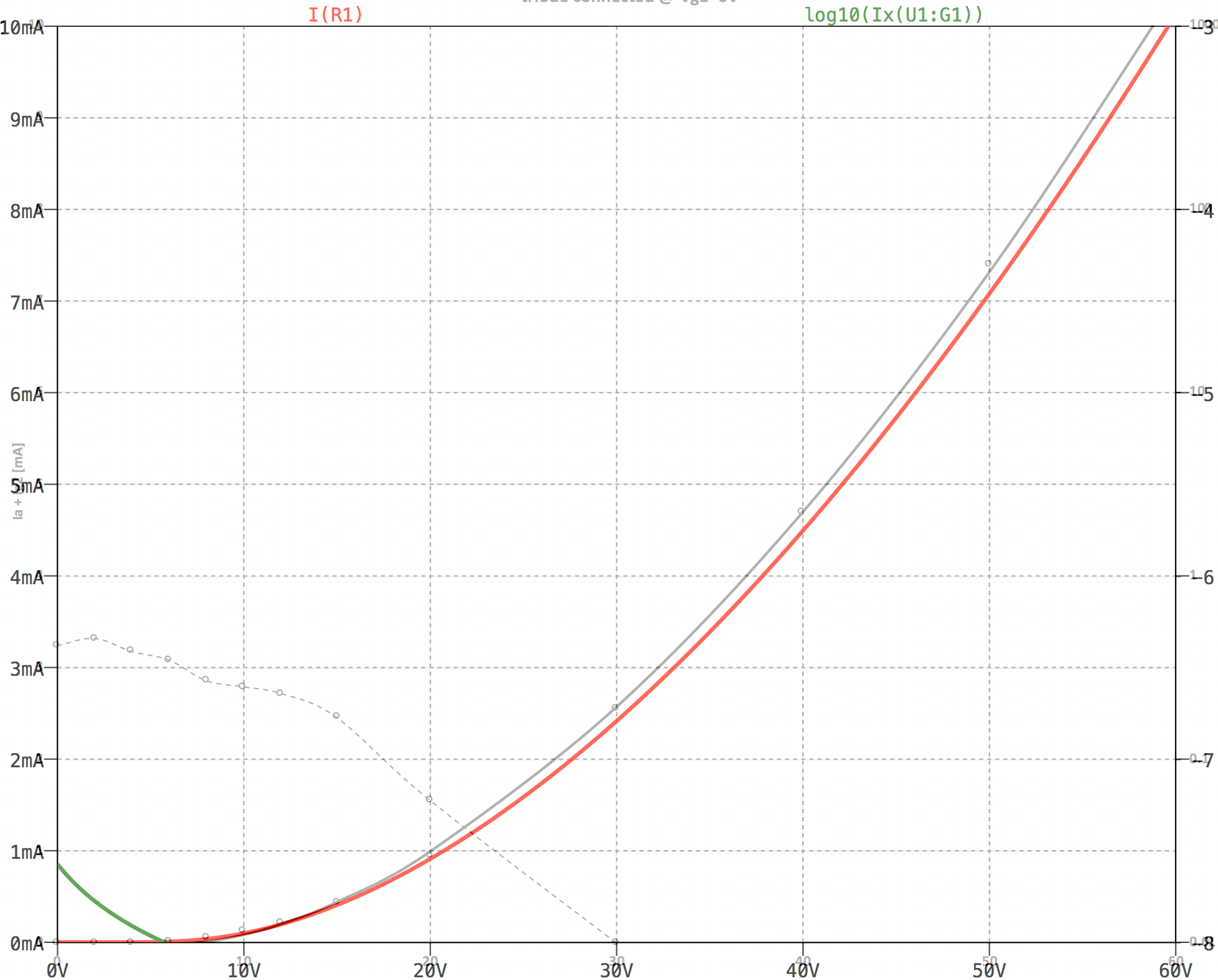

1sh29b model finished!
Hi artosalo
It took some time to get my 1sh29b spice model on a satisfying level - but now I'm happy with the result!
As in every development, there still remains some improvement potential, e.g. the Ig1 raise at very low Va is still not addressed. However, I'm sure my 1sh29b model is currently the best approach worldwide :D.
all the best, Adrian
Code:
*1sh29b LTspice model based on the generic tetrode/pentode model from Adrian Immler, version4, Nov. 2019
*Important assumptions: both heaters are in parallel, heater- = GND, g3 is connected to GND
*A version log is at the end of this file
*Params fitted to measured data from a sample by Adrian Immler, Nov. 2019
*fit graphs see [URL="https://www.diyaudio.com/forums/tubes-valves/243950-vacuum-tube-spice-models-213.html"]Vacuum Tube SPICE Models[/URL]
*This model is an enhancement of Adrians generic triode model to achieve tetrode/pentode behaviour.
*Hence, it is also suitable when the tetrode/pentode is "triode connected".
*Convenient for tetrodes, power beam tetrodes and g3-grounded pentodes.
*Copes secondary emission effect!
*                 plate (in this model, "anode" means the internal virtual triode anode)
*                 | grid2
*                 | |  grid1
*                 | |  |  cathode
.subckt 1sh29b_i4 P G2 G1 K
.params
*Parameters for the space charge current @ Vg <= 0
+ mu1 = 12      ;Determines the voltage gain @ constant Ia
+ ks = 1k20     ;Permeance factor. Has to be readjusted if xs is changed
+ Vg0 = -0.75   ;Offsets the Ia-traces on the Va axis. Electrode material's contact potential
+ kp = 37       ;Mimics the island effect
+ xs = 1.68     ;Determines the curve of the Ia traces. Typically between 1.2 and 1.8
*Parameters for an optional space charge current reduction @ Vg > 0
+ kIsr = 0.16   ;Va independable Is reduction, a function of Vg1
+ Rg1i = 100    ;Internal grid1 resistor which causes an extra Is drop when Va approaches zero.
*Parameters for assigning the space charge current to Ia and Ig @ Vg > 0 and small Va
+ kB1 = 0.3     ;Describes how fast Ia_virtual drops to zero when Va_virtual approaches zero.
+ radl = 500    ;Differential resistance for the Ia emission limit @ very small Va and Vg > 0
+ tsh = 8       ;Ia transmission sharpness from 1th to 2nd Ia area. Keep between 3 and 20. Start with 20.
+ xl = 1.8      ;Exponent for the emission limit
+ Vctl = -1 f=-0.85;Offsets the Ia emission limit trace on the Va axis. f=related Vg1 koeff.
*Parameters of the grid-cathode vacuum diode
+ kg1 = 6k      ;Inverse scaling factor for the Va independent part of Ig (caution - interacts with xg!)
+ Vctg1 = -1.3  ;Offsets the log Ig-traces on the Vg axis. Electrode material's contact potential
+ xg1 = 1.9     ;Determines the curve of the Ig slope versus (positive) Vg and Va >> 0
+ VT = 0.127    ;Log(Ig) slope @ Vg<0. VT=k/q*Tk (cathodes absolute temp, typically 1150K)
*Parameters for the caps
+ cg1p  = 5f    ;according datasheet
+ cg1All= 5p    ;according datasheet
+ CpAll = 3p    ;according datasheet
+ Cpk  = 28f    ;according datasheet
*Parameters to enhance the triode model to a pentode model
+ mu2 = 80        ;1/mu2 is the fraction of Vp which together with Vg2i builds the virtual Triode-Anode Voltage
+ kB2 = 0.8       ;Describes how fast Ip drops to zero when Vp approaches zero.
+ Rg2i = 900      ;Internal grid2 resistor. Causes an Is reduction when Ig2 increases while Vp drops
+ fr2 = 25m       ;determines the residual ig2 fraction @ high Va values
+ ftfr2 = 30m     ;if fr2 showes a Vg2 dependancy, this can be considered with this parameter
*Parameters to mimic the secondary emission (inspired from Derk Reefmans approach)
+ co = 2          ;decribes the crossover region (Ise drop when Va increase). between 0 and 9
+ Vse=18   a=0    ;Va where the sec. emission is strongest. a=related Vg1 coefficient
+ Ise0=0m20 b=-70u;sec. emission peak current @ Vg=0. b=related Vg1 coefficient
+ Vg2ref = 45     ;Vg2 where the following coeffficients has no influence to the emission effect:
+ c = 0           ;Vg2 coefficient of a
+ d = 40m         ;exp Vg2 coefficient of Ise0
+ e = 0           ;Vg2 coeff. of b
*Calculated parameters
+ kl = pow(1/(radl*xl*Ild**(1-1/xl)),-xl) ;Reduces the xl influence to the Ia slope @ small Va
+ Ild = sqrt(radl)*1m ;Current where the limited anode a.c. resistance is set according to radl.
*Space charge current model
Bggi GG1i 0 V=v(G1i,K)+Vg0 - v(G1)*(1-1/(1+kIsr*max(0,v(G1)))) ;Effective internal grid voltage.
Bahc Ahc 0 V=uramp(v(P,K)/mu2+v(G2i,K)) ;voltage of the virtual triode anode, hard cut to zero
Bst St 0 V=max(v(GG1i)+v(Ahc)/(mu1), v(Ahc)/kp*ln(1+exp(kp*(1/mu1+v(GG1i)/(1+v(Ahc))))));Steering volt.
Bs Ai K I=1/ks*pow(v(St),xs) ;Langmuir-Childs law for the space charge current Is
*Anode current limit @ small Va
.func smin(x,y,n) {pow(pow(x + 1f, -n)+pow(y+1f, -n), -1/n)} ;Min-function with smooth trans.
Ra A Ai 1
Bpl G2i P I=i(Rp) - smin(1/kl*pow(v(P,K)+min(0,Vctl+f*v(G1)),xl),i(Rp),tsh);Ip emission limit
*Grid model
Rg1i G1 G1i {Rg1i} ;Internal grid resistor for "Ia-reduction" @ Vg > 0
.func Ivd(Vvd, kvd, xvd, VTvd) {1/kvd*pow(VTvd*xvd*ln(1+exp(Vvd/VTvd/xvd)),xvd)} ;Vacuum diode function
Bg1vd G1 K I=Ivd(v(G1,K)+Vctg1-1m*sqrt(v(Ahc)), kg1, xg1, VT) ;Grid-cathode vacuum diode
Bg1r G1i Ai I=ivd(v(GG1i),ks, xs, 0.8*VT)/(1+kB1*v(Ahc));Is reflection to grid when Va appr. zero
Bs0 Ai K I=ivd(v(GG1i),ks, xs, 0.8*VT) - 1/ks*pow(v(GG1i),xs) ;Compensates neg Ia
*@ small Va and Vg near zero
*additional model parts necessary for a pentode
Rg2i G2 G2i {Rg2i}
Rp P A 1
Bg2r G2i A I=i(Ra)*((1-frg2())/(1+kB2*max(0,v(P,K))) ) ; Va dependable ig2 part, reflected from the plate
Bg2f G2  A I=i(Ra)*frg2() ; Va independable ig2 part. Not to lead this current over Rg2i improves convergence
.func frg2() {fr2*exp(ftfr2*(v(G2,K)-45))}
*model for secondary emission effect
*nomalizing function nf(sh) ensures that the peak of y=x*(1-tanh(sh(x-1)) is always at x=1 while sh=0..9
.func nf(z) {609m/z + 293m + 107m*z - 5.71m*z*z}
.func sh() {pow(co,2)} ;results in a more linear control of the cross over region with the param co
Bsee G2 P I=min(Ise()*nf(sh())*xf()*(1-tanh(sh()*(nf(sh())*xf()-1))) / (nf(sh())*(1-tanh(sh()*(nf(sh())-1)))),i(Rp)-i(Bpl))
.func Ise() {smin(uramp(Isef() - bf()*v(G1)),0.98*i(Rp),2)} ;avoides neg. Iplate caused by strong sec. em.
.func xf() {v(p)/(1m+uramp(Vse-af()*v(G1)))}; moves the sec emission peak to the wanted voltage Vsep
.func af() {a + c*(v(G2)-Vg2ref)}
.func Isef()   {Ise0 * exp(d*(v(G2)-Vg2ref))}
.func bf()  {b + e*((v(G2)-Vg2ref))}
*Caps
C1 G1 P {cg1p}
C2 G1 K {(cg1All-cg1p)/2} ;As this model does not consider the ambient as further electrodes for parasitic caps,
;best way is to assume this " g1 to all" cap as it would be half to cathode and half to g2 (after substraction of cg1p).
C3 G1 G2 {(cg1All-cg1p)/2}
C4 P K {cpk}
C5 P G2 {cpAll-cpk-cg1p}
.end
*Version log
*i1 :Initial version
*i2 :Pin order changed to the more common order "P G2 G1 K" (Thanks to Markus Gyger for his tip)
*i3 :residual ig2 @ large Va introduced; 2nd emission effect introduced;
;Va indep. grid current parts no longer lead over internal grid resistors for better convergence
*i4 :to improve convegence, the Ia reduction @ pos Vg is no longer done by Rg1i. Instead, kIsr introduced
;Furthermore, ks and Vg0 are set directly, as rad and Vct turned out to be usefull for triodes only
