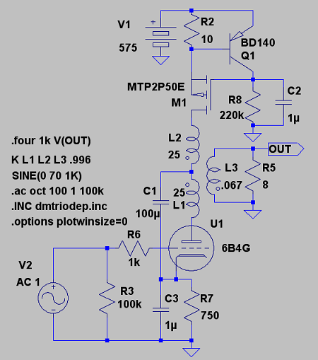

reVintage:
Constant current plateloads! So far I´ve used MJE350 in cascoded bipolar CCSs for input and driver stages up to 300V B+, I also have a bunch of DN2540 that can take 400V but I haven´t used them as they seem very intolerant against ESD (people destroys them all the time).
A 500V 2A 75W P-channel device is something I have wished for for years!
With these devices I´m looking froward to squeeze at least 450Vp-p out of an 12B4A stage with 500V B+ and fixed bias, excellent for my cathode follower projects!
To make things more complicated a N-ch MOSFET could be added on the active side.
M1 makes a highZ CCS and M2 makes a LoZ Voltage source.
Could not find any highvoltage NMOS at OnSemi, any suggestions Rod?
R3 sets Iq, R2 sets balance in the current-mirror and R11 sets anode-voltage.
Must admit that "sand" is not my territory so I leave to someone else to adjust the circuit.

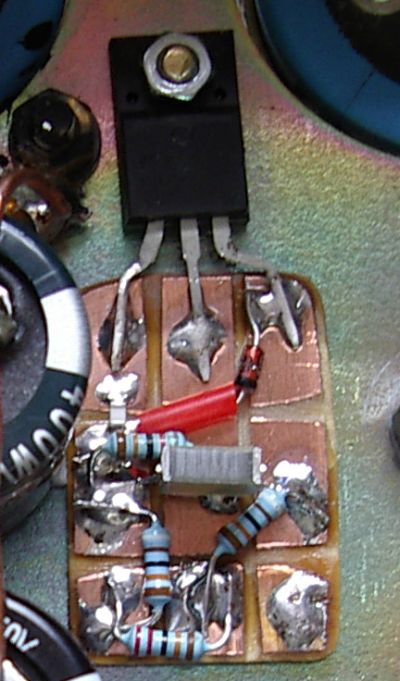

hello Lars,
I like the 900V FQPF3N90 from Fairchild for all of this kind of work. The extra high voltage helps reliability! It's an isolated case TO-220, so building is easy.
Even so, some precautions using FETs in this kind of circuit:
- use 100nF or more on mains trafo secondary, else turn-OFF transients can wreck your FETs.
- use 330..1KOhm gate resistor as a stopper. Low inductance chip resistor is best (see pic). Power FET can give unwanted oscillation at 1..30MHz or more!
- With current source/mirror and cascodes in the same node as a triode, sometimes stoppers are not enough to stop oscillation. I have had success using Chip Ferrites (Murata BLM21A102S is very effective in this kind of position)
- 6V..10V zener (gate to source) to protect the oxide is vital! See the zener in the photo.

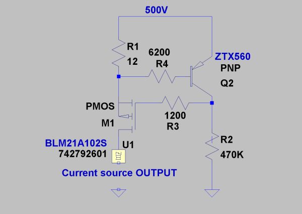

hello Fuling, I have had some good results using current sources in anode circuits. For current source applications using the P-channel 500V FETs, try using a chip resistor in the source circuit, and the PNP Zetex ZTX560 "cross-coupled" to form the current source.
When I built this circuit and compared to circuits with LEDs, zeners, opamps etc - it sounds MUCH better!
Put 1K in the P-ch gate, and about 6,2K in the PNP base circuit to compensate. Run about 1mA in the PNP, and increase the 6,2K if there is any oscillation.

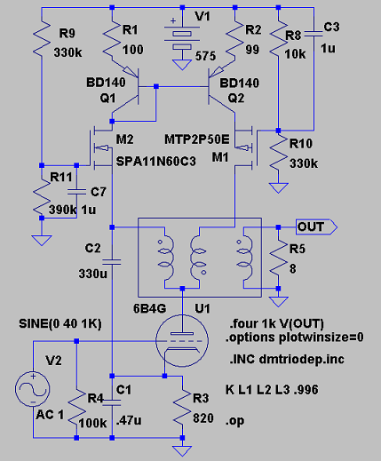

"kenpeter: I simmed your (as usual weird circuit )and mating the 6V6 with the 2A3. Think you got something here. Have you actually tested it?"
As Ken mentioned in posts #92 and #94, one can get twice the power of SE using a P-P xfmr and still get SE sound using dissimilar Gm devices. Some previous threads on the subject:
http://www.diyaudio.com/forums/showthread.php?postid=1446107#post1446107
http://www.diyaudio.com/forums/showthread.php?postid=1597781#post1597781
http://www.diyaudio.com/forums/showthread.php?postid=638005#post638005
No reason to be using air gapped SE sfmrs anymore.
Hi Don,
Didn´t you notice that we are already building a SE sound PP in:
http://www.diyaudio.com/forums/show...781#post1597781
Check post#26! Will soon report how it sounds. We will try two versions, 6B4G+6V6 and 6V6 triodestrapped+6V6.
This is another creature with 50% less current through the transformer.

Could you please publish a schematic with component values on your CCS! Didn´t understand your explanation.

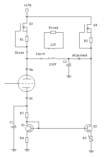

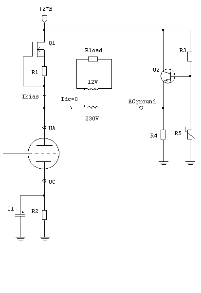

Hello,
Can avoid using PNP and PMOS using something like this, since it seems they can be hard to find at reasonable effort.
This will also eliminate DC through the toroid totally! That is something to try at least.
No center tap needed.
Anode voltage is +B, the whole circuit will operate at +2*B. The right hand side of the primary is on AC gound. The signal swing at the primary is the same as in normal SE.
I'm pretty sure this is not new idea either, but tempting. No further compensation needed!
- Elias
- Elias
hello Lars, here's a quick schematic.
Running from 500V, the 12 Ohm sets the current (12 x 50mA ~ 600mV, the base-emitter voltage).
The 6200 Ohm base resistor is adjusted to keep things stable - but be sure to make very short connexions to the base and the FET gate (<20mm for preferance).
U1 is a Ferrite bead discussed above, to keep the impedance high all the way into the GHz range, and reduce further any tendancy to oscilllate. These chip ferrites must be mounted on some board - they break if wire is used!

Hello,
After drinking more coffee this morning I realised the capacitor in my last schema is a bad idea. This is a sort of active parafeed. Need to think about temperature and tracking stabilisation more though. However idea is to feed zero DC current through toroid.
- Elias
- Elias

Hello,
Revintage:
Signal current going through C1, so in a way it has the same characteristics as parafeed except it is not
Michael:
Yes I remember that topology, but as I understand Smoking-amp circuit it has high impedance at both side of the primary. I was approaching AC ground on the other side. DC tracking is a must in these kind of compensation methods, I agree.
- Elias
Revintage:
Michael:
- Elias
Hej Elias,
The cap has the same function as what you called "supply cap" in your post #82. In other words you could as well connect it from the CT to ground and have a separate decoupling cap at 6B4Gs cathode.
The definition of parafeed is probably not what one should use here even if current is fed thorough a cap, as we among other things have DC through the windings.
One could also ground the CT to get rid of the cap and feed the circuit with +/- 290V.
Post#82 was purely SE, this is an asymmetrical PP variation where the now active MOSFET takes its input signal from ground.
It is funny how many ways there are to do this current compensation. Have you built your prototype yet? Our first version will hopefully play tonight or tomorrow.
Hello,
Revintage:
Reply to post no 115, that circuit looks good. I can see some similarities to this old patent
from this thread
http://www.diyaudio.com/forums/showthread.php?s=&threadid=52175&highlight=
The fact that you added current source at the top makes it really work!
Yes the currents are identical, but will it be the case for the windings? If not there is left over saturation that does not compensate. Well, maybe not a severe issue.
Signal goes through C1 but surely the tube will distort much more than that
- Elias
P.S. another prototype is on the way
Revintage:
from this thread
- Elias
