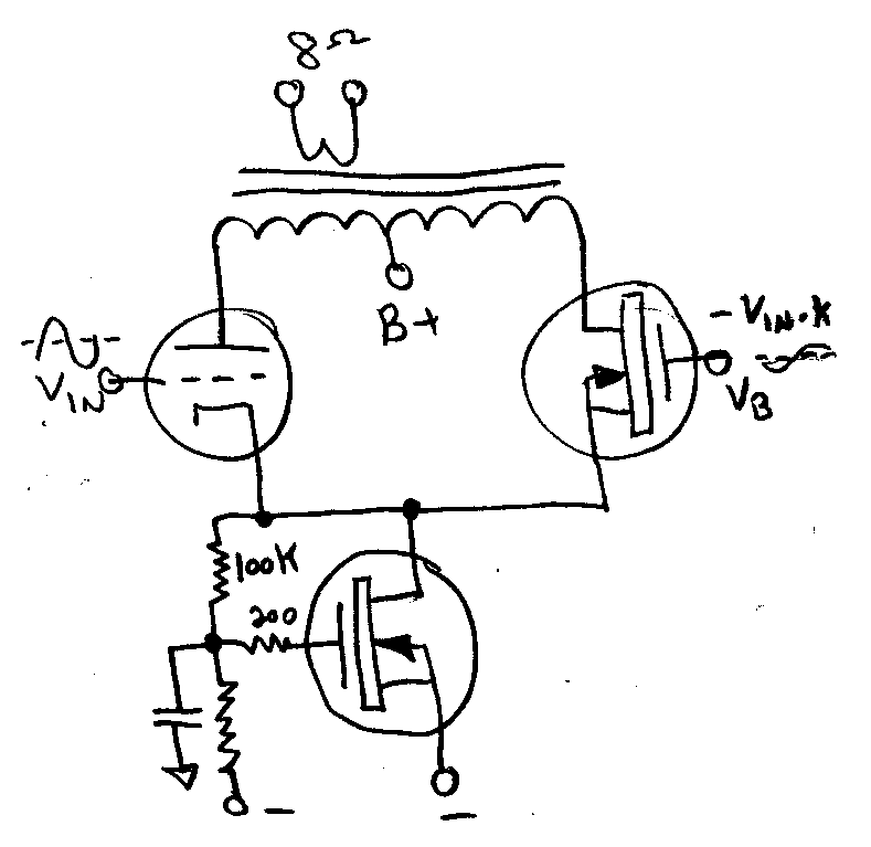

Seems to me that we could simplify the CCS/Mirror arrangement to get rid of the capacitor(s) in the signal path. Just connect the triode and "anti triode" cathodes together with a CCS tail to B-.
Then use a high value resistor divider and cap filter from the tail voltage to control the gate voltage of the CCS Mosfet, for a DC/envelope tracking CCS current level. (ie, tries to keep the DC tail voltage constant) Now put Gm(t)/Gm(a-t) of the input signal drive on the "anti-triode" grid/gate so that the tail voltage stays nominally constant AC signal wise. Still would have a LF response due to the RC, but would only be affected by the signal envelope and (ie the product of) triode non-linearity now.
Putting in additional CFB feedback would require putting most of the CFB winding on the triode's cathode (determined by the ratio of the device gm's again) to maintain a steady tail voltage. Adjust the CFB tap going to the CCS for zero AC signal there after taking into account the anti-triode source/cathode AC drive.
Or, put all the CFB winding in the triode's cathode side and either dispense with the "anti-triode" drive or tune it for a complete null at the tail.
Don
"could you draw it?"
No problemo. Seems an obvious solution to me, someone may have already mentioned something similar. I think Anatloyi (Wavebourn) mentioned such a self regulating CCS for something.
The two drive signals are scaled so that the tail voltage AC variation is nulled to a minimum.

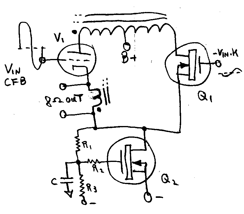

CFB version. The drive signals can be adjusted for a minimum AC null on the tail again. Or maybe just leave Q1 with a steady bias on its gate, could be good enough. Just trying to keep audio out of the CCS tail's slow regulation (no resonance then). The slow regulation is for compensating non-linearity in the tube, causing growth of current on large signal bursts.
Since the audio doesn't go thru the cap, the RC low pass can be set to be lower than the L (OT primary) and C resonance, avoiding resonant activation by enveloping, I think.

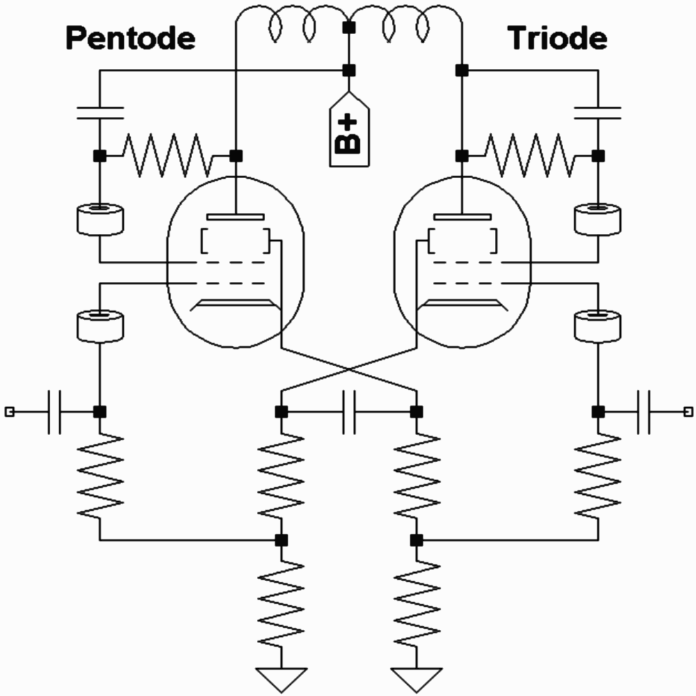

And now for something completely different:
Anyone remember what engineer this this crossed
bias balance was named for? I've seen it mentioned
here before, recently too, I'm sure of it... But I draw
a blank what name to search for...

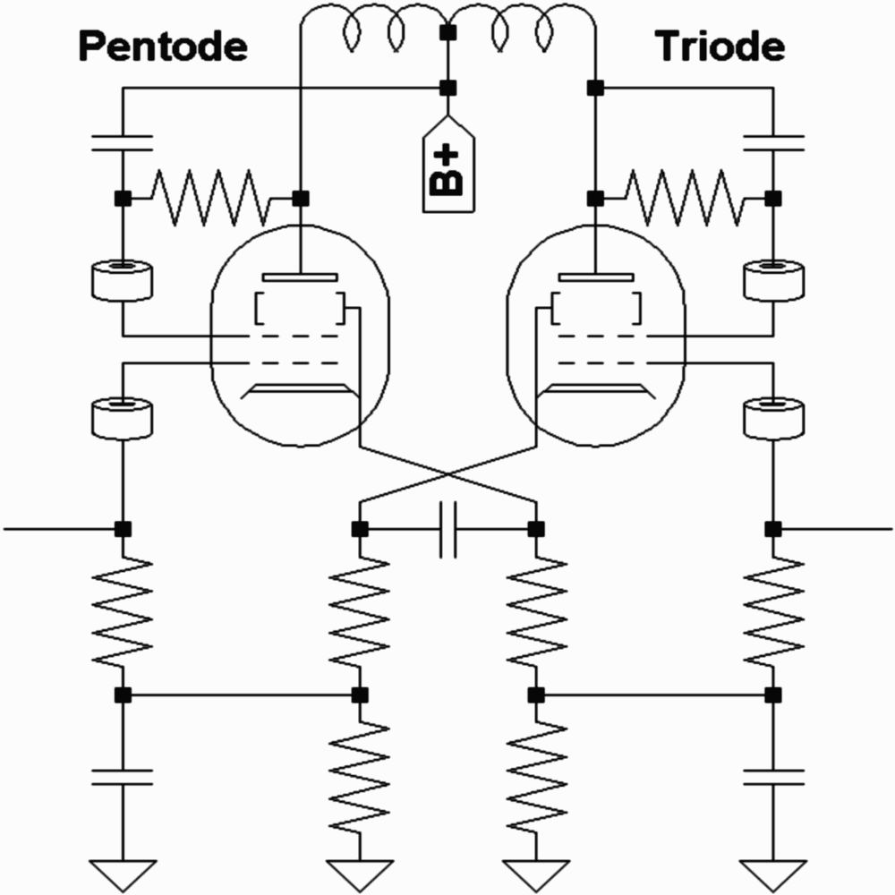

Maybe those bypass caps at the bottom should have
been moved up and used as coupling caps from grid
stoppers to the driver(s) instead... My bad.
Serious bypass goofup fixed...
As for a resonance? I suppose it probably has one...
I don't see any reason it would be within the audio
passband. Does it cause DC balance to oscillate?
Would that mode ever have a gain approaching 1?
Are you suggesting its a motorboat of some sort?
