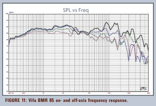

Appears to me that this driver should not be used fullrange. Isn't that a dipole null created by the manner a BMR functions? I think yes.
The lacking top octave can be due to the voice coil inductance of this particular driver. In the frequency range where a driver works modally there are no dipole effects. A large DML pannel doesn't sound like a dipole. The BMR in an 18 cm round baffle (just trying) does. This an other way of getting rid of the strange location phenomenon (if you like dipoles).
Au contraire my friend, it most certainly does have this effect at play. Look how the driver "cone" is by designed function with mass loading the center creates a dual mode of operation. One inner and one outer, the added mass is to balance this mode but none the less does behave in this way due to the difference in acoustic pressure has far greater effect on the outer edge, where as the pressure on the inner is compensated with mass. Read the pdf you posted, it says the same thing but leaving out this not so little detail.

The measurements show an excellent independence of the FR from listening direction
Could you please post those measurements?
You're using ARTA, right? Could you please export the impulse responses as .wav and post them?
The Hiwave has an unusually heavy diaphragm for such a small driver, which is responsible for its different treble response, but also for its terrible sensitivity.

The point I was trying to make wasn't specifically about which BMR driver being used, but rather how they all function. For yours I wouldn't cross above 2,5-2,7kHz and add a tweeter from there for best sound. BTW a conventional driver of the same size would be crossed 5k, maybe a tad higher.

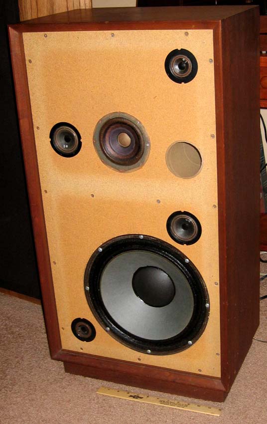

Here's another speaker Rectilinear III using similar semirandomly placed multible tweeter method. (see more pics here Vintage 70's Stereo System)
Tweeters operate above 3 kHz, and are crossed with 1st order filter.
The spacing of the tweeters is much longer than wavelength in the operation freqs. This is very smart, because the off-axis response varies semirandomly with spatial angle.
This can potentially give some remedy to the terrirble stereophonic cross talk comb filtering, which otherwise manifests itself in "naked ugliness" as Toole puts it in his book.
This model seems to be already from 1960's.
Also there seems to be another version of this speaker with lower height:
http://i.imgur.com/jcjMS.jpg
The tweeters are considerably far from each others.
