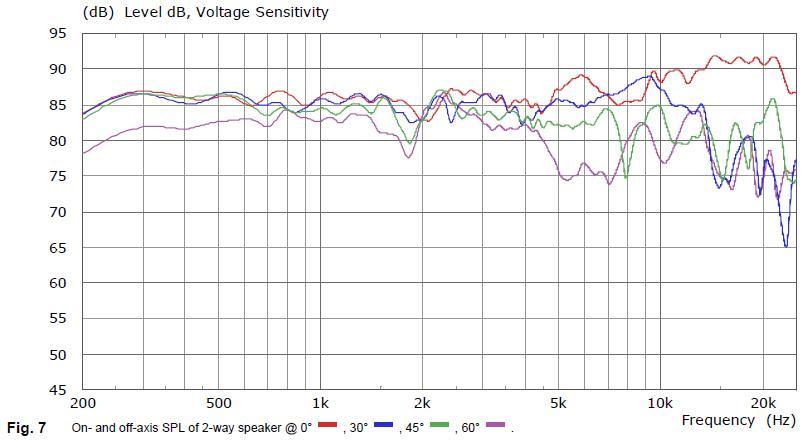

Naim BMR
http://www.naimaudio.com/sites/defa...naim_ovator-s-600_bmr_white-paper_may2009.pdf
Below is the frequency response shown in the white paper, and i assume the data
being rather authentic, because i have seen lots of plots from bending wave
transducers with comparable "gross parameters" due to size, coincidence frequency
etc. The "BMR" does not behave completely different like e.g. the "DDD" type
transducers made by "German Physiks" which are based on the Walsh bending wave
design.
The comment to the measurement is as follows:
"What is more important however is that the on-axis
frequency response curve is no longer an accurate
indicator for the tonality of the loudspeaker. In fact
during the development of the Naim BMR it became
clear that the on-axis response is as good, or bad, as
any other single frequency response measured at any
arbitrary angle."
_______
OK, "according to Toole" we "know" this is not quite true.
The on axis response is of more importance
- or at least needs some closer look - as the off axis responses.
Like other bending wave designs, the BMR tries to achieve a balanced
power response, while "perfectly flat" FR at particular angles is
neither possible nor intended above a certain frequency.
That means you need all the frequency responses to be "complementary"
and they should not change in a too discontinouus manner, for the
speaker to sound uncolored subjectively and have the desired "close to flat"
power response.
The gross behaviour can be described without recurring to the "modal balancing"
technique to detail, since adding mass is just changing the material parameters
of the disc shaped membrane: Bending wave propagation will get slower with
mass added. That means adding mass also affects the coincidence frequency
in certain regions of the disc.
Favouring certain mode shapes over others has a different meaning below the
coincidence frequency than above.
Below coincidence frequency the bending waves propagate slower than sound
in air, at coincidence bending waves and sound in air travel at same speed,
and above coincidence bending waves are faster than sound in air.
Coincidence is due to the fact, that bending waves are dispersive, propagation
speed rises with frequency.
For the radiation this means roughly speaking:
- below coincidence, the "average" membrane speed over area is important.
Thus symmetrical bending modes where regions of same size move in antiphase
will cause a dip in the frequency response and the power response as well.
- at coincidence there is a tendency for a side lobe radiated in direction
of the membranes plane itself: This is called "coincidence hump".
There is less energy radiated on axis and more at <=90 degrees.
- above coincidence also symmetrical modes can radiate effectively, because
pressure gradients in air travel too slow, for (in effect) "averaging" the local
membrane speed over regions moving in antiphase. The "coincidence lobe"
now changes to form a main lobe on axis and several side lobes.

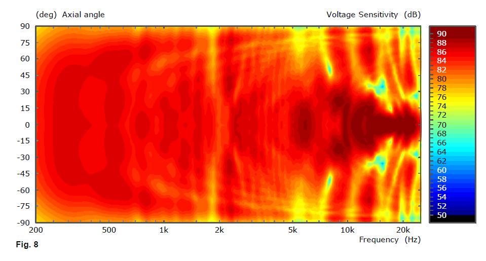

I can identify al least 3 frequency ranges making up this driver's overall response:
a) 0...1,7 Khz "close to pistonic" range
b) 1,7...4Khz "below coincidence modal range"
c) 4..9 Khz "close to coincidence modal range"
d) 9...Khz "above coincidence modal range"
a) The off axis responses correspond closely to the on axis response but
have "low pass filtered" character due to beaming.
b) modal behaviour (center not in phase to outer regions) causes
reduced beaming.
c) When coming closer to coincidence, there radiation gets more angle
dependent again.
d) at about 9Khz there is a coincidence hump with "on axis dip" and pronounced
side lobe: See also Picture 8.
Above that frequency a main lobe forms with "quasi random" side lobes, which
is the typical decorrelated radiation pattern with bending wave transducers above
coincidence frequency. The on axis "main lobe" radiation in this design seems
rather stable however, and also significantly smoother than the off axis radiation
at least above coincidence. Said concidence frequency seems at about 9Khz in
this paricular design which is (i am sorry ...) close to "ultrasonic" for the elder
ones among us and also about 2 octaves above the range of interest, where we
could need decorrelation when aiming at a different "stereophonic approach".
"Modal balancing" IMO is a technique invented for "muddeling through" the
problematic range of low modal density, occuring especially when using
rather small membranes and when using them below coincidence.
It does not produce a behaviour that is different to other bending wave
membranes.
However we discussed, whether this behaviour (decorrelated rediation above
a certain frequency) could yield some benefits due to "outstanding stereo imageing" ...
