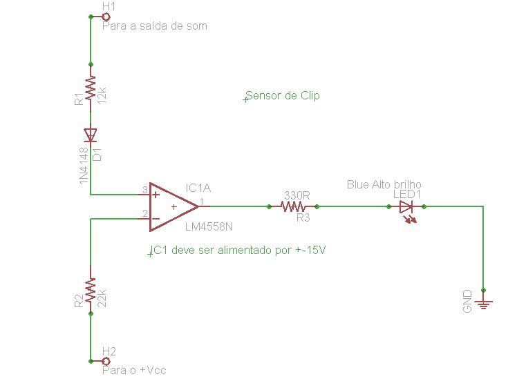

Hello guys, I put this sensor clip and it worked fine, did a test at 60hz, when the wave begins to be rectangular in output (Clip), the LED lights. Among the opamp inverting input (pin 2 and 3), goes a ceramic capacitor, but I do not find a value that could be more normal to me, so I did without it, and it worked fine. The resistor values ​​depend on the value of supply, which in my case + - 25, but I think that this same scheme works very well in + -40 V. ;)
