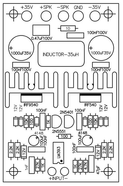

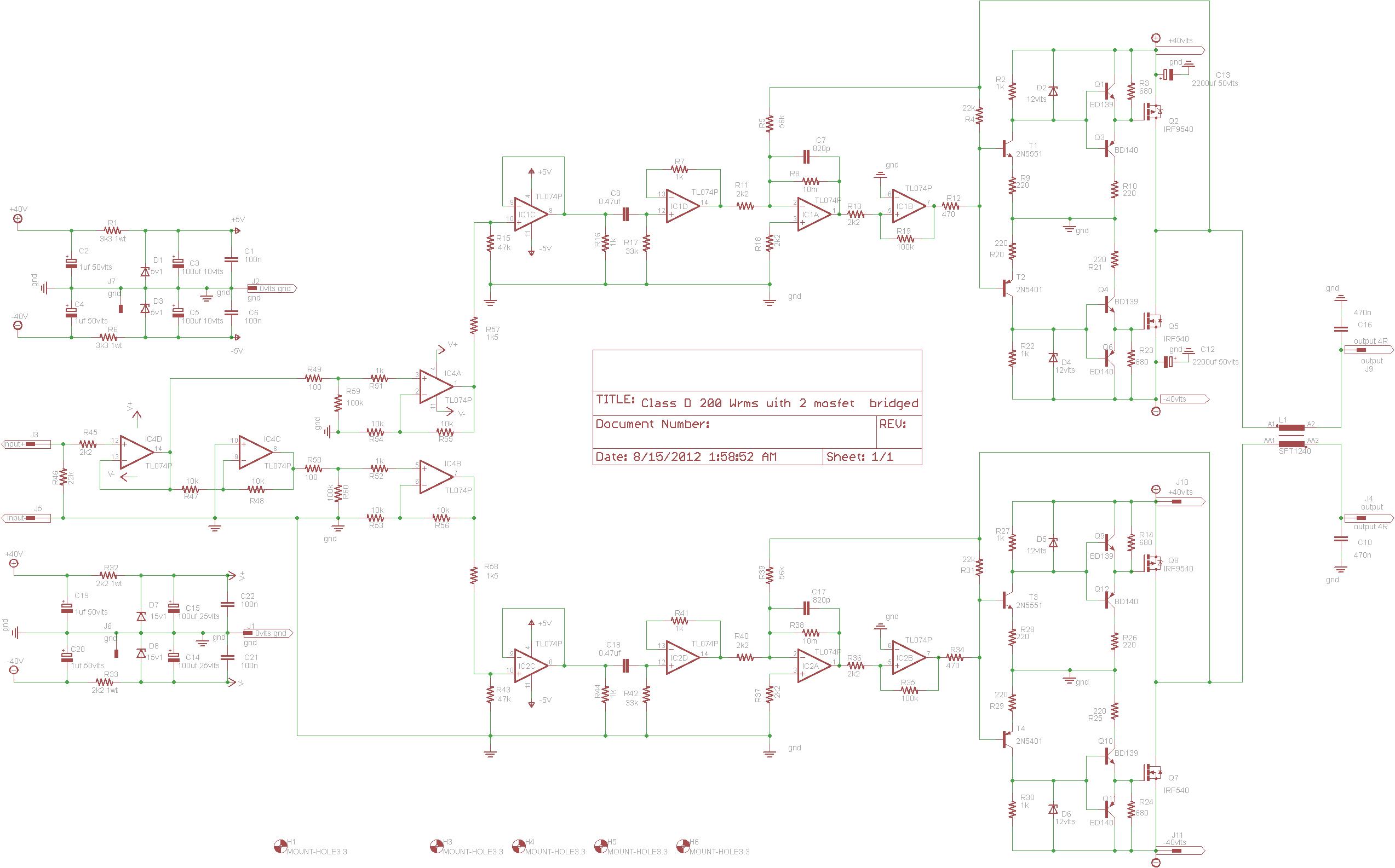

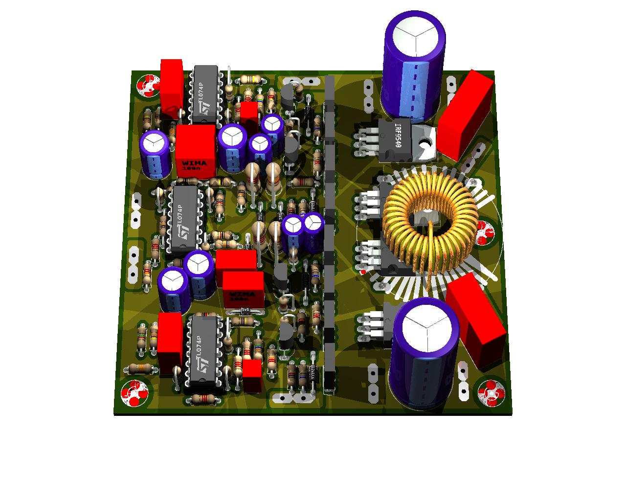

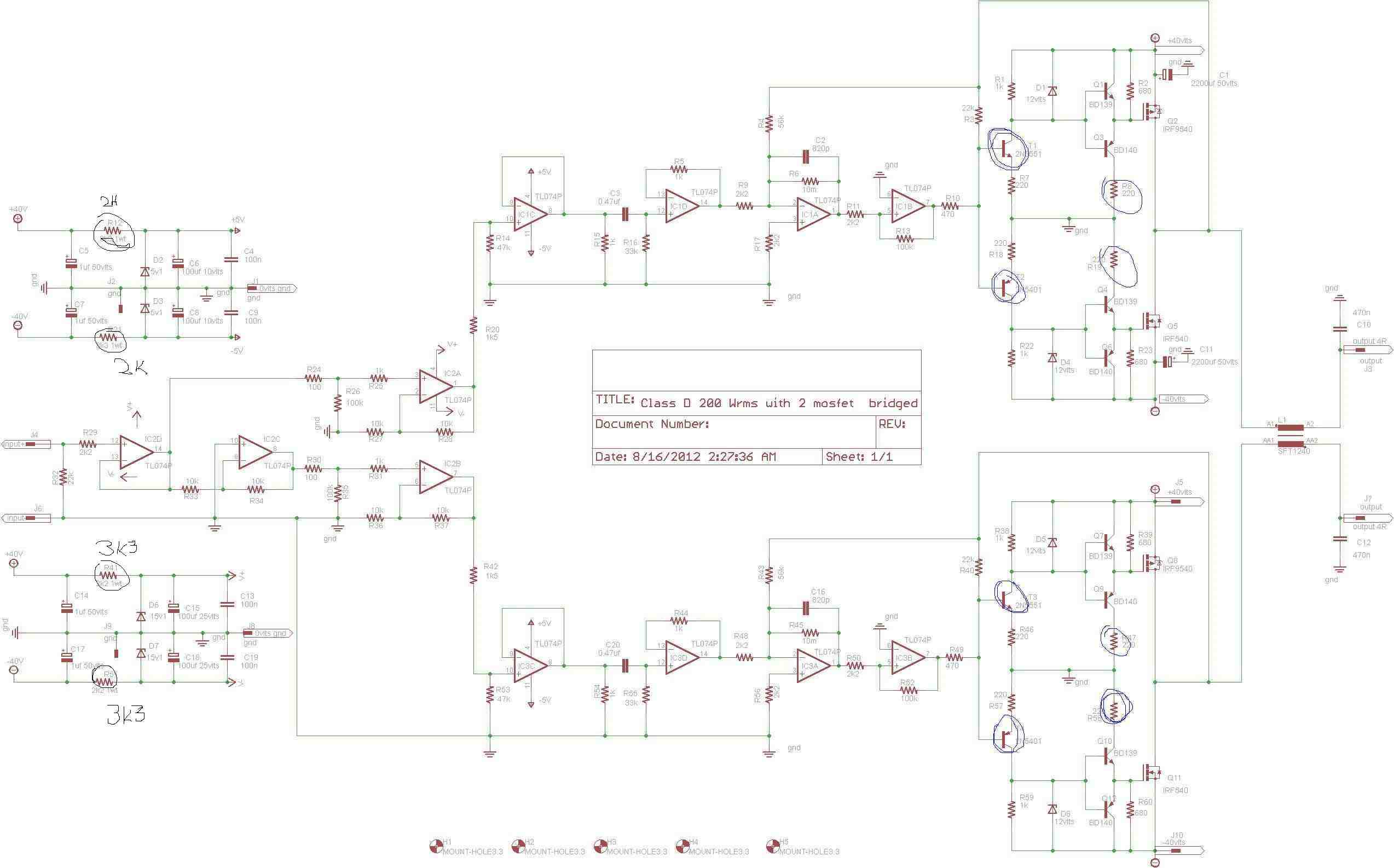

hi guys. the hi power version in bridge mode. i will upload artwork later
Stewin, you sure love what you do! Great work!hi guys. the hi power version in bridge mode. i will upload artwork later
i thank GOD for his help . long time welcome back.

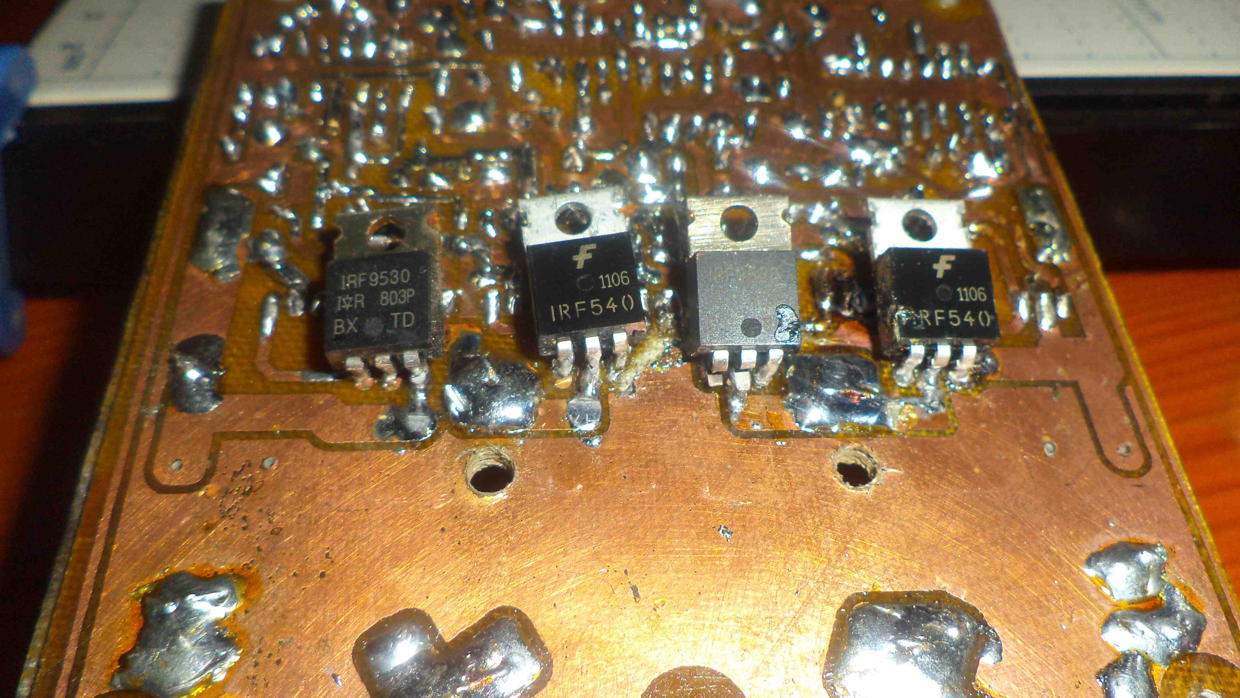

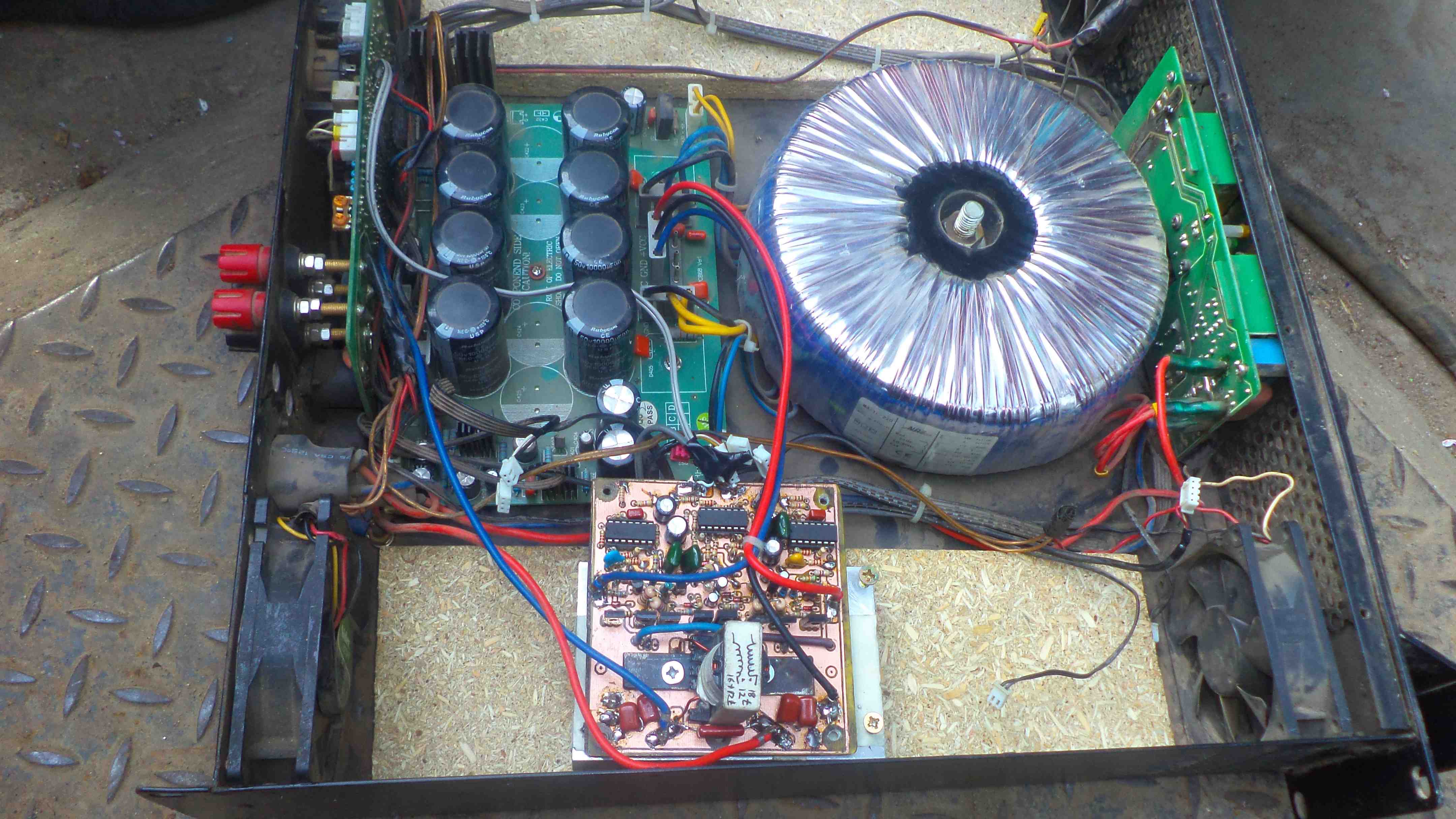

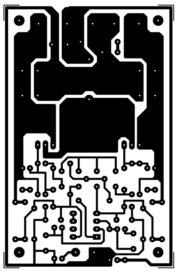

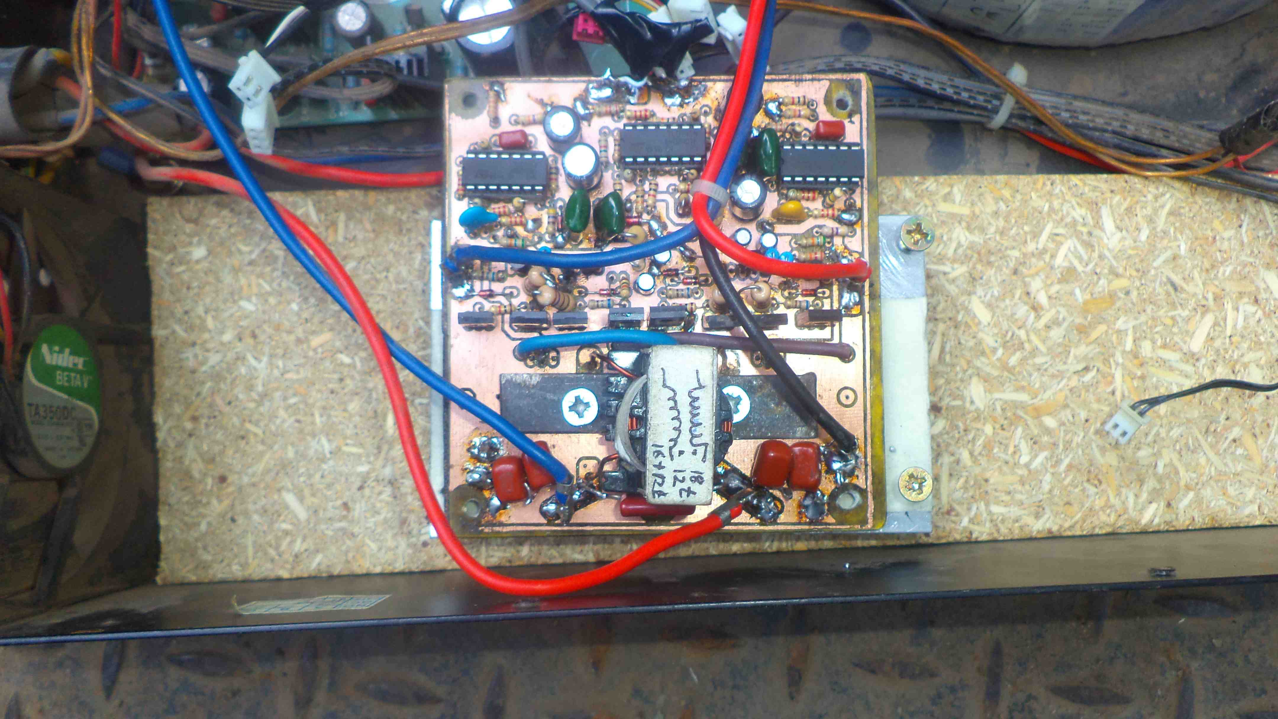

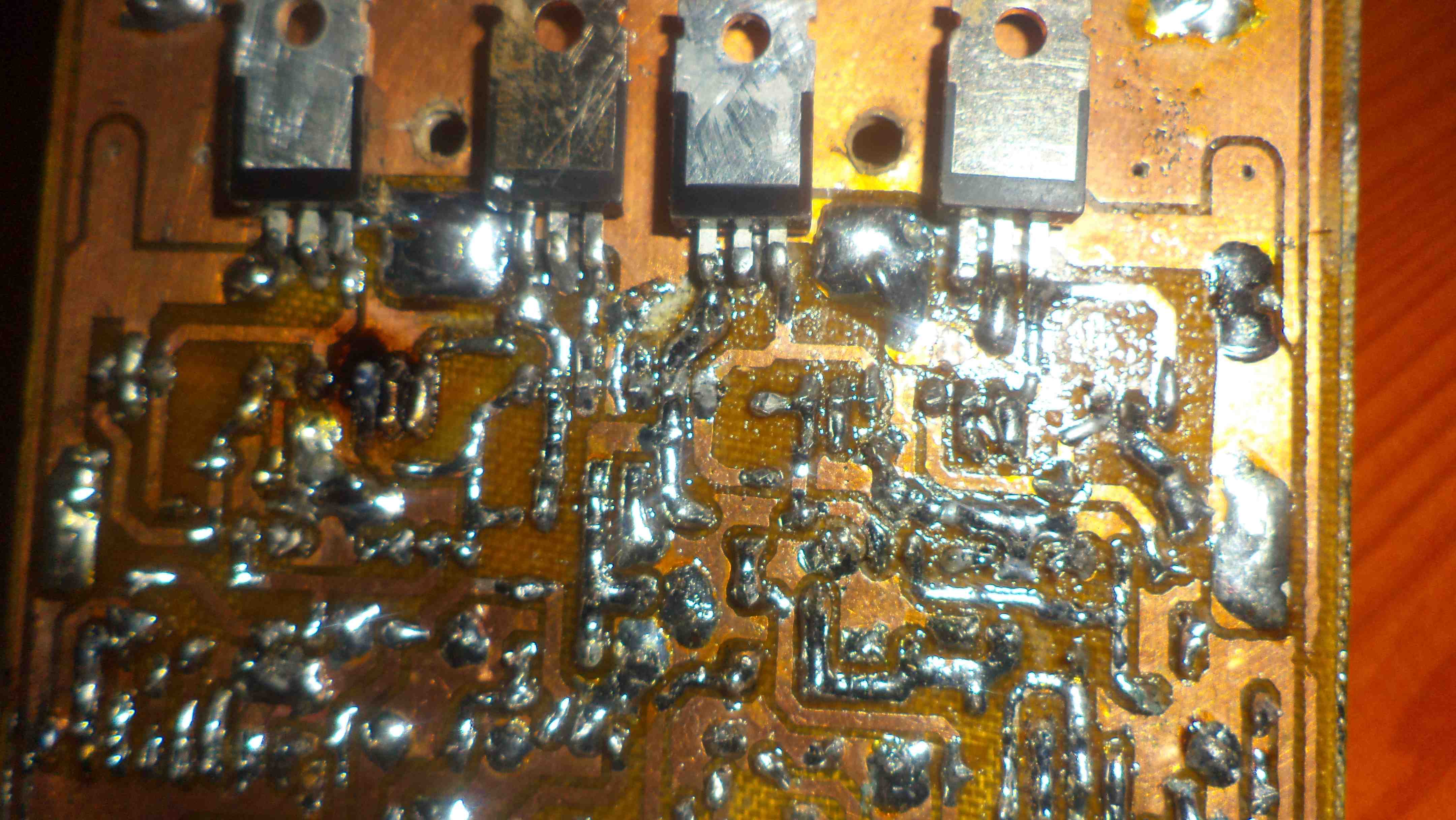

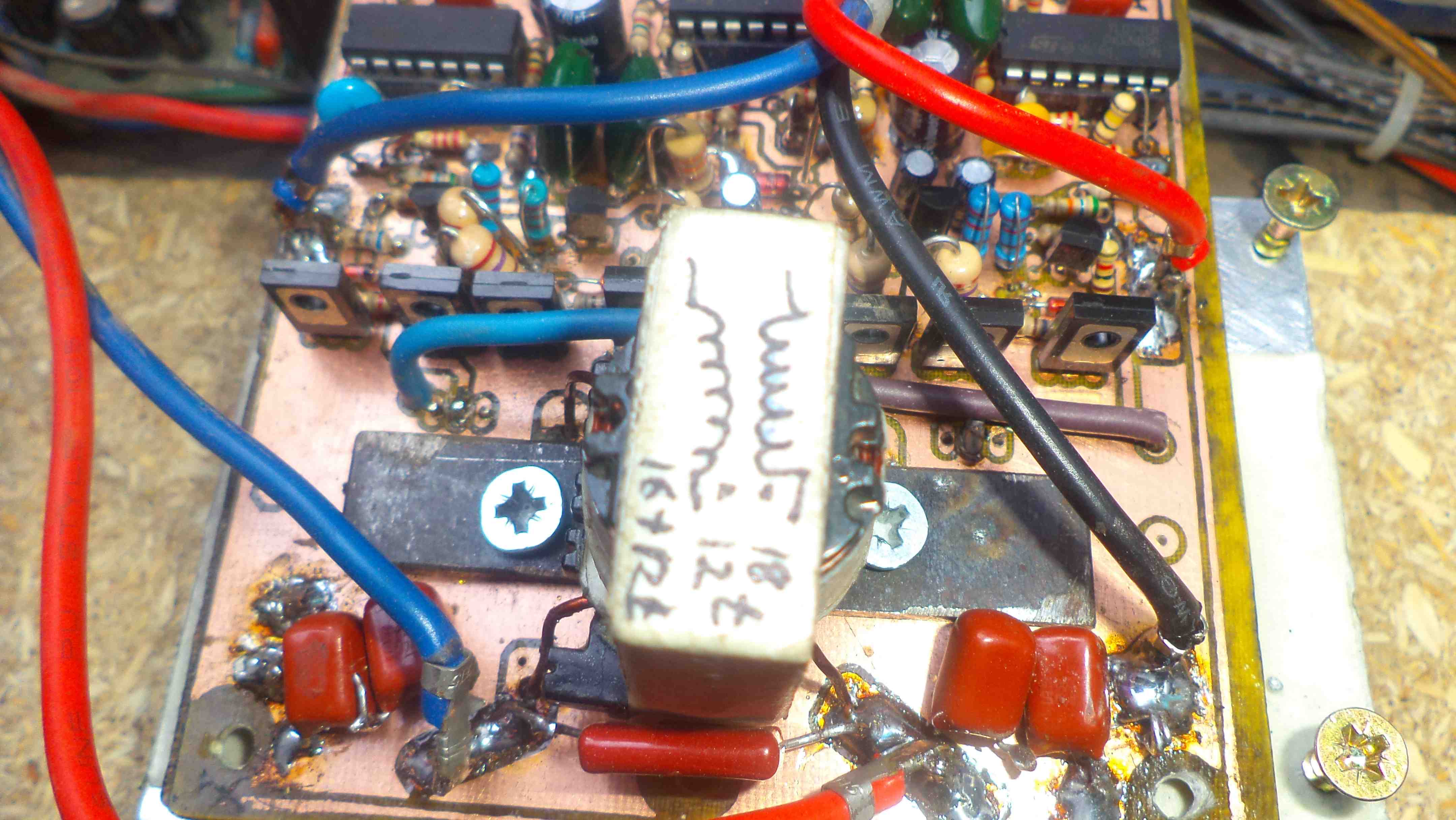

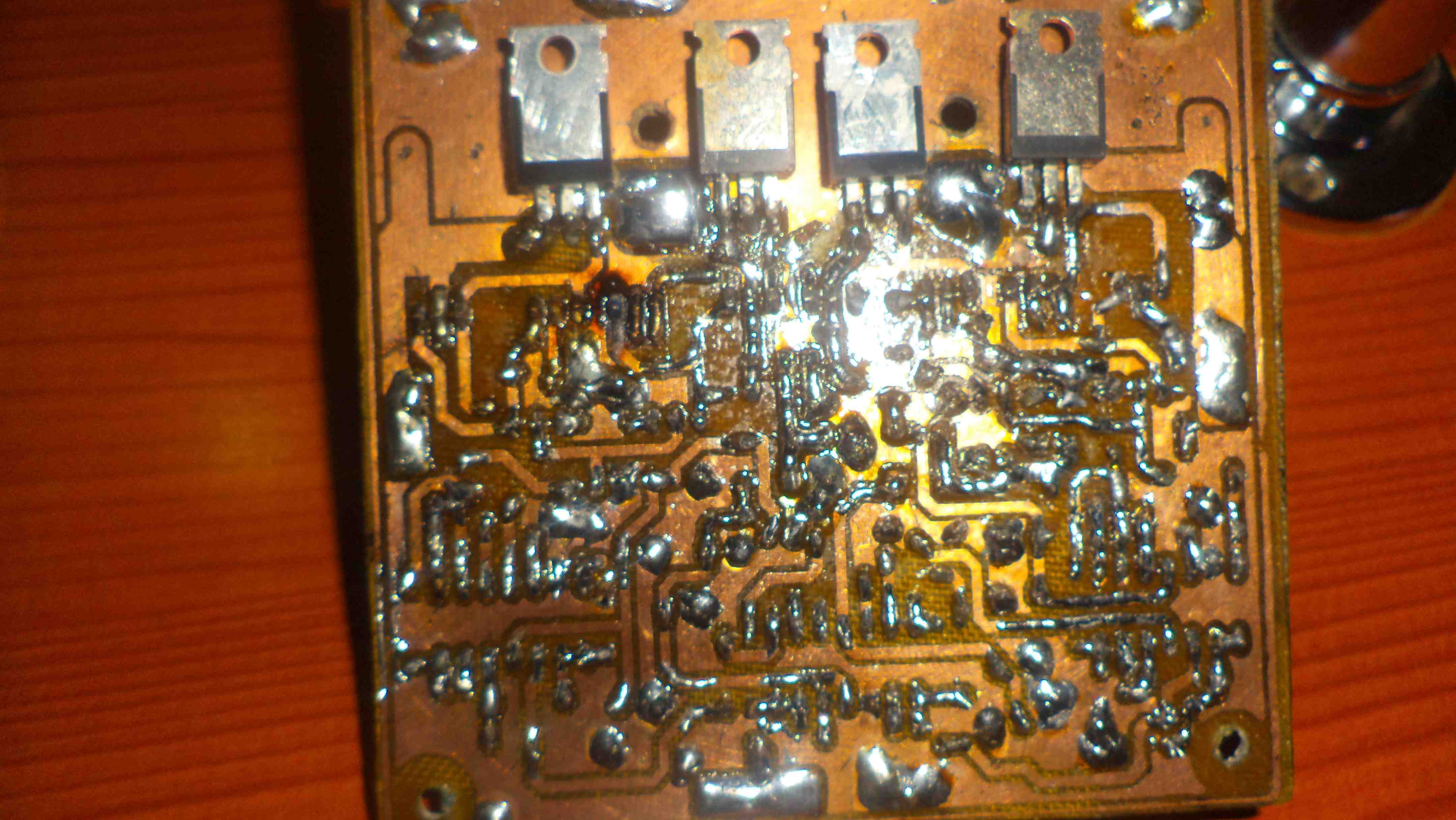

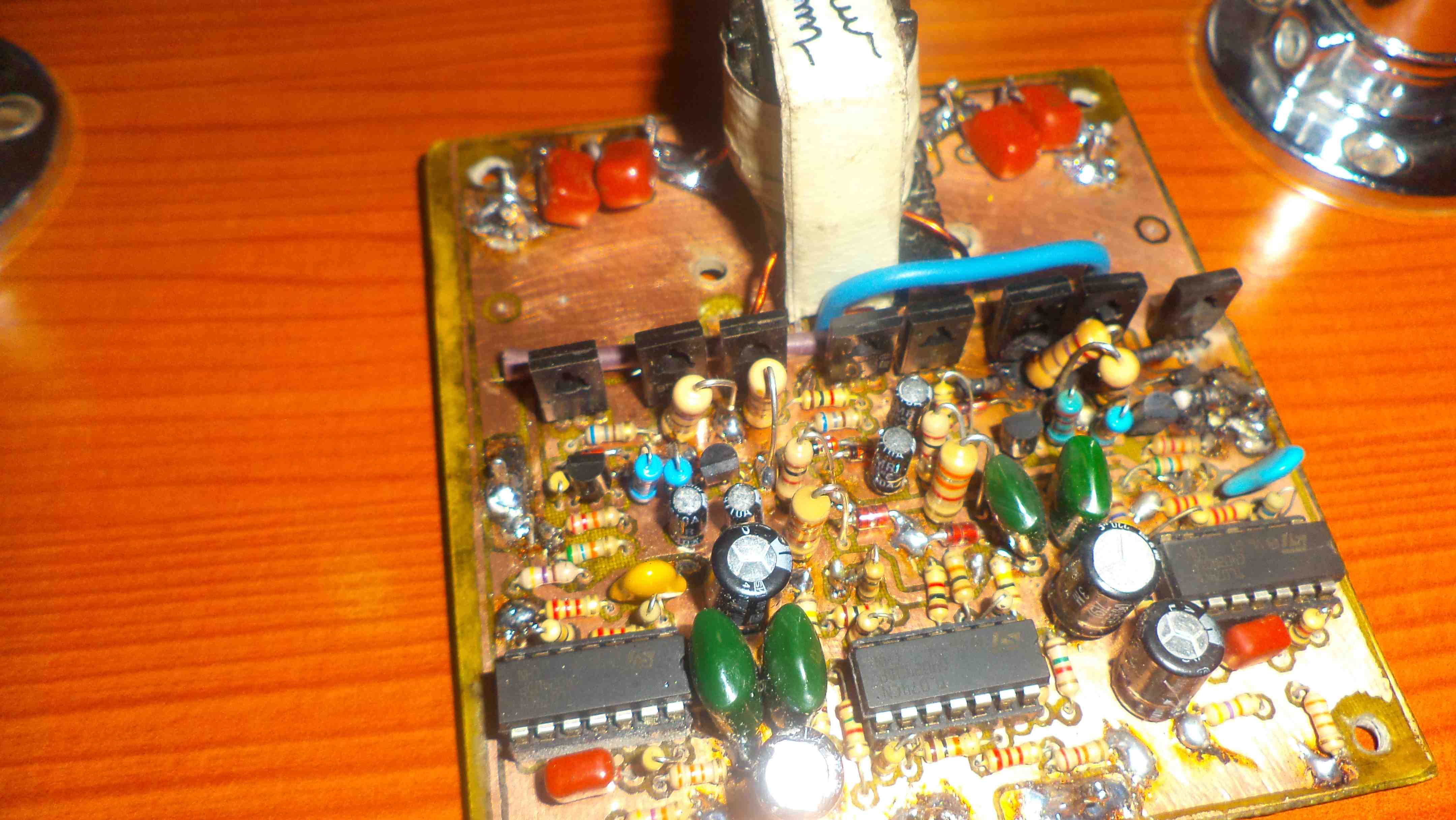

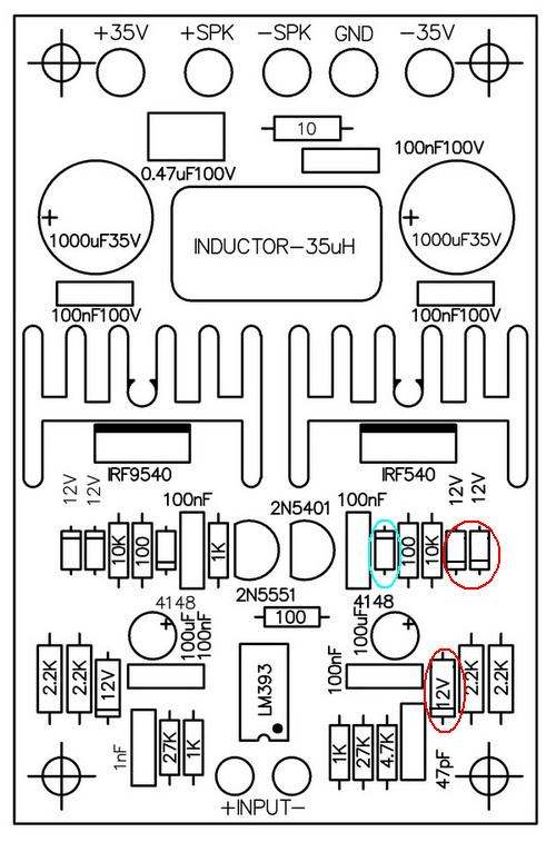

hi all i made bridged version and tested it but . when i pushed it hard with a 6ohm load that is a 18inch woofer the amp failed after 2 minitues. .i think my tracks for pcb were small the ones feeding the output fets. also
>>> btw the circled components were heating above normal.
here are the photos
here are the photos

Class D 200 Wrms with 2 mosfet bridged schematic heating components_1_1.jpg154.3 KB · Views: 531
Use resistive load for testing...don't you care about your speakers and your ears?.
Also any amplifier must survive continuous rms power into resistive load to be reliable with music.
resistive loads like ? resistors in parallel to match impedance desired?
sweetperfume:
No,the opposite is correct.
A speaker is a non resistive load, in fact it is a nonliniar inductive/capacitive/resistive system depending on its configuration(single or multiple in cabinet and with or without filters).
stewin:
Power resistors with their resistance smaller than rated impedance, example: for 4 ohm impedance use 3 or even better 2.5 ohm low inductance resistors or resistor network
stewin:

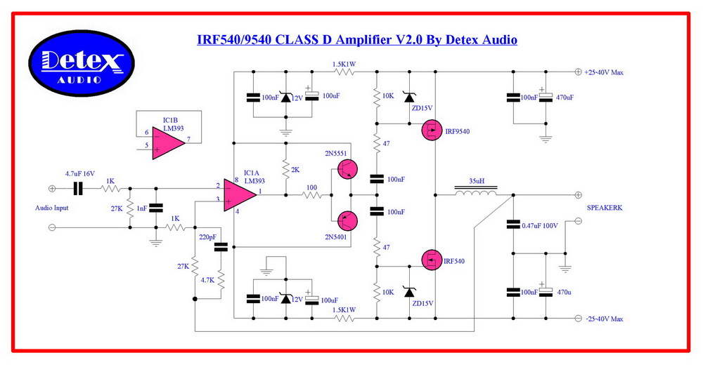

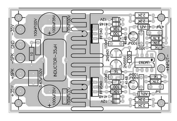

hi all just found this schema by detex audio . it seems simple . what makes it 100watts and not 200 watts?
- Class D
- Ultra Simple Class D
