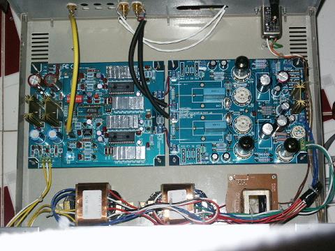

BTW, I can not get my Tube BUffer Working. I have no B+ from the 6X4! I have 540 VAC across pins 1 & 6 and 6.3VAC on pins 3 & 4. I should see the B+ across C4.. Nothing, the tube does not even light up or get warm. I have tried 3 different tubes.
This is the original Tube Buffer Board, I did not do the 6X4 rework as I was under the impression that was not required if I was not doing the Voltage Doubler change.
I have not done the 6DJ8 mod either, I assume that is not required if the VD mod is not done.
What have I missed?

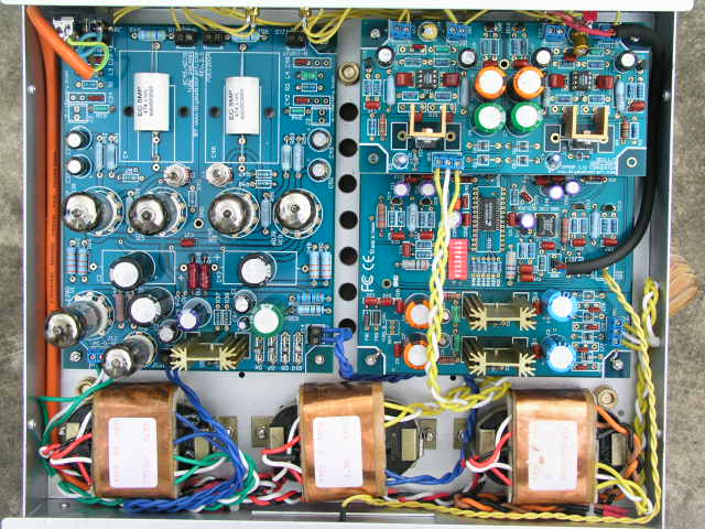

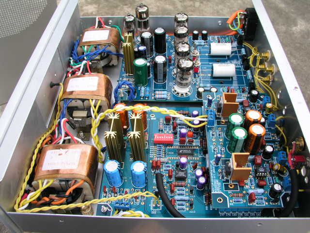

I have completed the tube buffer. It worked right after the first turn on.
The sound is much more detailed than the opa2604. (I am using 6dj8 at the moment, 6922 from sylvania actually). However I think C23, C24, C42, C48 need to be upgraded. I know Thomas left plenty of space for these to be upgraded. I recommend WIMA FKP type. They will make the treble smoother.
My system works fine with no HF filtering at all so I may remove all these HF filtering components some time.
I also replace the output caps with EVOX PMR caps (better mid range for my system). The EC caps provided by Thomas is also very good. I think it worth spending some more on these caps (may be Auricap or Musicap).

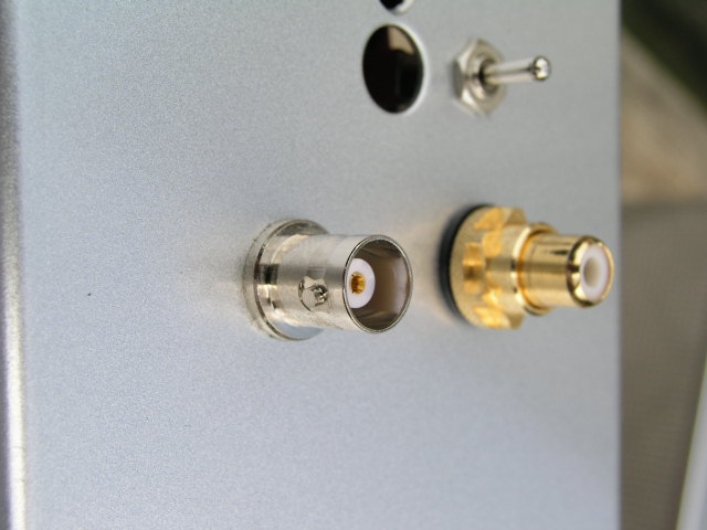

Back panel with BNC, RCA selector.
Pls understand this BNC is a very good one, 3um gold flash plating with soft solid copper tips. The white one is teflon, can support high temp of multi times soldering.
