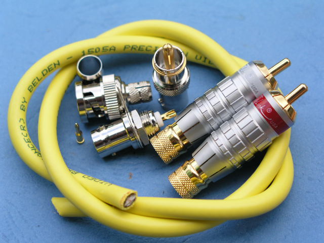

Ultimate Twin TDA1541a Non-oversampling DAC with tube buffer & reclock set...........
Dear all,
pls email the detail address to me that previous purchase my ver2 dac already.
I will post 1 metre belden 1505a digital cable to U. This will be the additional parts for my ver2 dac & this parts will free of charge.
Btw, the digital cable kit I will selling in USD 50 per set. one set of kit will contain 1.5 metre belden 1505a digital cable. two set of excellent quality BNC sockets. Two set of BNC to RCA adapter & two pcs of excellent quality RCA sockets. ( this fatory OEM audionote RCA sockets.)
I will provide same quality thick silver plated RCA sockets.
Diyers can get all in totally two set because if use BNC sickets. The remain RCA can match with another digital cable. therefore, will be another digital cable.
thx
thomas
Dear anthony,
the kit that received almost the best.
the beldeb 1505a 3G digital cable I added 1M into kit now, Free to diyers already.
pls compare the different between two versions & sent one to your friend. he will very happy for your present.
