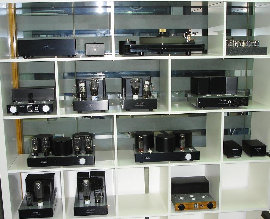

Brian had sveral types of tube amps & pre-amp for U to test.
Django: TVC linestage
Tram: linestage WOT
BIX: turntable
LD+: 300B SET SRPP/91
Joplin: 2A3 pp
Ella: EL34 pp
Cole: tube phono pre
Basie: tube linestage
DIY Hifi Supply Ltd, Unit 1, 7th Floor, Henley Building, 9 Bute St., Mongkok, Kowloon, Hong Kong. Phone (852)3152-3576

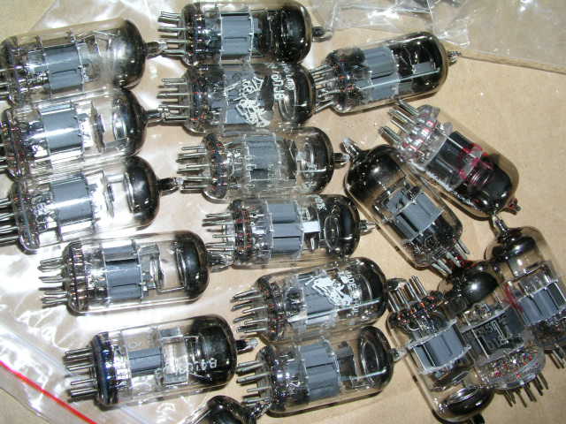

today I collect some of diyers questions about the USD 35 per pair amperex 6DJ8 ( made in holland).
Its a used tubes but test very good by my hickok 539c.
pls see the photos.
I got them from old military equipment. some were unused as stock. some was used. but I will test all & match them which can follow with ver2 kit.
thx
thomas

So Thomas, can I buy a pair of old stock Amperex 6DJ8 tubes?
