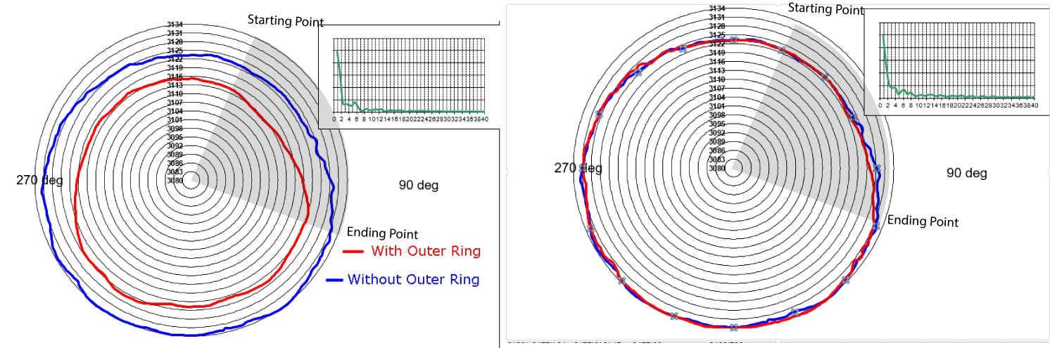

Hi Luckydog,
I ripped two 3150 Hz tracks today. Would you please do plots for me?
I have a 6 lbs outer ring. One track is with the outer ring and another is without outer ring. The outer ring is heavy and I would like to see if it has any impact on the stability of the turn table.
My table is SME20, diy air bearing arm and Denon DL-103r cartridge.
Dropbox - 3150 with outer ring.wav
Dropbox - 3150 without outer ring.wav
Thank you!
Jim
Here's a polar plot for those SME20 files - both on the same image for easy comparison. Blue is without the outer ring, red is with it. Spectrum inset is for the red channel, with the ring.
That TT is running slow, and slows down further with the ring. Also rotational stability appears overall worse with the ring, one can see regions around the 1 thru 4 o'clock for example where something odd is going on, perhaps slipping?
The blue trace, without the ring, is pretty good really IMO. Some eccentricity once per revolution stuff, but the arm/cart combination looks stable - I've seen good results from the DL103 before, perhaps due to its damping?
HTH, and thanks for the interesting samples.
LD

Hi Luckythedog,
Thank you for doing these plots for me!
I used a cheap laser photo tachometer to measure the speed. It looks like it is not accurate at all. I adjusted the speed with the outer ring again by using Feickert PlatterSpeed.
I understand that the ring makes things worse, but I have no choice because the arm/cartridge resonance. I did the arm/cartridge resonance test. My arm has Lateral resonance frequency: 3.97 Hz(left), 3.84 Hz(right) and Vertical resonance frequency: 4.37 Hz(left), 4.37 Hz(right).
These frequencies are within the 2-5 Hz warp resonance frequencies. So, an outer ring or other device is needed to reduce warp. From listening, the outer ring makes the sound better, too.
In the area of 1-4 clock, it can be caused by old belt. My belt is about 15 years old now. Maybe it is time to change the belt. I am just wondering if I can use belt conditioner for auto repair to increase the friction of turn table belt. Or it is because the heavy outer ring. The motor doesn’t have enough torque and lost its grip.
You said arm/cart combination looks stable. How do you find it out from this plot?
I didn’t use the damping device.
Jim

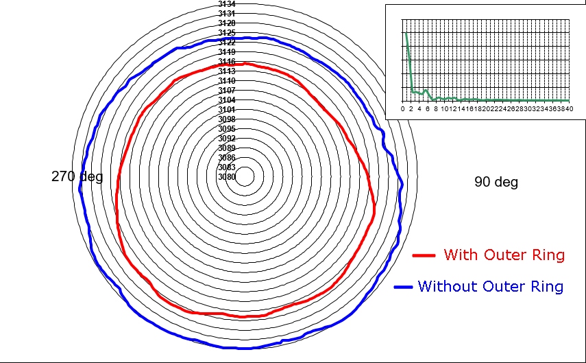

You're welcome, Jim, and thanks for providing files from such an interesting rig.
Attached is a polar plot showing two consecutive revolutions (red and blue) from your 'without outer-ring' recording. This is with the fascinating air bearing arm and DL-103r, and no arm damping.
You can see that it is really very good - the biggest contribution to pitch instability by far is once per platter variation that mimics eccentricity. This could be simply record centering, the most common cause. Even then, I've seen far worse.
That aside, overall cartridge-arm stability looks very good - it would show up as short term pitch variation, normally as a settle response involving natural resonant frequencies. But you can see from the plot, and from the inset spectrum, that amplitude of short term pitch variation is very small, near as good as it gets IME. And from the inset spectrum, there's no suggestion that the cart-arm resonant frequencies you mention show up to any extent - There's a small sort of quasi-random variation that has no real spectral focus, I would say. But no sign of cart-arm instability.
There does seem to be a platter/drive issue between 1 and 4 o'clock, even without the ring, that gets worse when the ring is fitted. Could be belt slip/stretch, could be bearing drag........if you sorted this, then apparently fitting the ring offers an improvement to stability, but from a very good base anyway.
Interesting that you prefer the sound with the ring fitted - I do believe a small amount of pitch variation can be euphonic............. I wonder if fixing the 1-4 o'clock problem might change that perception for better or worse ?
Anyways, nice rig. And I hope this might provide some pointers to fixing the rotational problem, if that's what you choose to do. Happy to run another plot or two should you wish, if you decide to fix or further investigate the cause.
LD

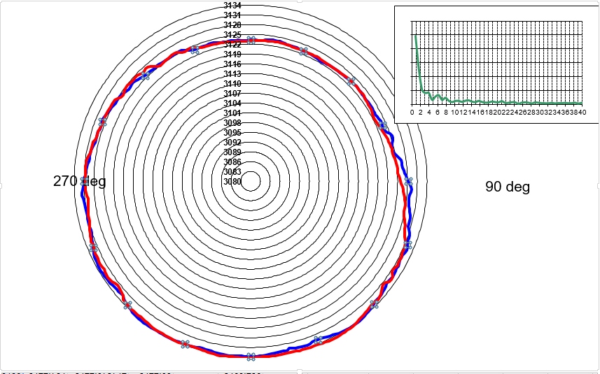

Super, I don't see from the latest plot how the ring makes things worse. Maybe that little slow down around 2:00-3:00 bothers you? Otherwise the speed looks the same as without the ring, just a bit smoother.
Hi Pano,
Please see attached image and pay attention to the shadowed areas. The frequency was suddenly shifted at starting point and back to normal at ending point. And, both plots with and without the outer ring seems to be very similar.
Jim
