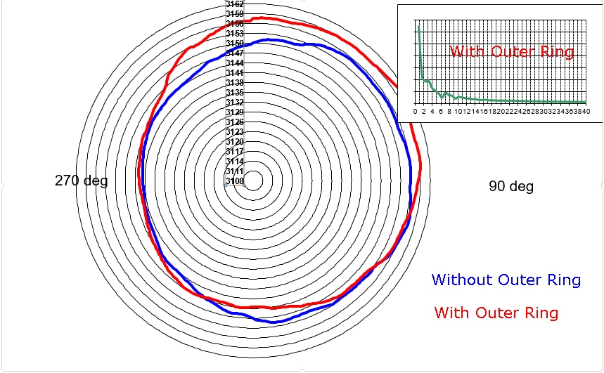

Hi Jim, here's a polar plot for With-v-Without the outer ring, for your new belt recordings. Blue trace is 'without', Red trace is 'with' the outer ring.Hi LD,
I just received the new belt. Would you please do 2 plots for me? Thank you!
https://www.dropbox.com/s/3v0cnngu4mmuevv/new belt with ring.wav?dl=0
https://www.dropbox.com/s/axwcz8zyk1wluwv/new belt without ring.wav?dl=0
Jim
The 'without' trace is overall more stable, but unfortunately both still show the 'once per revolution' variation for part of the revolution which is still more pronounced when the outer ring is fitted.
So, unfortunately, it doesn't seem that the new belt has changed much: except (oddly) the 'with' recorded file is on average slightly faster than the 'without' - perhaps you reset the speed after fitting the ring?
Knowing the cart-arm resonances are about 4 Hz means one can look wisely at the FM spectrum and perhaps see some content there - but in the grand scheme of things it's not significant, and there are other factors which contribute much more to pitch stability. On the whole, apart from the once per revolution stuff, pitch stability is very good and the cart-arm looks good to me. It's better without the ring, methinks.
HTH!
LD

It seems to me the new belt doesn’t do too much to get rid of once per revolution frequency shift. It perhaps makes things worse. I compared the new plot with old one(old belt installed). The shift in frequencies from highest point to lowest point was 12 Hz with outer ring and was 10 Hz without outer ring. For new belt, the shift is 16 Hz with outer ring and 13 Hz without outer ring.
Yes. I reset the speed after installing the new belt with outer ring. It looks like that the speed doesn’t raise too much without the ring. In previous plots, the outer ring slowed the speed considerably. The only explanation is the new belt may increase the grabbing force so the speed difference is small now. From this point of view, the new belt does add some positive effect to the driving mechanism.

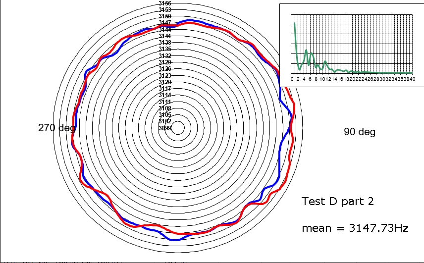

OK, I've done four recordings in an attempt to look at the effects of stylus drag.
A second arm and cartridge was set up so that they could be used to track the test record simultaneously to the main arm and cartridge (the extra arm was an SME 3009II Improved with a Shure V15mkIV).
Each track includes 3 seconds of silent groove prior to the start of the test tone, for alignment purposes (hope that helps).
A is just my arm and cartridge playing the test track (no added drag).
B is with the Shure stylus also tracking the record (track 1).
C is with the Shure stylus damper brush also engaged (for added drag).
D is as C, but the arm is lifted mid way through the recording.

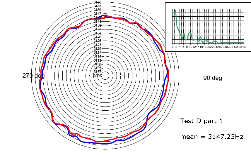

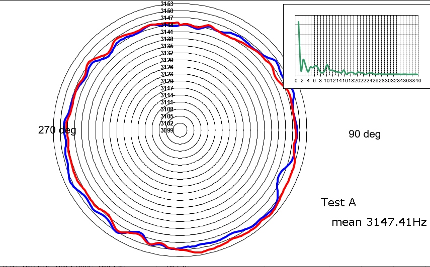

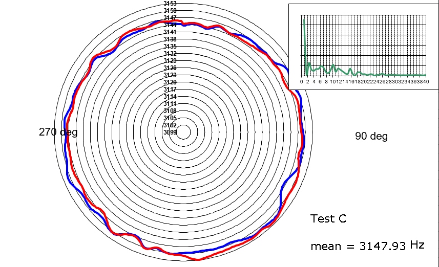

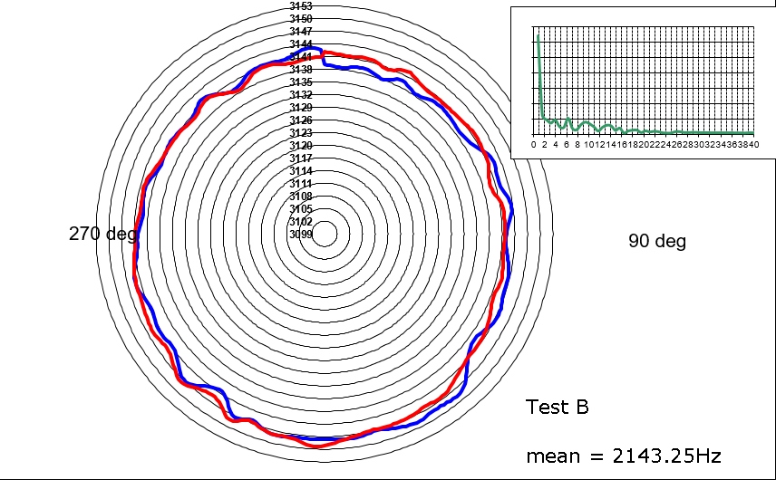

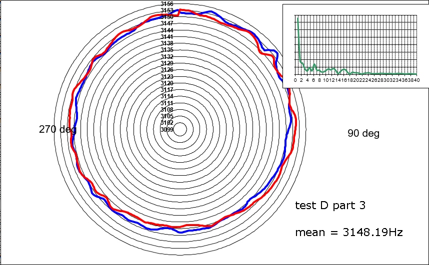

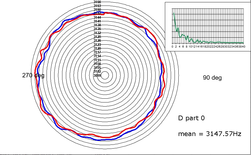

Anyway, here's the polar plots. As usual, Red and Blue traces are two successive revolutions.
Test D is split into 3 parts that span 6 successive revolutions around the middle of the test recording where the transition is said to be. I don't know where the transition is, BTW, but the test tone is genuinely about 0.03% faster at the end of that recording than the beginning.
If there is a transition in Test D, it is very small and swamped by other normal random pitch variations probably caused by headshell movement IMO.
There is a notable difference between Tests A and B in terms of overall speed: a slowing of about 0.15% which bodes well for the method, but the change was reversed in Test C (surprisingly?), and no transition was detectable in Test D, other than an overall very small speed increase at the end of the file versus the beginning of about 0.03%.
Thoughts ?

Yes - 0.03% difference being between averages of two 4s samples separated by about 30s - with the 2nd arm lifted in between. Mains f alone or other random events might well explain such small deviation, methinks.0.03% sounds to be within limits for voltage fluctuation in a domestic supply (for example fridge cycling). Unless the TT had a regulated DC supply I would put that well within error bands!
I think the point is that, in test D, not only was the 2nd arm lift drag reduction event difficult to detect (I think perhaps about 3 o'clock on Test D part 2 ?), the deviation was small, short lived, and swamped by other more significant short term random events in the scheme of things.
In other words, in Test D platter speed wasn't affected by stylus drag from the 2nd stylus to any meaningful extent.
That is not to say that programme modulation doesn't affect FM stability - it's just that the mechanism is via headshell movement rather than platter rotation speed variation...............(!)
LD

Would that suggest that damper brush does work ? in B when second arm was put it stimulated resonance and slowed the speed* . But in C with the damper engaged** that resonance was bought down. Possible ?There is a notable difference between Tests A and B in terms of overall speed: a slowing of about 0.15% which bodes well for the method, but the change was reversed in Test C (surprisingly?), and no transition was detectable in Test D, other than an overall very small speed increase at the end of the file versus the beginning of about 0.03%.
Thoughts ?
LD
*(if you had quartz direct drive or synchronous belt motor B would not have slowed down. Right ?)
** This was the only change you made so logically it might be the cause ?
