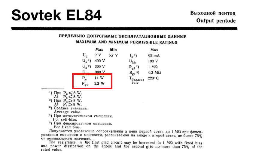

Close, but you need to subtract the cathode voltage from the screen grid voltage before multiplying by the current, for example:

What does the 1.51 watts indicate?
I've looked at the technical sheet of the Sovtek EL84, didn't see anything.
Datasheet here (P = power, a = anode, g2 = grid2)
Pg2, maximum screen grid power dissipation. You are way below 2.2W, as shown by @stonegreen above.Thank you kindly for the corrections. Trust me!

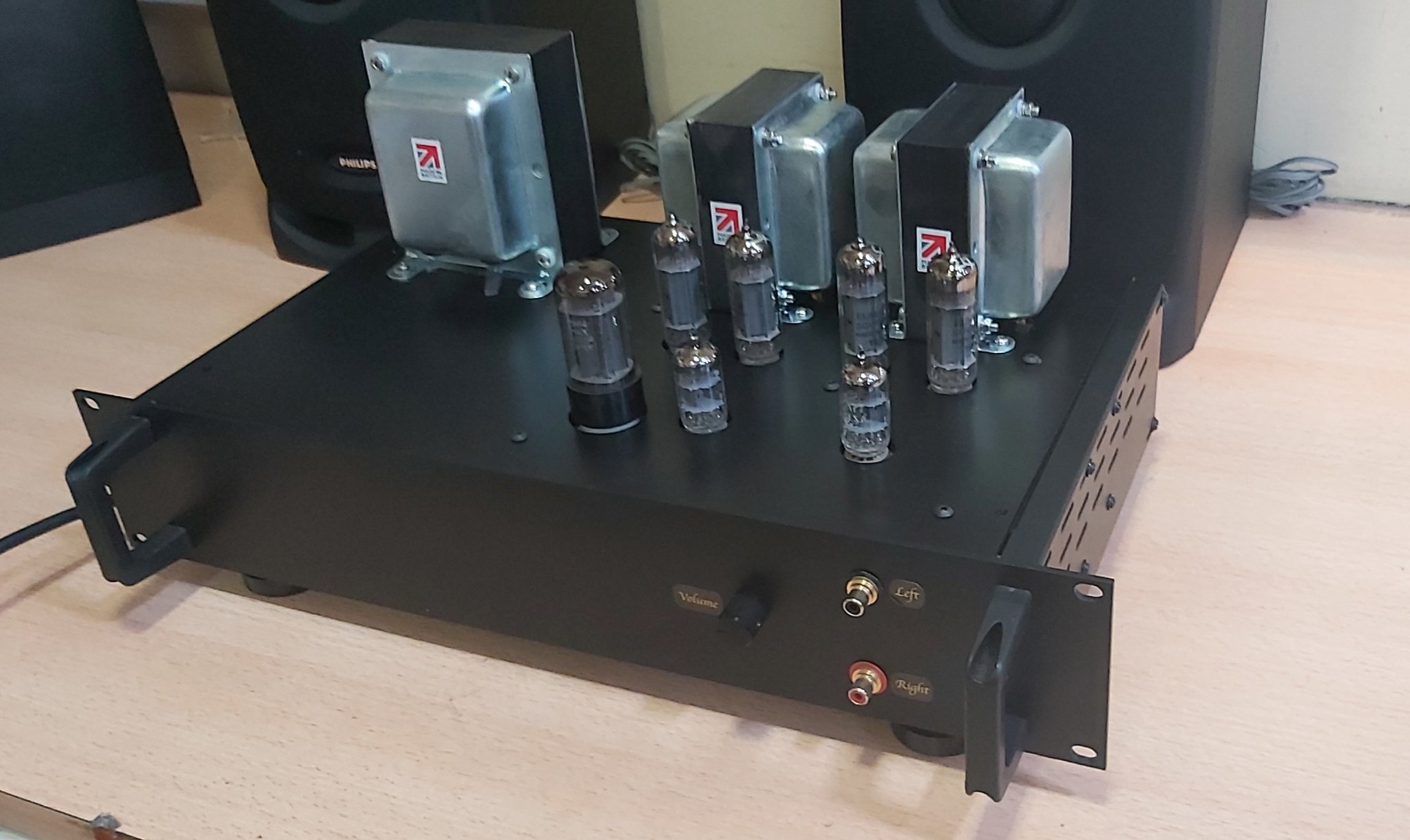

Images of my nearly complete build.
Just a few labels and tidying up of the inside cabling.
Otherwise, the sound is superb.
Many thanks to you all, for your patience and assistance.
