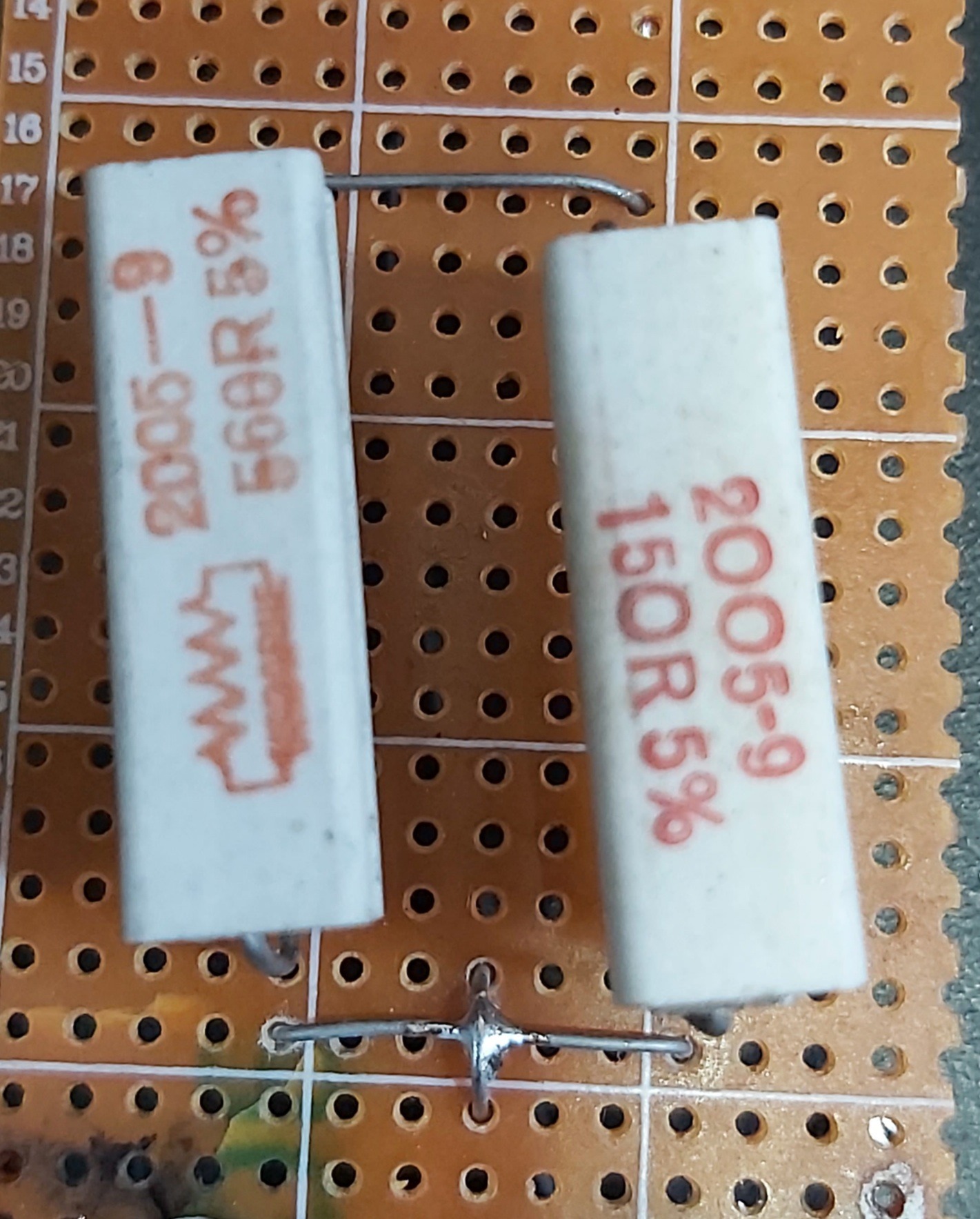

Not sure what wattage they are, but i'll get a 7W or even a 10W to be safe

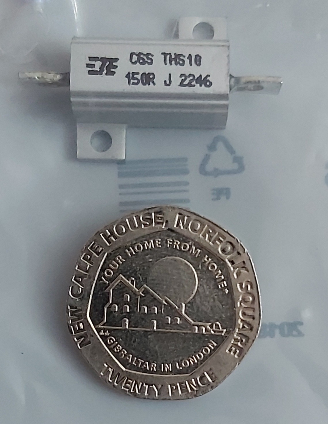

As for thoughts of getting higher wattage resistors to replace the resistors i've fitted from C.T. to ground (1x 150R + 1x 560R = 122R), i'll probably go for R.S. Components, chassis mount 10W, I can get them within a few days, unless there might be other thoughts?
Your composite resistor may already be of adequate power dissipation. I forgot the wattage of resistors you used to make up the 122 Ohms, but I think you used a 5 watt and a 3 watt resistor. Could you tell us what you used, please. Measure the voltage across the combined resistor and calculate the dissipation through each resistor and compare. (Calculations as in post #521)
Measured across the 122R, 25.8VAC
Thank you yet again Francois. I think i'm going to play safe maybe something like https://uk.rs-online.com/web/cps/
Chassis mounted resistors is a better solution, the heat being dissipated easier and i would probably do away with the fan too.

Thank you so much stonegreen, for the calculations, wattage not higher than 11.15 W, looking good i think and seeing your post 553 my Sovtek are rated at 14 W.
As for the damn R1 =122R you have kindly calculated the wattage at 5.5W, so choosing the chassis mounted types at 10W will solve all the problems.

If you are happy with this operating point (which is fine) go ahead with the 10 w resistor. If it were me I would go for a 100 Ohm resistor (10w) to raise the B+ just a few volts to about 320 Vdc.
Reactions: 1 user
I'll be making an R.S. order for the 10W's.
