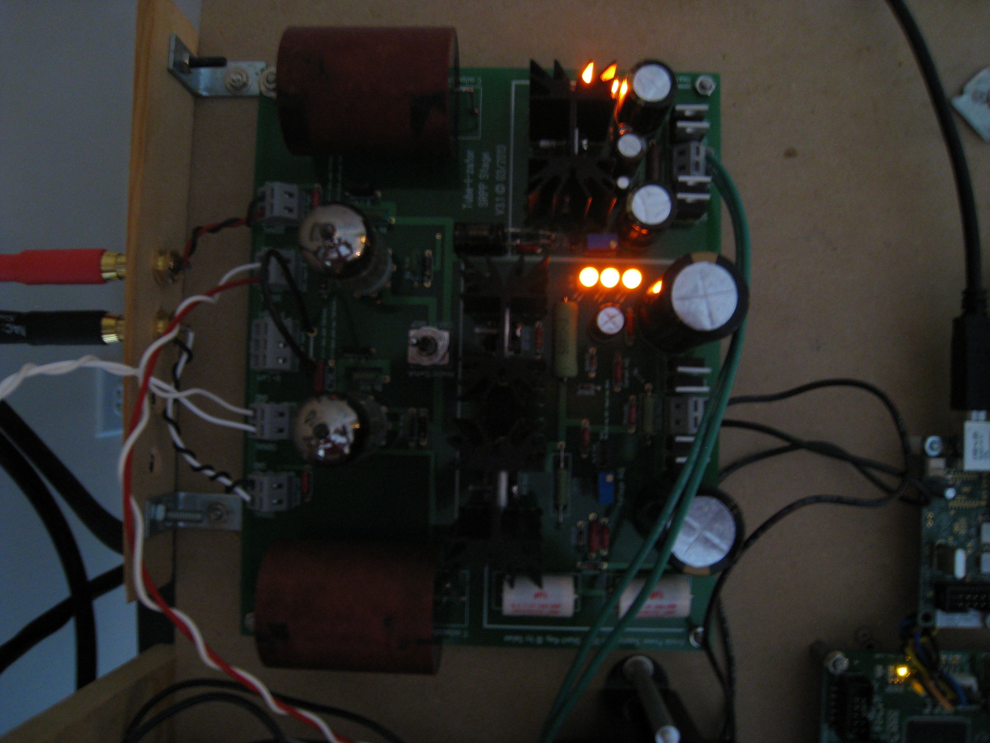

It's Alive!
The V3.1 Tubeizator is running...!
I used the Rhopoint resistors for both Rk and Ri/v. The sound is very good in the early stages. I will post more comments after 100 hours.
On the V2 Tubeizator, I used the "naked" resistors for both Rk and Ri/v. While the Vishay's are very good, for this application I much prefer the Rhopoint.
Thanks for a very good upgrade board Oliver.

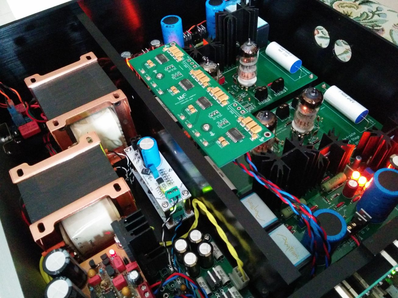

I've finished my DAC with tube-i-zator v3.1 and Ian's FIFO kit. However, the heatsink of IRF840 is quite hot (around 50-60 degree). I can't touch it over 1 sec. Is there anything wrong?
Input is AC150V and B+ output is DC150V. All components are brought from Mouser in accordance to BOM v3.1

I think two 6N2P cannot consume most of current from SSHV so IRF840 is very hot. I'd like to increase R21 to 100 or 120R, so output current can decrease to 16/20mA. It may be better than before.
