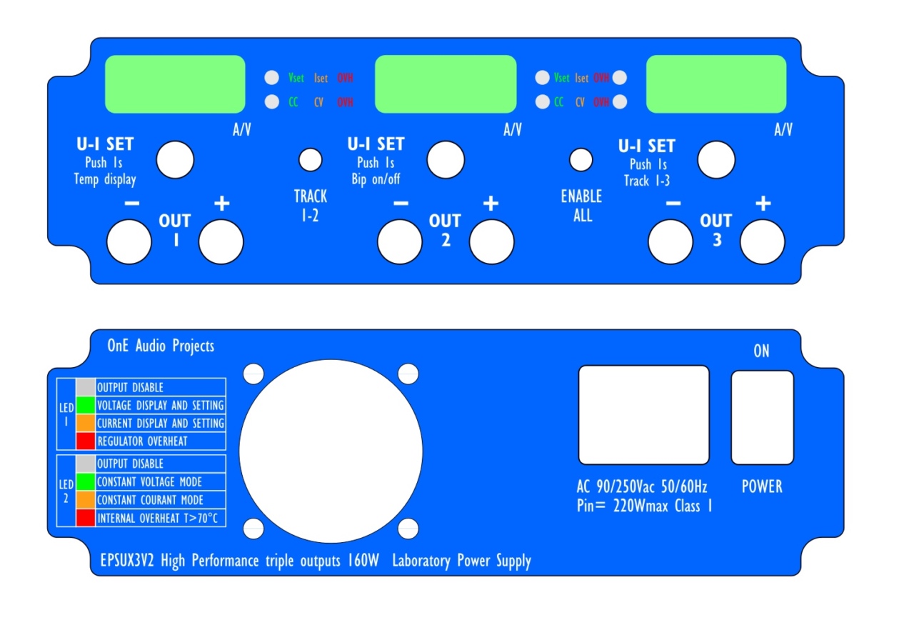

First, finish the front panels Lexans design, now near to be ready to send
for manufacturing. I hope to send them them next week (that would be a very nice Christmas gift for me !).
The lexans will look like this :

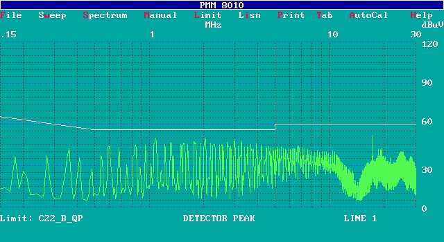

Second, i have made also some EMC testing, in particular conducted emission on power cord.
The PSU pass successfully class B level (the most severe level).
To do that, i've need to add a small shielding screen using a piece of PCB to avoid coupling between
PFC inductor and the input main connector wires.
The result below, at full load (3x18V-3A // Po= 160W) on Line 1.
