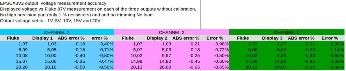

Calibration of the measured voltage is needed. In a perfect world, the ADC will return 100 for 1 volt. This because
(2^12 / Vref) * (R39/(R39+R38||R33)) = (4096/4.096)*(1000/(1000+9000))=100
But Vref can be in range 4,055-4,137 according to the datasheet. And the resistors have 1% tolerance. So the worst case upwards is
(4096/4,055)*(1010/(1010+8910))=102,84
In other words, you can have a +/- 2,84% error of measured voltage. If you have for example an actual value of 20V, this may read 20,56V on the display. ok, this will very rarely happen, but it can happen!
You can fix this by adding a trim-pot between R39 and R33, but this is not optimal. Best is to have calibration. The error is linear so you only need to do one measurment.

So, now about calibration, your calculations are right but your conclusion is too fast.
In real world, the error will reach that value.
In my own prototype, and without any specific precaution the error are resume in table below :
The error is only consistent when voltage become low (1V) but even 4% error at 1V output (40 mV!) is not a concern for most users.
So, there is many ways to improve actual accuracy.

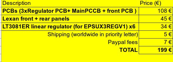

I work a lot these days to make a new precise price list for the group buy.
The prices I got are summarized below :
There is from now ten pre-ordering in the group-buy list,
so these prices are the better possible for a batch of ten.
I remind that the group buy is for building the EPSUX3V3 high performance power supply described in this thread.
As indicated in the previous table, it include all PCB(5) 4 layers with ENIG
gold finish, the professional front and rear Lexan panel (to make a very professional look to the PSU) and the six LT3081ER regulators needed.
You can look HERE how lexans panels looks like.

to a Lexan is that you have a fully drilled panel with beautiful cut (no need to machined the panels yourself).
So, i wait the end of next week to decide.
Best regards.
Frex
And thank you very much to all faithful DIYers wanting build the PSU.
For now, there is only 6 kits confirmed.
Some DIYers has not yet answered about their involvement in the group buy.
I've already spend much time to get price, and if in near delay (on week),
no ten kits are reached I will no continue the group buy.
In fact, even for 8 instead of 10 I would need to make another price estimation
and total price will increase again, and so buyers number will decrease again...
This is a no end circle...
If that happen, i will then only offer to orders bare PCB kit from me at lowest price possible.
But you will need to order all others parts by yourself.
LT3081 can be ordered directly from Linear or using Digikey and Farnell.
For the panels, a fully drilled and engraved front and rear panels will cost about 100€ from
FrontPanelExpress (like what i had done on the V1 of the PSU). The advantage compared
Best regards.
Frex
