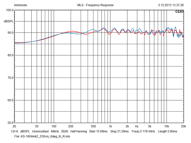

The speakers I looked at from that site (a few different types) have a flat response out past 10k, so I'm disinclined to read much into the subjective impressions. The crossover is important. A compression tweeter set up properly on an OS waveguide is deceptively natural, and consistently so, but not with that EQ.
I'm not sure what the problem is there - it's exceedingly well documented.
(..perhaps it's disbelief in the extended response of some of the horn's - that specifically use a BMS coaxial compression driver that extends past 20 kHz, and even has the manufacturers pdf on the driver linked at the top of the page in the "Introduction".)
Ex.
http://kimmosaunisto.net/Kirppis/bms_4590_4590p_t_data.pdf
vs.
"Frequency response
On-axis response; Left, Right
- measuring distance 230 cm
- time window 5.6 ms, no smoothing"
