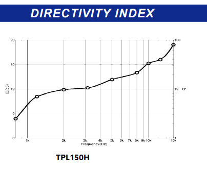

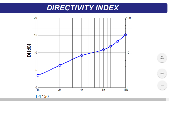

Some devices like Beyma's AMT TPL150 comes in two flavors, with a wave guide ( TPL150H) or without, direct radiator, TPL150.
Though their axial response can be equalized to the same flat response, and both devices have similar sensitivities, they do not sound the same, the direct radiator sounding more open and airy, while the H version sounds duller.
Maybe looking a their respective DI curves we can find the reason why...:rolleyes:
To high a DI too soon ( 1khz) and to high ( >10dbs) at 10khz and above, maybe is a sacrifice to coverage useful in PA use, but HIFI use requires imho more softer and progressive numbers, more similar to those recommended/used by Toole, Geddes, or found in products like pro monitors by Genelec.
Maybe for an outdor sono power response does not matter, but in a small room i think it does, and of the shelf pro wave guides usually show to excessively high DIs to be used for HIFI. An Econowave is NOT an M2 or a Suma...

I am talking about listening to the speaker in the room and it's radiation not some manufactures graph.
Room response relates to power response, which inversely relates to DI trend.
What you hear is indeed the DI, more exactly the contrast between axial response/direct sound and power response/reverberated sound.
Some defend the idea that both need to be similar, others that the room is the evil.
It's a free world, for the moment...:p
