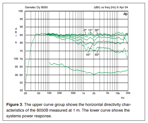

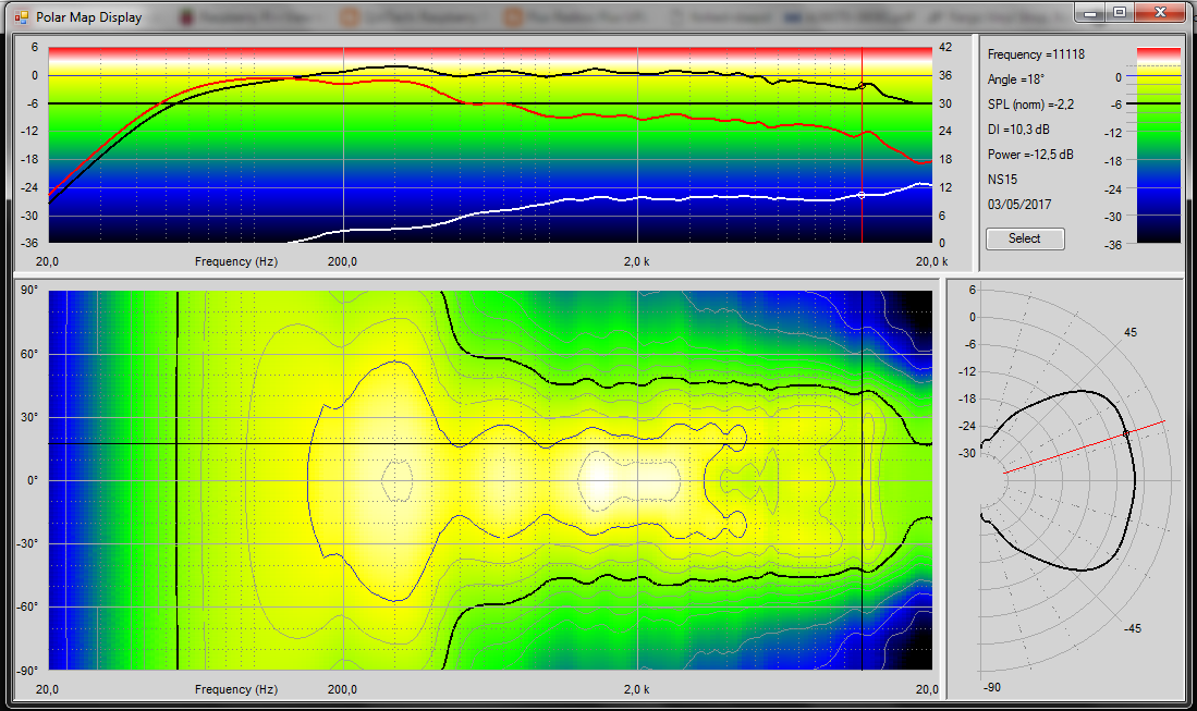

About the same as achieved by JBL M2, with a power response also falling less than 10dbs...
Geddes' NS15 seem do aim for slightly higher DI, maintaining similar power response...
But i prefer the curves of a Genelec monitor, though the SPL and power handling belong to different galaxies...
