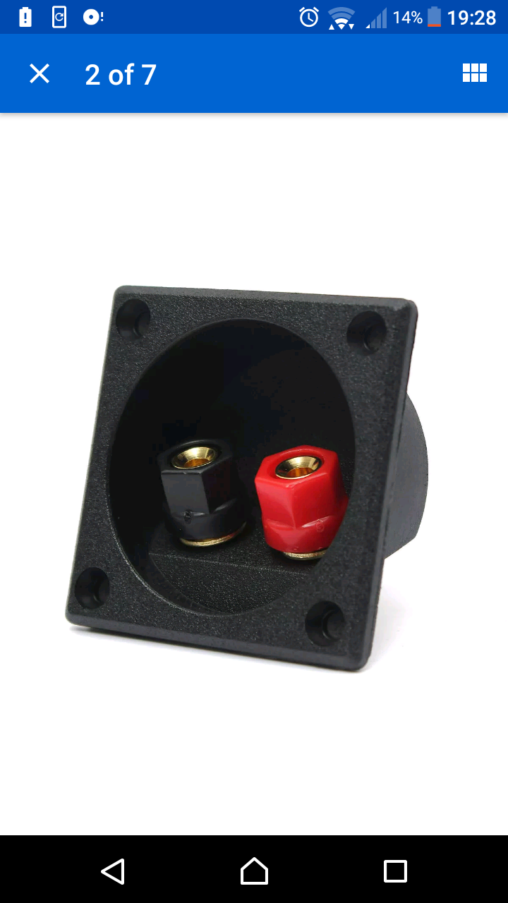

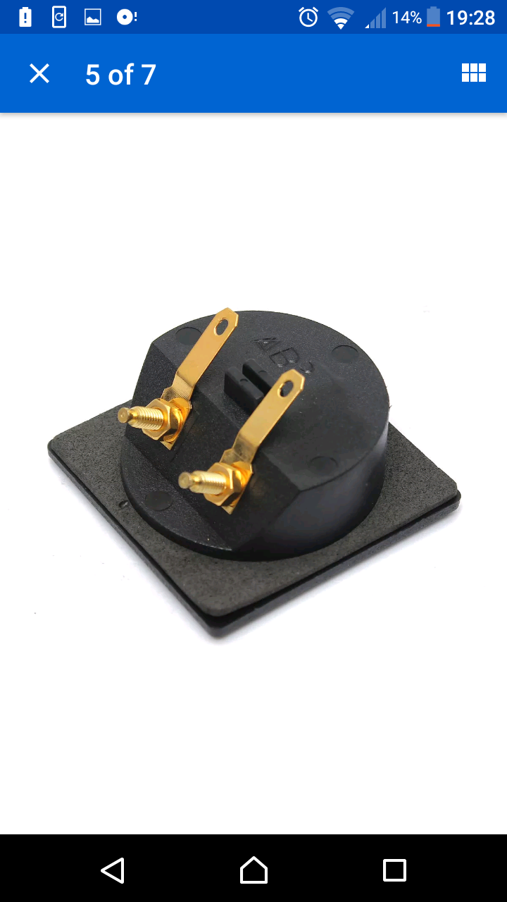

These are so cheap, I mean they look cheap. But you're suggestion is that this is better?
They are decidedly cheesy looking but to keep them cheap they use a minimum amount of metal which is what gives them their sonic advantage. The small terminal cup makes them a pain to hand tighten if you are using bare wire of spades but need a minimum size hole in the box. They are super for use with the pomona dual plugs.
And for the Trapezoids if i was to go separate posts you think these are the ones to go for? … eti-research-bp-50c-binding-post
If cost is no object & you want the best, yes, those would be my choice. I have successfully retrofitted the earlier generation into a terminal cup with standard spacing. A customer build with the similar concept WBT posts showed that ¾” spacing could not be done (he also supplied an exotic version of the CAT5 wiring we use).
dave
Ok when i see pictures and you explain it, i can see why. Pictures are very helpful for me! I generally like using banana plugs, but then i guess again too much metal, so spades would be ideal in this situation. Key thing learnt is minimum amount of metal and a solid quality cable.

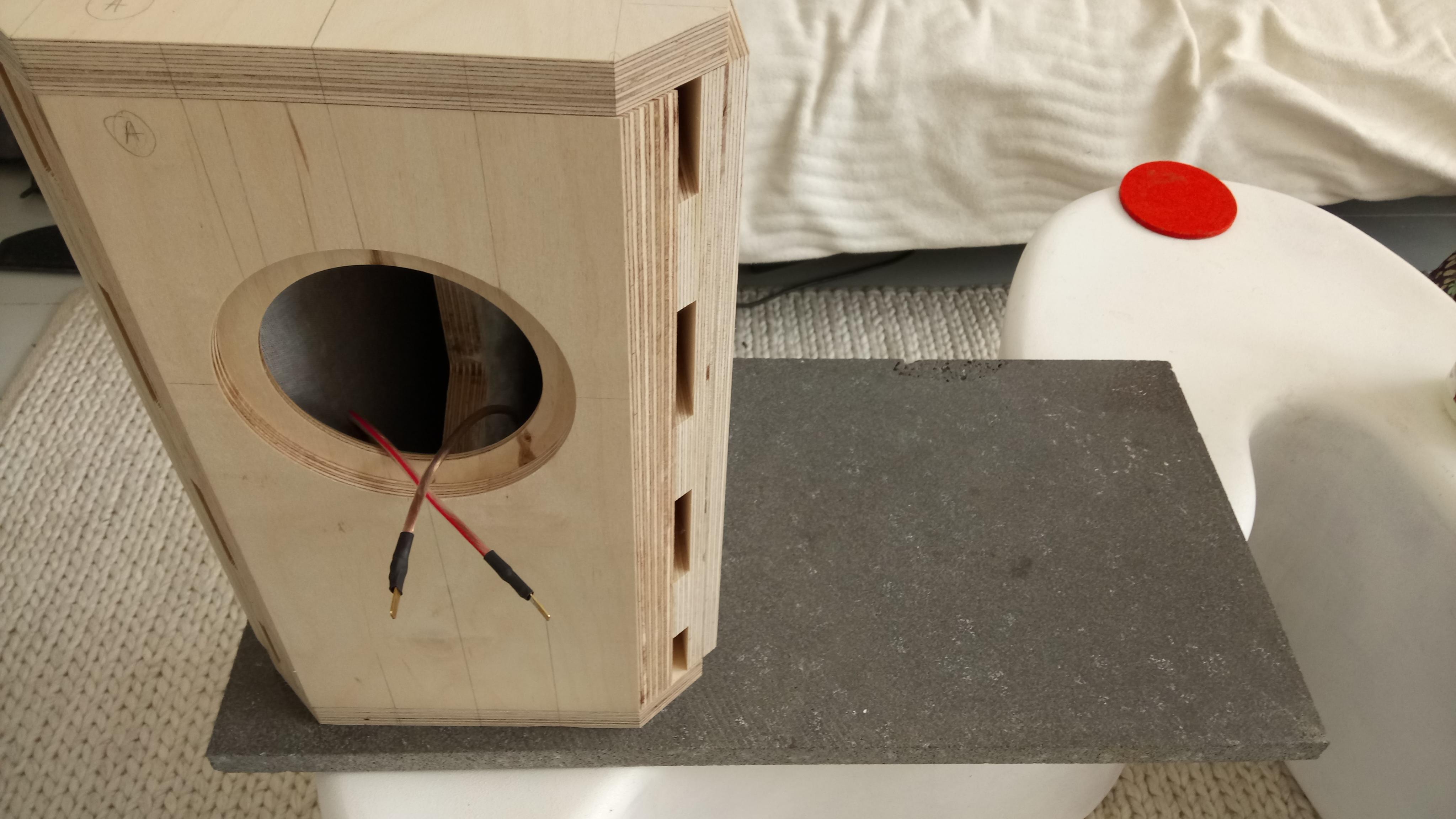

Stands, bases and spikes

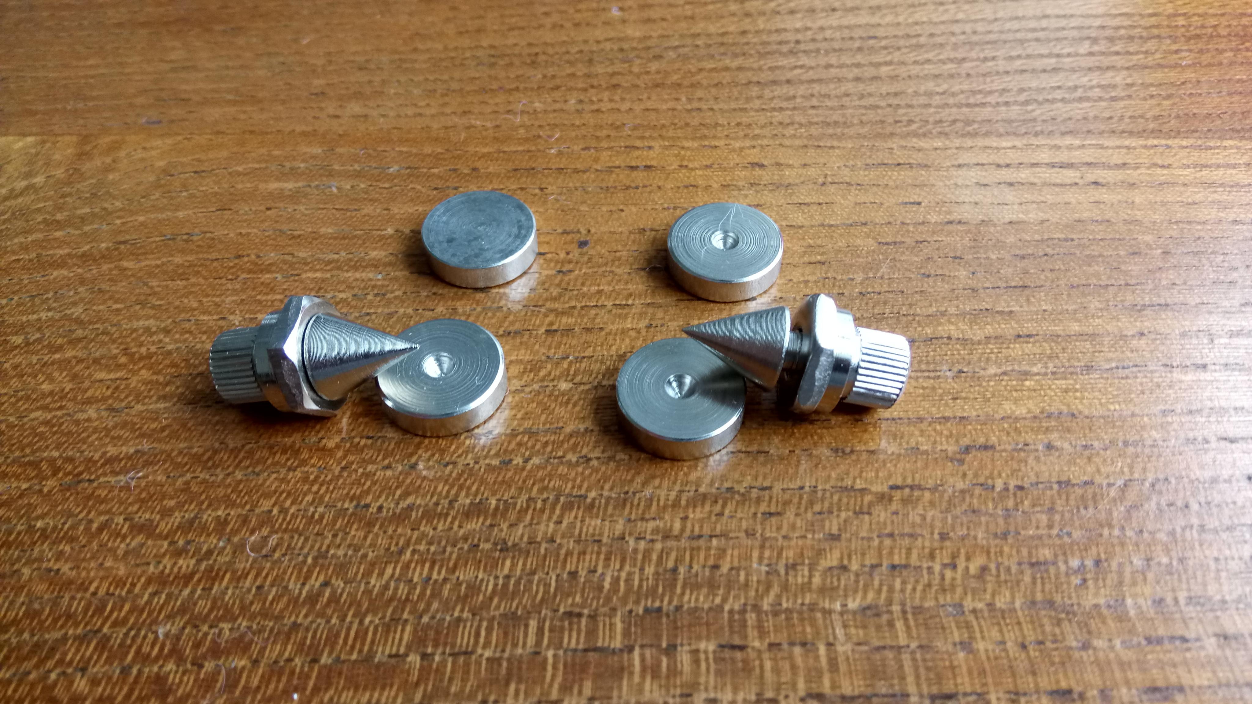

Whats your thoughts on using spikes? Was thinking of putting these on the bottom of the speaker bases? Or using a slab of granite on top of my speaker stands?
So spikes on the enclosure, then onto the slab of granite then on the stands?
I may then try them without the stands on my side cabinet.

OK, since you asked - I avoid spikes whenever possible, and use Feltac or similar PSA soft felt pad, or Blutack putty on smaller speakers, and felt or teflon furniture gliders on larger floorstanders or stands.
I've ruined far too many carpets and flooring surfaces with spikes - it's too easy for one of those protecting cups to go astray when moved, and I've frankly yet to hear a blind test proving their efficacy. Now, mass loading the hollow pipe / tube section of a metal stand is a different story.
just one old fart's opinion - YMMV
Agreed, spikes can be a nightmare, i was thinking of using something called SUGRU
Buy
| Sugru
if you have a chance check it out.

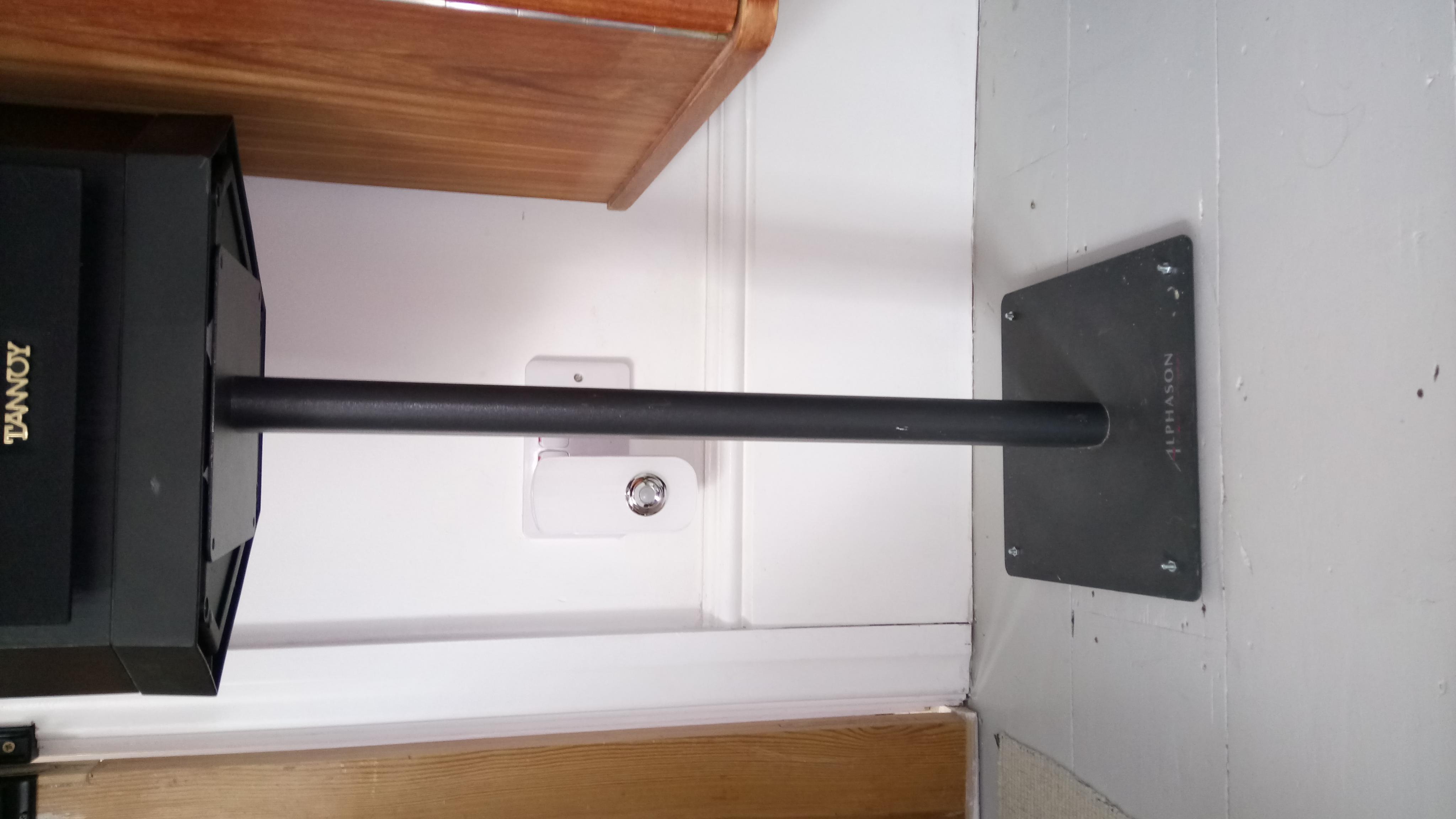

I filled the hollow pipes with sand in my stands, i was thinking adding a granite sheet on top with also help.
I can always put the spikes on and test it, considering the ends are flush mounted and i can remove them if necessary.
I highly regard both yours and Dave's opinions!
