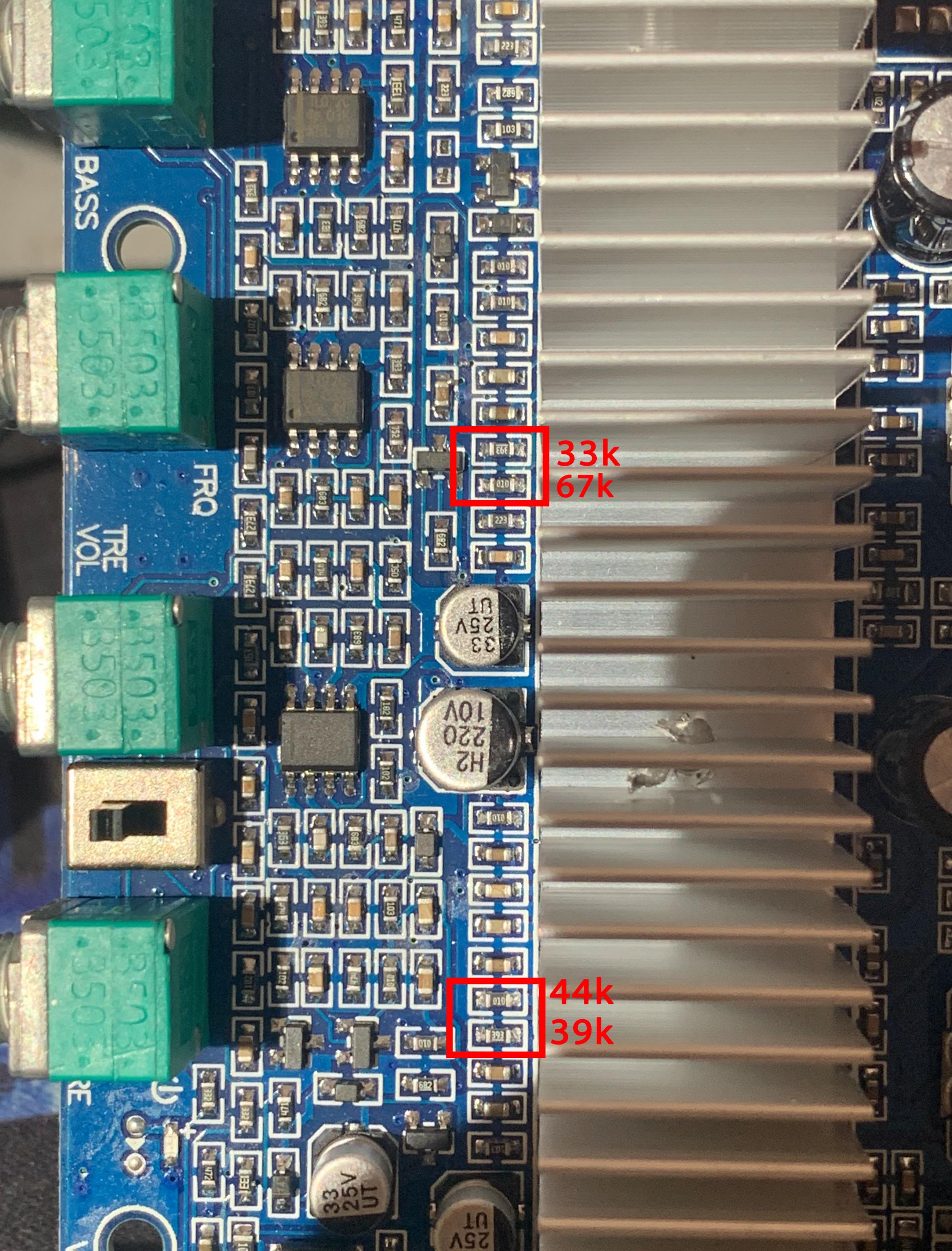

Yes, to me it seems the gain resistors are the ones I highlighted in the attached photo.
Hello Trileru, I have the exact same board, and was trying to adjust the gain. but I found out that the ones you highlighted on the photo have a value of 33k and 67k, and on the bottom chip (master?) they are 44k and 39k. Am I looking at the right resistors? because these values seem kind of odd to me.

I think the heatinsk is screwed down? If so then it wouldn't be complicated to take it out and measure continuity between those resistors and pins 7 and 8 of the audio chip. If they are connected then you can adjust them per datasheet.
edit: if the photo is of your actual board then it has the correct resistors for the 32dB gain setting. Based on the values written on the resistors in the photo.

If that's your actual photo then you don't need to take the heatsink off. You just replace the resistors.
You'd need to take the heatsink out to verify they are indeed connected to the gain pins of the chip. But most likely they are, since they have the correct values for 32dB setting. You should go to the 20dB setting.

Unfortunately thats the only measuring tool on my hand. So you're saying I should make sure that these resistors are indeed tied to the pins? It is my actual photo. I just dont want the trouble of going through an extra step
I think you can safely replace them directly.
Just make sure you correctly install them. If the upper chip is slave and the lower is master, then you replace the lower 39K resistor (393 code on it) with a 5.6K resistor. The lower 100K resistor you completely remove.
For the slave (upper chip) you replace the 100K resistor with 51K and the 39K resistor with 51K as well.
The only thing I don't understand is the smd code on the 100K resistor. Should have been 104. It's simpler to just remove it and measure it with DMM.

My apologies if this sounds stupid but none of the resistors I have marked measured 100k.
