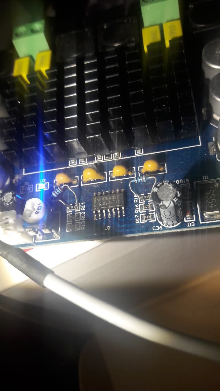

Hello, I just wanted to share a small hack to reduce the gain of a cheap chinese board with tl074 with minimal modification.
The tl074 use two opamp per channel, the first one in inverter configuration (with a gain of 10db on my board) the second one as buffer.
I added a 1k resistor in parallel with the 20k feedback resistor to lower the gain of the first opamp to -3db (nothing special in this value, I just happened to have two 1k resistor lying on my desk).
I hope this might help if you want to experiment, this modification is not as invasive as changing the resistors under the heat sink or removing the opamp.

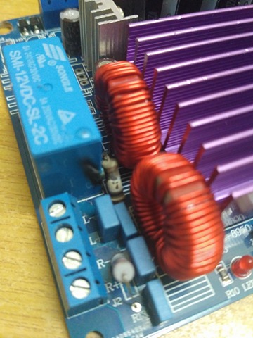

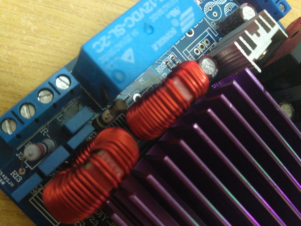

Hi guys, I designed a pcb with easyeda 2x tpa3116 2.1, assembled everything works perfectly but with 24v the inductors become hot after a few minutes... i thought that the inductors i chose are not suitable for tpa3116 as many people had the same problem and by changing the inductors the heat disappeared.
The inductors I am using are gods Eaton Dr125-100
Access to this page has been denied.
In your opinion, if you change them with Wurth the heat would disappear?
Use inductors rated for at least 7.5A before saturating, and with as low of a DCR as you can find within reason. CoilCraft, Wurth, Bourns, etc are good brands. The inductors should not get hot. Use the bootstrap snubber mod - treat might reduce the temps as well by preventing oscillation or ringing in the inductor. Also important to use a high quality output filter cap. Vishay, Wima, TDK, film cap rated at least 100v will work better.
